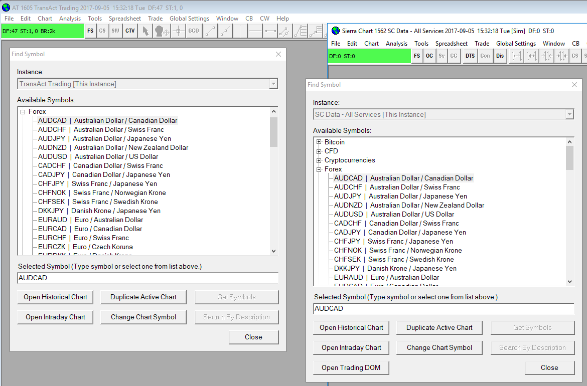

I am using 2 Sierrachart instances. One through TransAct and a second one in order to have your realtime Forex and CFD feed (SC Data - All Services). I have always been using the method of referencing remote chart data files in order to overlay chart symbols in and from both instances. This has always worked fine for me.
I just bought a new computer and have been trying to setup everything like it was before only that now I am unable to choose between the two instances when selecting symbols. The 'Instance:' dropdown menu in 'Find Symbol' is greyed out and I can no longer use symbols from for example the SC-Data feed instance in the TransAct instance. Upon searching the forums and the documentation pages I found out that the above method of referencing remote chart data files is no longer supported and that one should dig his teeth into using DTC.

imageinstances - greyed out.png / V - Attached On 2017-09-05 20:43:10 UTC - Size: 48.01 KB - 511 views

This section here explains what to do about the Instance setting not listing any other instances:
https://www.sierrachart.com/index.php?page=doc/FileMenu.html#SharingDataAndRunningSierraChartWithAdministratorLevelAccess
However, there is a much better way to do this. Since you have your own Sierra Chart account, use a single copy of Sierra Chart for TransAct and the Forex and CFD data. Set it to use TransAct:
https://www.sierrachart.com/index.php?page=doc/TransAct.php#SetupInstructions
You can also access the Forex and CFD symbols directly through the File >> Find Symbol window.

I can confirm Instances listing now working properly again after launching the charts with admin privileges.
Tried your point 2 suggestion to use a single copy of SC for TransAct and Forex/CFD and that's working great, going to use this method from now on out, thanks very much.
Finally, I did also test point 3 and updating the symbol settings as per instructions did not fix it, all forex and cfd symbol still come up as 'unknown' , but since from here on out I'll be using the above single copy of SC suggestion I no longer need a fix for this.
