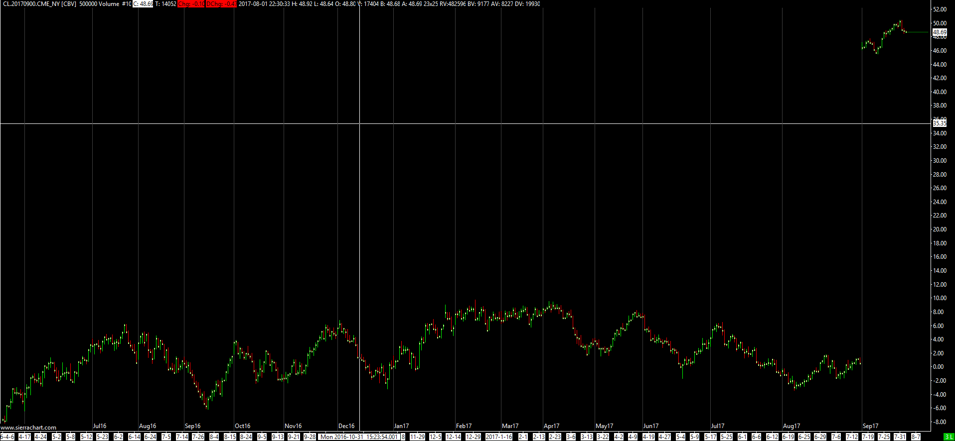

User579342 - Posts: 16
I am using CTS T4 Fix and everytime I pull up a chart of CL I have gaps in my data specifically data 7-17 jumps from .46 cents to $47.
I dont have these issues on any other contracts.
I am using Sept Crude
CL.20170900.CME_NY
[2017-08-02 01:59:35]
Scroll the chart to where you see this and provide an image of the chart following these instructions:
[2017-08-02 02:32:33]
Here you go

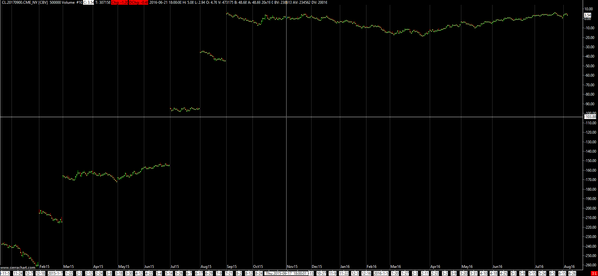

I also noticed that some gaps are also showing up 2015 data
http://www.sierrachart.com/image.php?Image=1501641042399.png
http://www.sierrachart.com/image.php?Image=1501641134485.png
[2017-08-02 05:23:31]
You need to fully re-download the data for all contract months following the instructions here:
https://www.sierrachart.com/index.php?page=doc/ContinuousFuturesContractCharts.html#ReDownloading
This appears to be due to having existing data with a different decimal point position from a different Data service.
Date Time Of Last Edit: 2017-08-02 05:23:43
