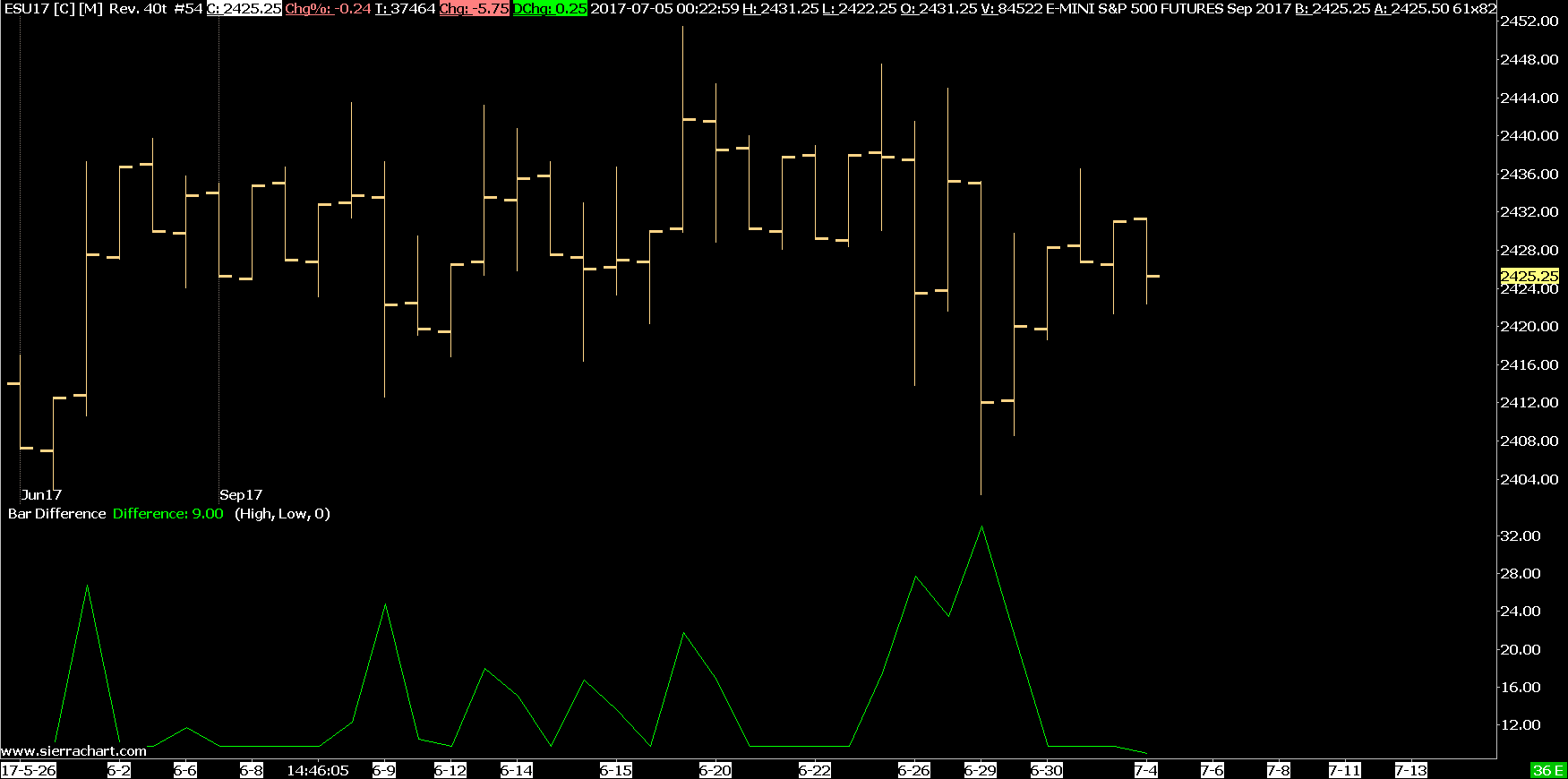

[2017-07-05 04:23:13]
A 40 tick reversal bar can be a length of 39 ticks.
We have tested a 40 tick reversal bar in ES futures and we do not observe what you are describing:
the last/close price of a down bar will be the same as the open price of the following bar.
the size of the bars will also be wrong - in this case, the distance from the high of the down bar to the open of the next bar was only 38 ticks -
Follow through the instructions here including re-downloading the data in the chart:
Here is the test chart:
http://www.sierrachart.com/image.php?Image=1499228588950.png

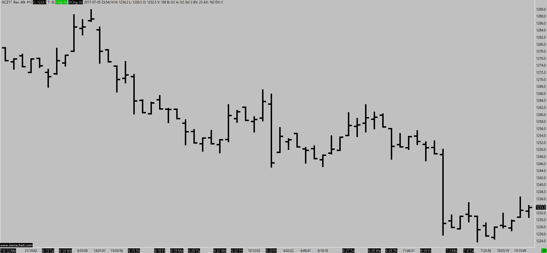

I think I spoke too soon as the issue has come up again but this time on the Gold Dec 17 contract (GCZ17)
What I have noticed is that the first time I load a chart, particularly of a new market, the bars are always wrong. On the continuous contract, if I follow the steps for re-downloading the continuous contract futures data, that chart is fixed.
I tried reloading and downloading the data again for the Dec 17 contract but there are still errors in the chart. There are a few gaps in the chart and the difference between the last price of a bar and the open price of the next bar is sometimes more than 10 ticks as you can see in the image below. I am using the SC data feed for my free trial.
http://www.sierrachart.com/image.php?Image=1499314528718.png
I trialled SC about 12 months ago, and while I love the program, I had the same issue with the reversal bars back then so I don't know what the issue is as it's frustrating because it's preventing me from switching over to SC as I can't trust the bars I see on the chart. I don't know what I'm doing wrong.

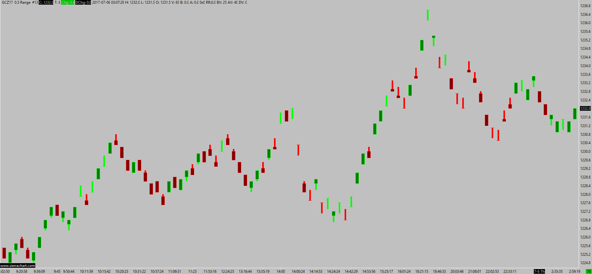

[2017-07-06 07:28:09]
User108836 - Posts: 7
Sorry I was not implying there was anything wrong with the range or reversal bars in SC - obviously they work fine but I can't figure out why they don't look right on MY chart. The reversal bars are a little different than what I'm used to but I can get a programmer to develop them custom for me so that's not an issue. The only issue is the weird data on my charts.
I attached an image of what my 5 range GC Dec 17 chart looks like - by errors I meant huge gaps in price. Some of those gaps are 10 ticks or more which even for GC is unusual. In Ninjatrader, that same time period has absolutely no gaps on the chart so clearly there is something wrong with the data on my installation of SC.
I have followed all the suggestions posted in this thread but I can't seem to find a permanent solution. Do you have any other ideas or solutions that can fix my charts as I really want to use SC? It has everything I need - this is the only issue I have with SC.
http://www.sierrachart.com/image.php?Image=1499325875521.png
[2017-07-06 07:35:04]
When we answered previously, we did not look at the exact gap amounts. But we know that some small amounts are certainly normal within a tick or two. We can see they are much greater than that, and it is obvious why the problem exists.
You are looking at a noncontinuous December futures chart looking back to June data. Obviously there is very little trading and lots of price gaps at that time.
