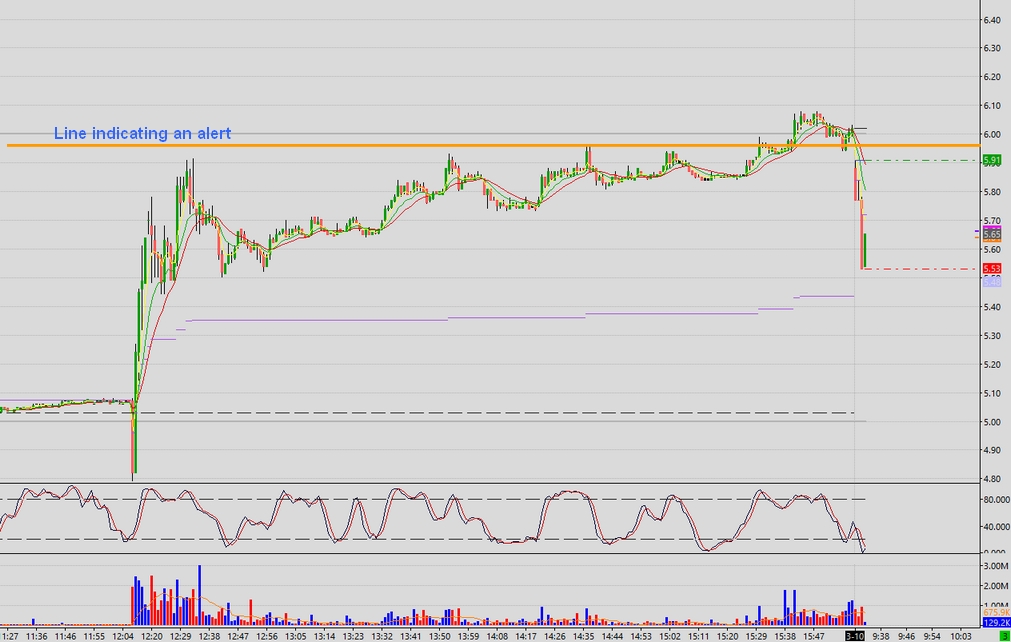

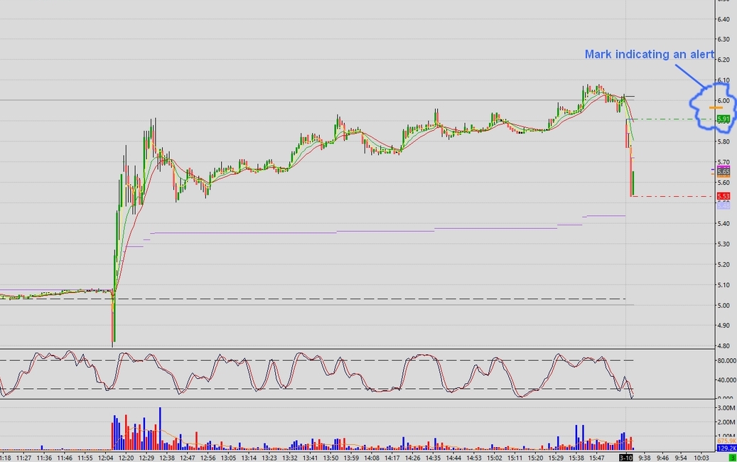

I don t know if it possible, when I add an alert with Symbol alert I would like to get on the chart a line indicating the price or a little mark next to the price label as shown on the attached picture.
I set a lot of Symbol Alert for many symbols and for a same symbol I can get 10-20 Symbol alert. It is pretty hard to follow all my alerts with Alert manager. A line or a small mark on a chart would be more effective and practicable than alert manager.
Ps: I use Symbol alert and not horizontal line with an alert because I don t want to have an chart for each symbol I set an alert.

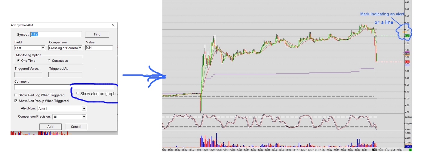

I tried it but it is similar to set an alert with an horizontal line having an alert: each symbol has to get an open chart which it is highly inconvenient.
A sensibble solution would be to add option to get a mark/line with alert set with Symbol Alert
I know you have a lot of work, but could it be possible to consider adding this feature?
