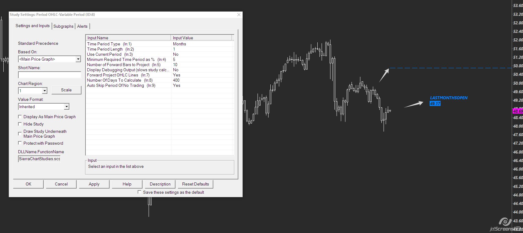

so its pretty clear nothing was fixed , it even looks worse , not sure why this is such a hard issue to figure out
like i said before , in this picture i have prior month open plotted but its plotted the line on the prior month and the label and price at current months open
this is happening at end of the month and end of the week and end of the day , rest of the time its fine , so something is def wrong with way its calculating the last day or hour on the chart
as you can see i have posted a weekly chart with prior weeks ohlc and its has been plotting fine all week , but on friday it will start plotting labels on fridays ohlc instead of the prior week
please address this as this is a simple tool and a must for trading

You cannot use this input: Forward Project OHLC Lines.
It does not do what you expect it does.
We added a new Subgraph Draw Style which draws a line and extends to the the end of the chart window. This is in the latest prerelease.

[2017-06-06 16:55:29]
The problem is you are not following our instructions. Do not use Forward Project OHLC Lines. Simply do not use it! it does not work as you expect.
It is well documented but you are disregarding the documentation.
This is incredibly simple to understand.
Instead you want to use the Line Extend to Edge Subgraph Draw Style. This is a new Draw Style in the latest prerelease.
