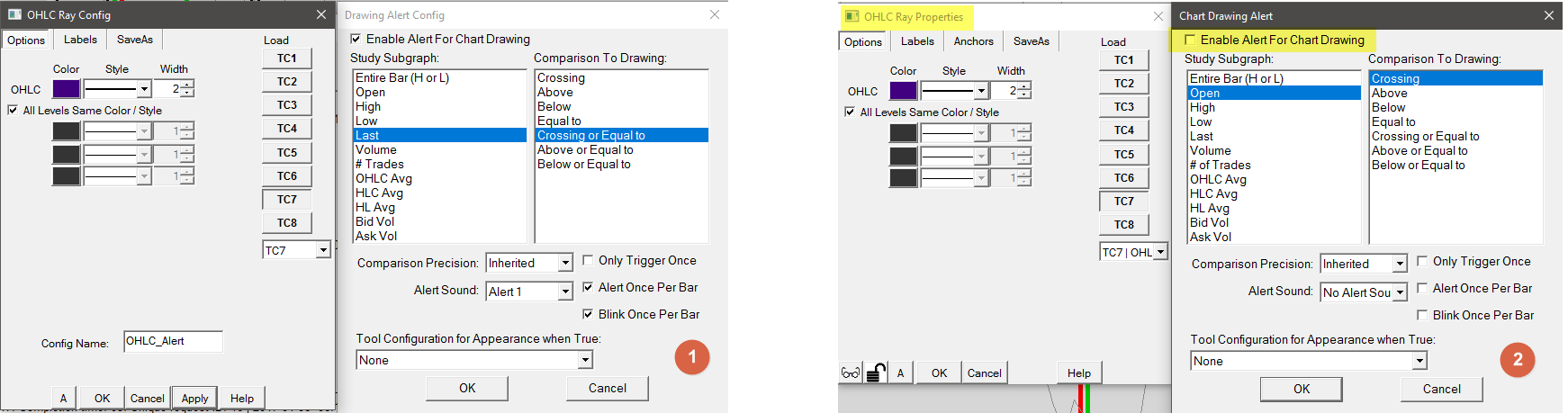

I'd like to configure a line like OHLC Ray with Alert but later in use it does not work as you can see in the attached file. I saved my configuration in TC7
Isn't it possible or what I have to do?

I'd like to come back to the "Alert Option".
I do not know how it works. I've tried a tousend time but no result that works.
My intention is to configure a line with alert sound on crossing. If I save it on "TC1" it works perfectly but if I#d like to save it on i.e. "TC7" it do not.

nicktrader - Posts: 817
It does not work. Saving the config (with alert) i.e. under TC7 is not the problem.
After placing a ray (for example) I am doing a doubleclick to change the properties to TC7. But than it does not work. If I save the configuration (with alert) under TC1 it works because I do not have to change anything.
[2017-04-09 21:11:42]
Once again step 8 here explains the reason for this and provides a solution:
Chart Drawing Tools: Configuring a Default Chart Drawing Alert Condition
You cannot apply a saved Alert Condition configuration through the Chart Drawing Properties window.
