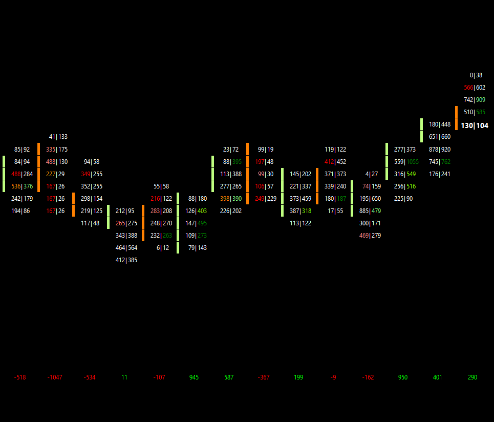

I am testing Sierra Charts, because it seems to fit very well for me. But I am an enthusiast of footprint charts, and using Numbers Bars study I get strange data. In Market Delta or Multicharts footprints, most of the bars has a 0 in bid at the high of the bar, and a 0 in ask at the low. Bars with numbers different from 0 in the high or low are just a few, and in fact, they have a name: unfinished auction, which give trading oportunities.
But with Numbers Bars, the equivalent to footprint, almost every bar has bid and ask different from 0 in both high and low of the bar. I attach an image.
Probably I am doing something wrong, but I need to know how to avoid it and have actual unfinished auction footpring bars.
Also, I would know which study have I to use to have colored bars instead of numbers in the bottom of the chart of the screen capture. It shows the net balance of the bar (sell market orders - buy market orders). I want to draw a bar, not a number. Which study need I to use?
imageScreenshot_1.png / V - Attached On 2017-03-23 19:50:27 UTC - Size: 26.49 KB - 968 views

Most likely the problem is you do not have Sierra Chart set for a tick by tick data configuration. Refer to:

[2017-03-23 21:59:12]
fjgaspar - Posts: 62
Thank you for the answer. The question regarding to the Bid Volume vs Ask Volume, yes, that's what I looked for.
The 'non zero' at high and low of the Number bars, still is happening. I have set the tick by tick configuration, disconnected and connected again. Test with different configurations (5 min chart, 100 tick chart, 4 tick range chart). Nothing changes: most bars have unfinished auction.
I am using a CQG demo account provided by AMP. And I have configured it under CQG WebApi. If I try with CQG FIX, doesn't connects.
[2017-03-23 22:47:50]
Did you re-download the data as the instructions explain? Apparently not.

[2017-03-24 14:35:23]
I have done as you talked and now it appears to look ok.
