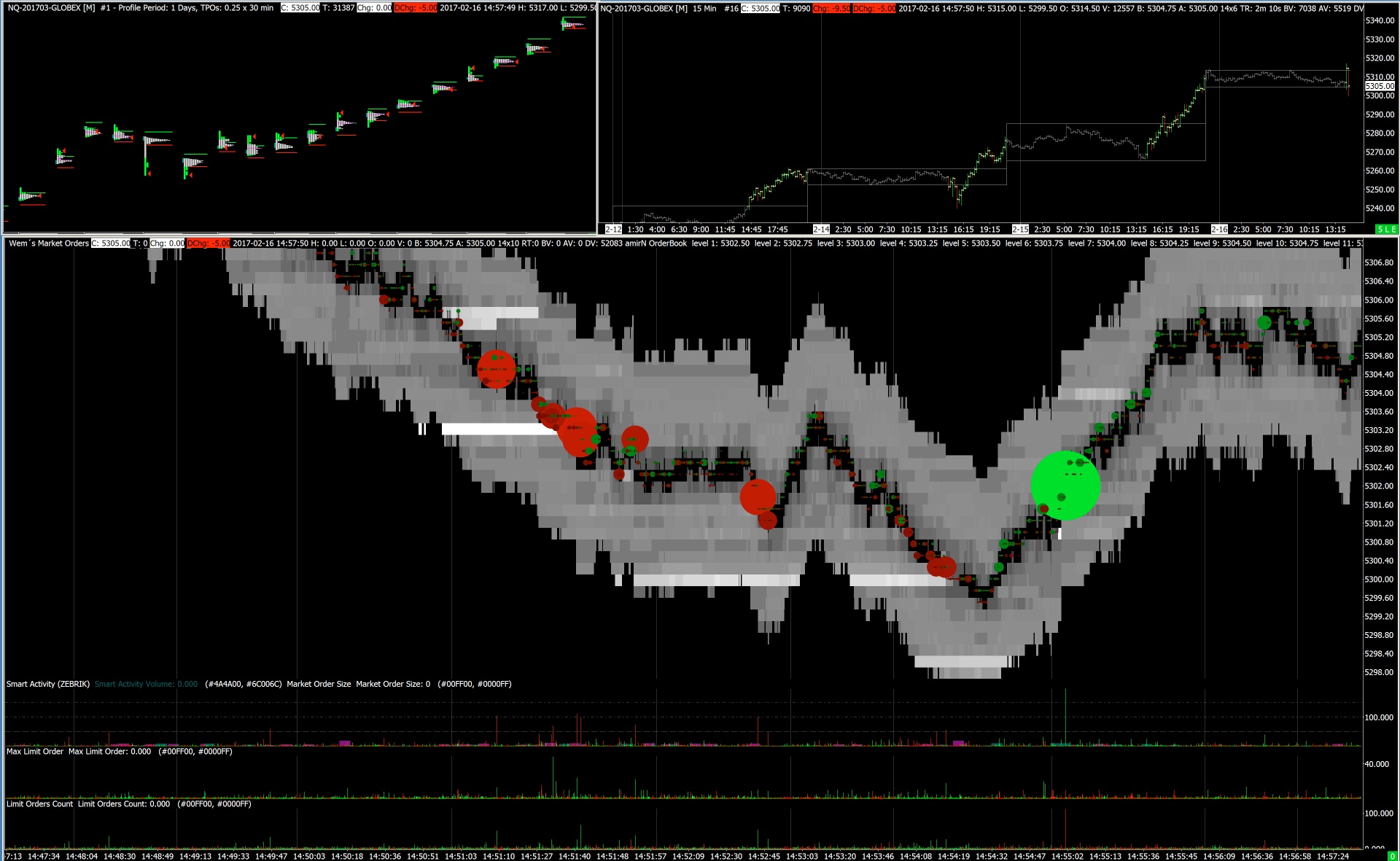

zippyzip - Posts: 310
something like these to represent size
Private File

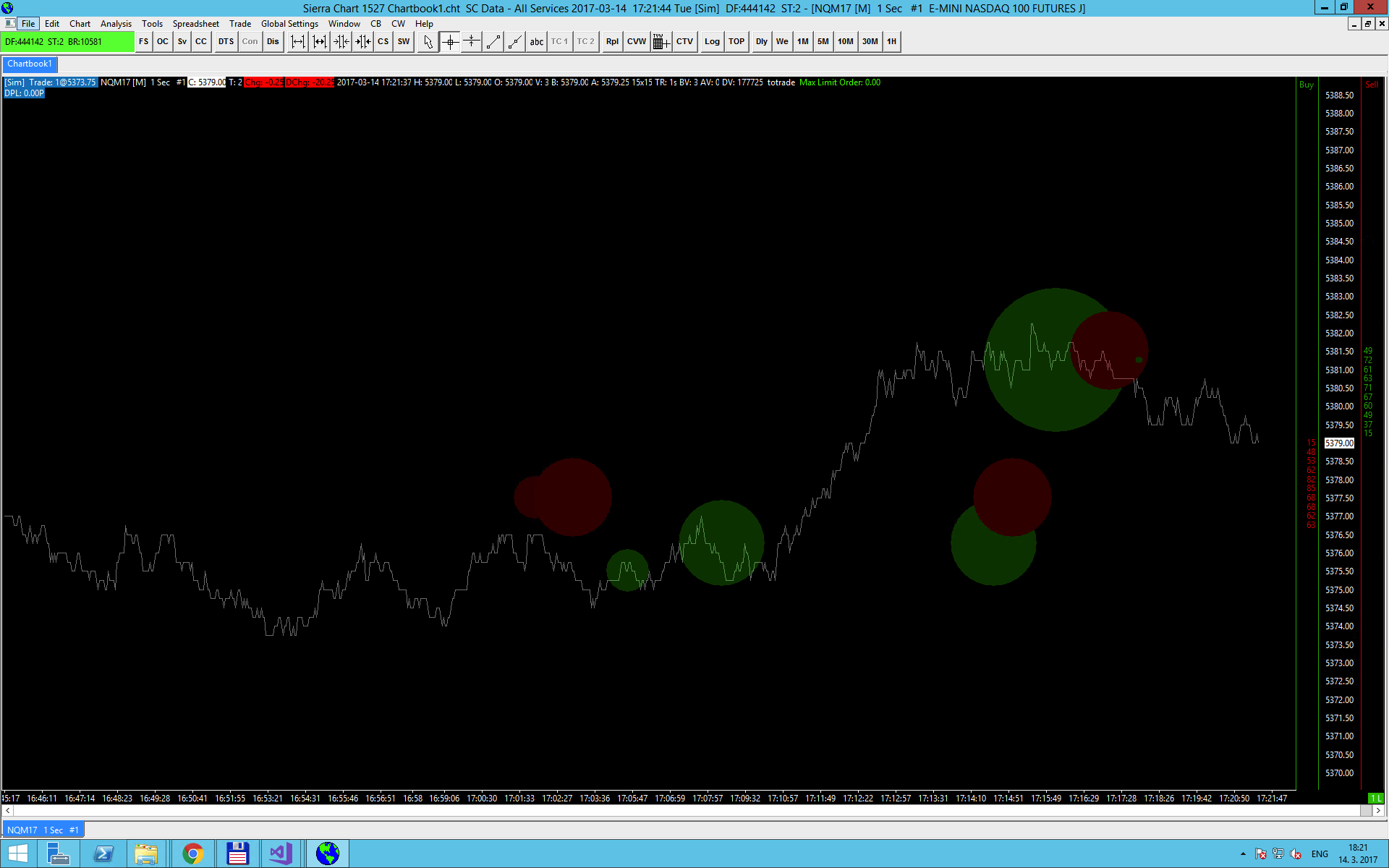

User64410 - Posts: 14
im curious about transparent circle. is possible to change transparency level?
Now, I can change trans circle diameter for sc.Index using:
sc.SubGraph[0].Arrays[0][sc.Index] = DataArray[1];
Iam missing information about contours settings like color and width, except transparency level. It also looks like two transparent circles are still overlapped with no transparency between them.
Now a have to use all available sc.Subraphs to achieve my goals. I would like to use trans circle in future but i see two problems:
1. I will lose range of colors shade because of fixed transparency.
2. problem is that huge circle with sc.index 100 will hide smaller circle at sc.index 99 and it does not make sense.
Is now (am i missing some information?) or it will be possible to solve this in future ?

[2017-03-14 20:18:02]
Marek F - Posts: 254
I also need different transparency of circles on respective bar, something like Subgraph extra array that control its size.
It is also significant problem for me.
[2017-03-19 08:57:44]
There is only one transparency level setting and how that is controlled is explained here:
Chart Studies: Transparent Circle Variable Size (ACSIL: DRAWSTYLE_TRANSPARENT_CIRCLE_VARIABLE_SIZE)
We could use another Extra Array to support the transparency level for the circles at each chart bar.
It is not clear what you are looking for when you say this:
We assume you know how to control the color and width of the circles?
The color can be controlled through:
ACSIL Interface Members - sc.Subgraph Array: sc.Subgraph[].DataColor[]
