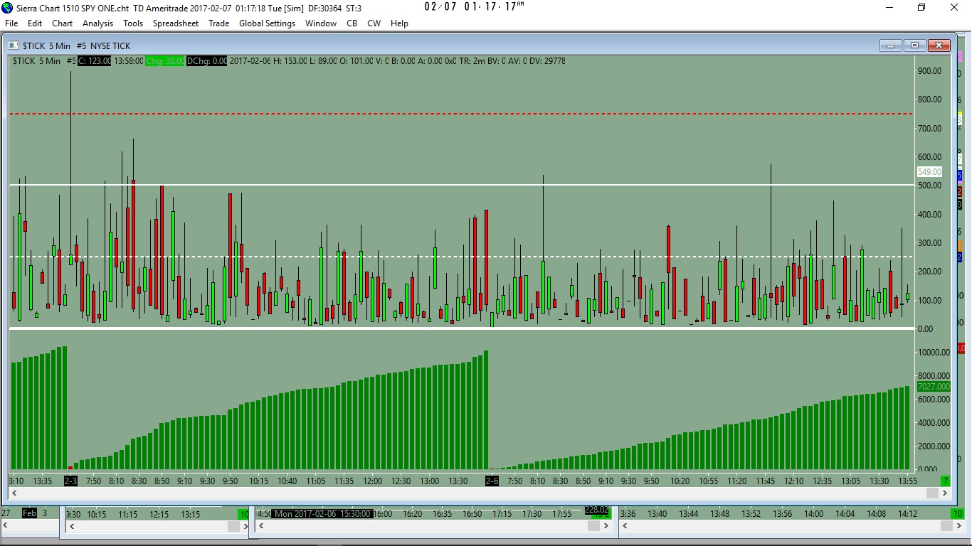

sparky36 - Posts: 21
I used $TICK using TDameritrade datafeed and it pulled in data. See chart.
imageSierra Support 5m $TICK using TDameritrade data feed.jpg / V - Attached On 2017-02-06 03:33:13 UTC - Size: 285.72 KB - 1008 views
[2017-02-06 08:33:02]
It is clear from the screenshot that you are not using the TD Ameritrade data feed and instead accessing the Barchart $TICK data. You need to follow through the instructions here:
https://www.sierrachart.com/index.php?page=doc/AmeriTrade.php#SetupInstructions
However, we have no idea what the TD Ameritrade Market statistic TICK symbol is. We would tend to think you are not going to be successful getting the data you expect.
Date Time Of Last Edit: 2017-02-06 08:33:25

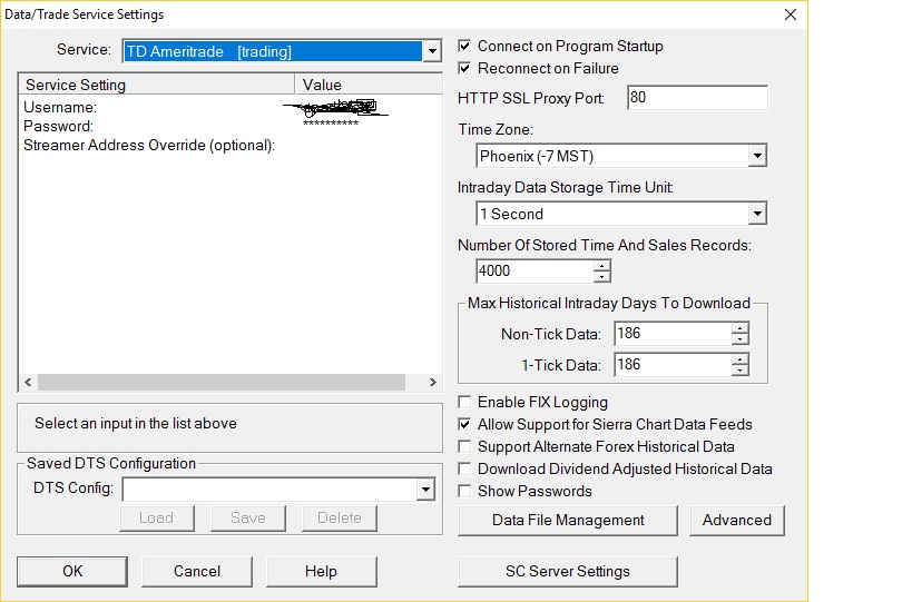

Hi, Thanks for the input. The chart I sent you of the $TICK (that is the actual symbol used in TDameritrade TOS) was being pulled from TDameritrade as per your instructions. It might appear that its from Barchart $TICK data but I can assure you that my sierra chart is set to TD Ameritrade. So if my data is set to TD Ameritrade, why am I pulling in Barchart $TICK data? Any Ideas? Thanks again!
imageTD Ameritrade Service Settings.jpg / V - Attached On 2017-02-07 06:52:57 UTC - Size: 118.61 KB - 629 views
[2017-02-07 07:46:26]
To be sure the data is coming from TD Ameritrade goto that chart and select Edit >>Delete All Data and Download.
We could tell it was coming from the Barchart data based upon the title bar in this screenshot which shows the service being used:
https://www.sierrachart.com/Download.php?Folder=SupportBoard&download=10674

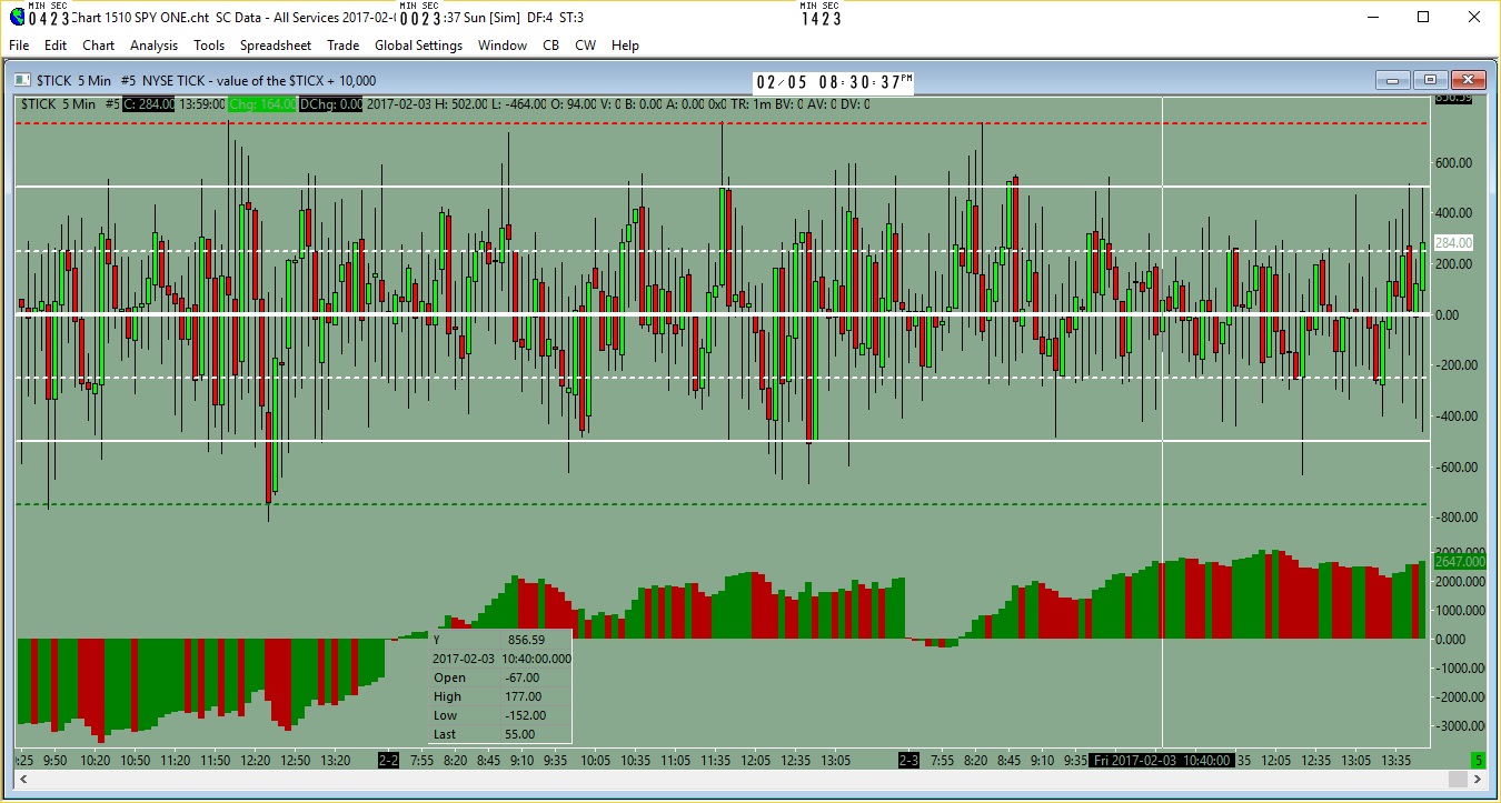

Ok, did what you asked and I it downloaded something but it doesnt go below the zero line. See pic. Any way we can fix this?
image5m $TICK using TDameritrade after deleting and redownloading.jpg / V - Attached On 2017-02-07 08:18:42 UTC - Size: 263.99 KB - 609 views
[2017-02-07 09:00:00]
Interesting you received the data and we did not.
Use the Intraday data editor and see if you see any negative values:
Intraday Data Editor
We checked and negative values are not filtered out. So we do not know how we can help with this.
As a matter of policy we are not going to provide support for other market statistics. Besides, we cannot do anything in this particular case.
[2017-02-07 09:44:25]
DabbaDo - Posts: 150
Here's a note from NinjaTrader last March. I eventually gave up on TD Ameritrade data.
"After speaking with development this is currently a limitation with TD Ameritrade historical data servers not sending negative values. The only work around at this time would be to connect to a provider that does not have this limitation."
