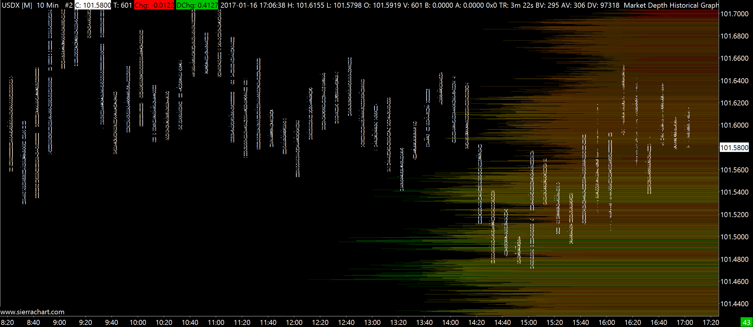

I have been using the foodprint indicator for my graph but unfortunately the numbers displayed are too small to read (see attached). Any tips?

It does not make sense to use the Numbers Bars study on that symbol.
There is not going to be any logical information provided.
Nevertheless, you need to follow through the instructions here:
http://www.sierrachart.com/index.php?page=doc/NumbersBars.php#AdjustingTickSizeForLargerIncrement
And here:
http://www.sierrachart.com/index.php?page=doc/NumbersBars.php#Scaling
