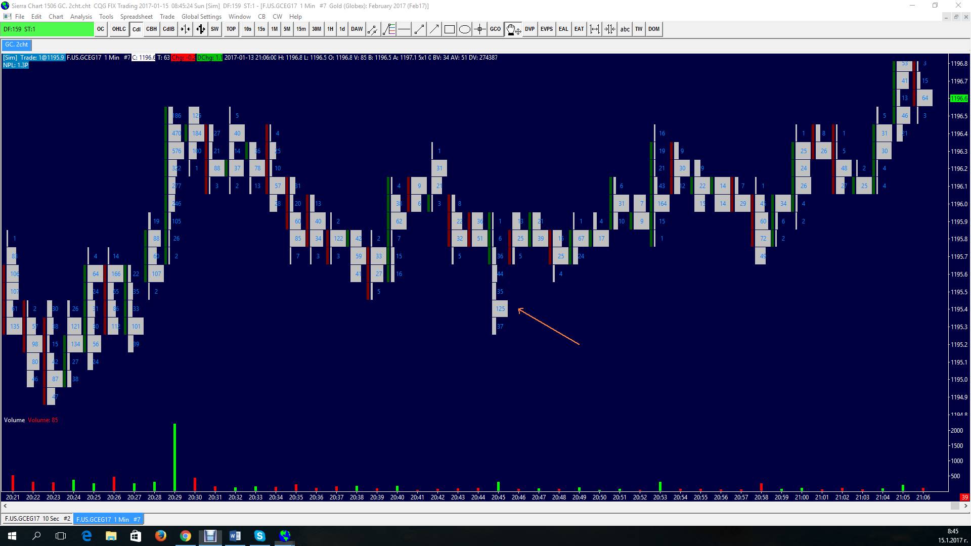

User498044 - Posts: 2
Thank you for your quick response.
I have tried the setting, however it is not what I am looking for.
It alters the way the chart bars look.
I'm attaching a screenshot. I'm looking for a setting, which will make all volume sizes on the price levels within a bar that are over 100 highlighted (the background color of all >100 to be different than gray while all other volumes below 100 remain gray).

[2017-01-16 18:47:45]
This is not exactly supported.
You can color code the text or the background. But not both.
Refer to:
http://www.sierrachart.com/index.php?page=doc/NumbersBars.php#TextColoringMethods
You want to use Volume Percentage Coloring but you can set the Column 1 Compare Threshold Input to be greater than 1 to compare to actual volume.
