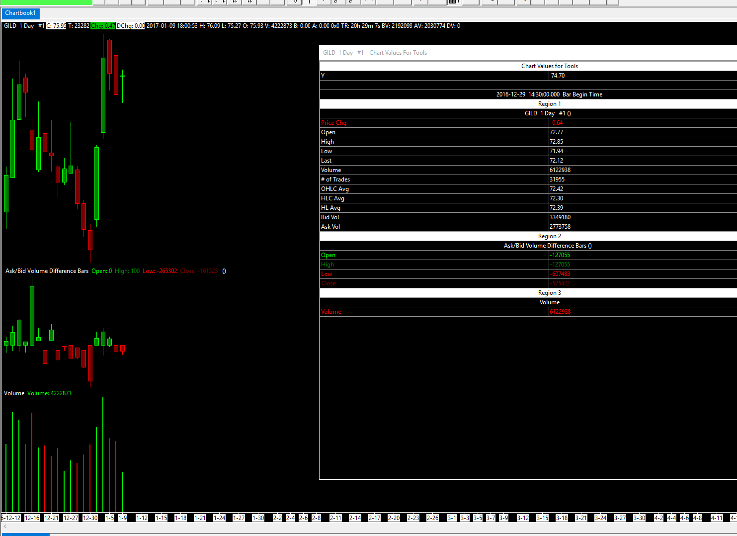

[2017-01-09 18:32:49]
User358040 - Posts: 21
I open a daily chart of gild. There I see 7 559 473 volume for last friday. What I am doing wrong??? Am I not covering pre and post market data?

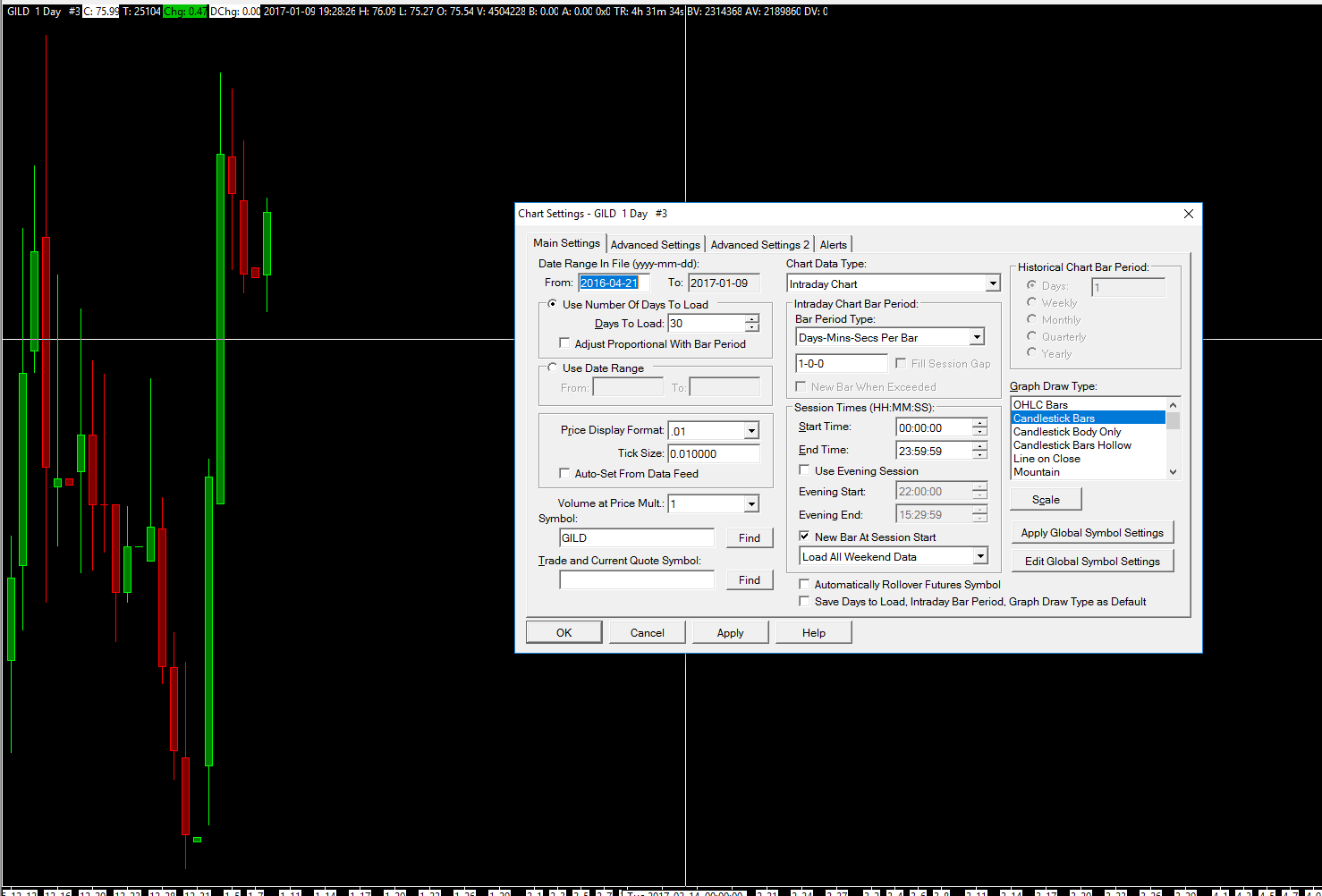

[2017-01-09 18:37:02]
is here something wrong in settings??? see attached file...

[2017-01-09 18:58:17]
I did change start time and end time. Volume now comes closer... but now there is an additional bar on the chart. What am I doing wrong?

[2017-01-09 19:29:51]
The Session Times shown in post #8 are now correct.
So we do not see anything wrong.
You should now see this volume:
2017-01-06 00:00:00.000 Bar Begin Time
GILD [M] 1 Day #43 ()
Volume: 8267662
If not, re-download the data:
http://www.sierrachart.com/index.php?page=doc/HistoricalIntradayData.html#RetryDownloadDataInChart
What additional bar are you asking about? In any case, the bars that you see are based upon the data in the chart and the Chart Settings. You need to be clear to us about specifically what you are seeing and why it should be different based upon the data for the symbol and based upon the Chart Settings.
