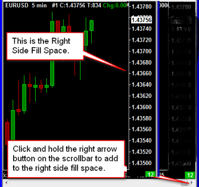

[2016-12-16 00:07:50]
aydex - Posts: 110
Is there away to move the price values next to the chart and not have the fill space separate values and chart?
http://www.sierrachart.com/images/RightSideFillSpace.png
[2016-12-16 05:04:53]
Refer to the documentation for this here:
Working With Charts: Removing Right Side Fill Space
[2016-12-16 05:13:42]
aydex - Posts: 110
Sorry, what i wish to do is have the fill space to the right of the prices.
A rough diagram is attached.
fill space is the blackened out column at furthest right.
I still wish to preserve the fill space
imagefill.PNG / V - Attached On 2016-12-16 05:13:23 UTC - Size: 63.73 KB - 416 views
[2016-12-16 05:15:23]
aydex - Posts: 110
please be aware the diagram shows 2 fill spaces, i wish to have only the one at furthest right
chart|prices|fill space
[2016-12-16 05:44:40]
No, this is not supported.
