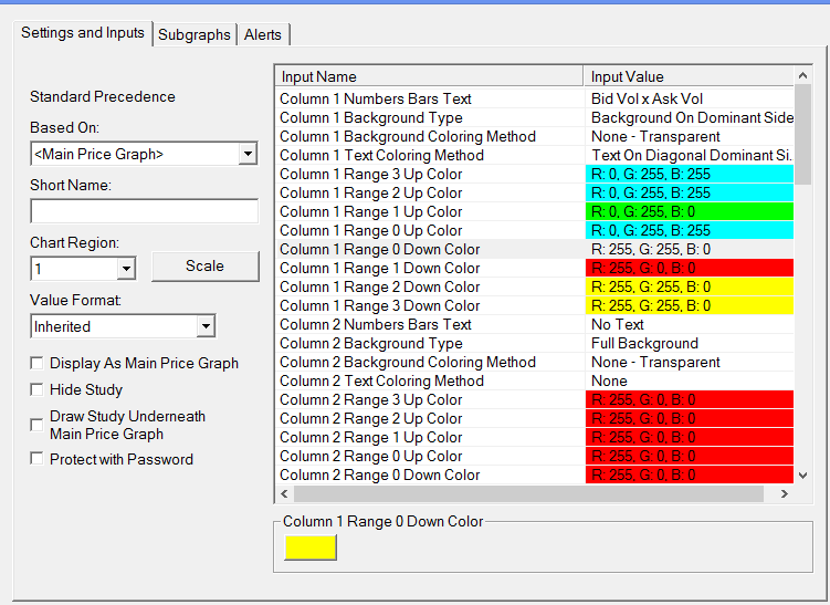

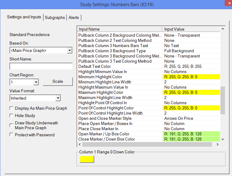

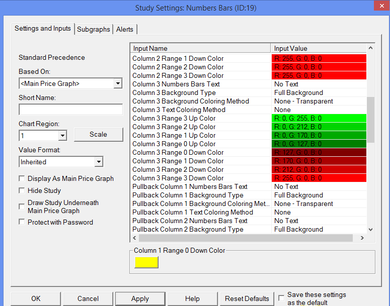

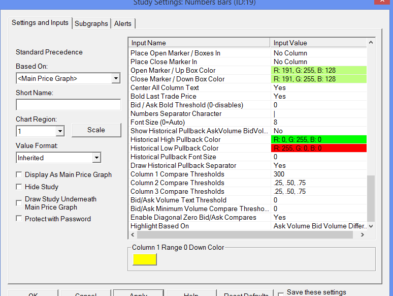

I'm trying to set up Numbers bars with diagonal dominant text coloring. I'm after a 300% difference between the diagonals that prints the highest number in bold and changes the color.
I thought I had it at one point but then noticed a few diagonals that were nowhere near 300% difference had also been printed. (EG - 481/768 on the diagonal)
I've followed the documentation as best as I can but it still wont highlight the numbers bars as I'm trying to set them up.
(Please see attached for pictures of the settings.)
The colors I'm after is that:
- it should turn from Yellow to Red on the Sell side when its 300% more then its associated Buy diagonal
- it should turn from Cyan to Green on the Buy side when its 300% more then its associated Sell diagonal
I have setup
Column 1 Numbers Bars Text = Bid Vol x Ask Vol
Column 1 Background Type = Background on Dominant Side
Column 1 Background Coloring Method = None - Transparent
Column 1 Text Coloring Method = Text On Diagonal Side
Column 1 Range 3 Up Color = Cyan
Column 1 Range 2 Up Color = Cyan
Column 1 Range 1 Up Color = Green
Column 1 Range 0 Up Color = Cyan
Column 1 Range 0 Down Color = Yellow
Column 1 Range 1 Down Color = Red
Column 1 Range 2 Down Color = Yellow
Column 1 Range 3 Down Color = Yellow
Column 1 Compare Thresholds = 300 (%)
Enable Diagonal Zero Bid/Ask Compares = Yes
Highlight Based On = Ask Volume Bid Volume Difference
Can someone please point out where I'm going wrong?
