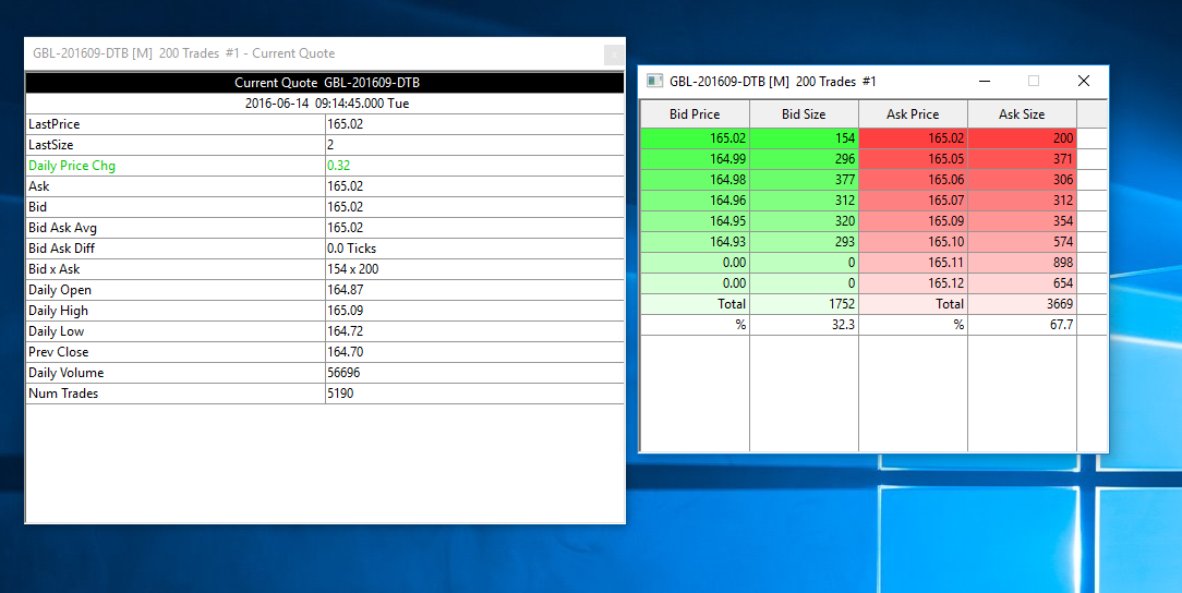

Dear Support Team,
I am missing levels in the market depth for FGBL and FESX on Eurex with the SC Data Feed.
Please see attached a snapshot for FGBL.
Could you please take a look into it? Thanks!
Best regards.
imageFGBL.PNG / V - Attached On 2016-06-14 07:26:48 UTC - Size: 184.57 KB - 368 views
[2016-06-14 07:27:58]
We are checking on this.

[2016-06-14 07:37:21]
This is clearly a Barchart data problem. We are working on it.
[2016-06-14 07:44:59]
There is clearly a Barchart data problem. We are going patch in a different data feed, but that may take us up to 30 minutes.
[2016-06-14 08:22:20]
The EUREX data feed is now working. We apologize for the issue. It was a Barchart server data problem. They have been notified about it. We are using an alternate data feed at this time. We will make it clear to them, that they need to do a much better job and this is quite serious because this is the second time in recent months this has happened.
