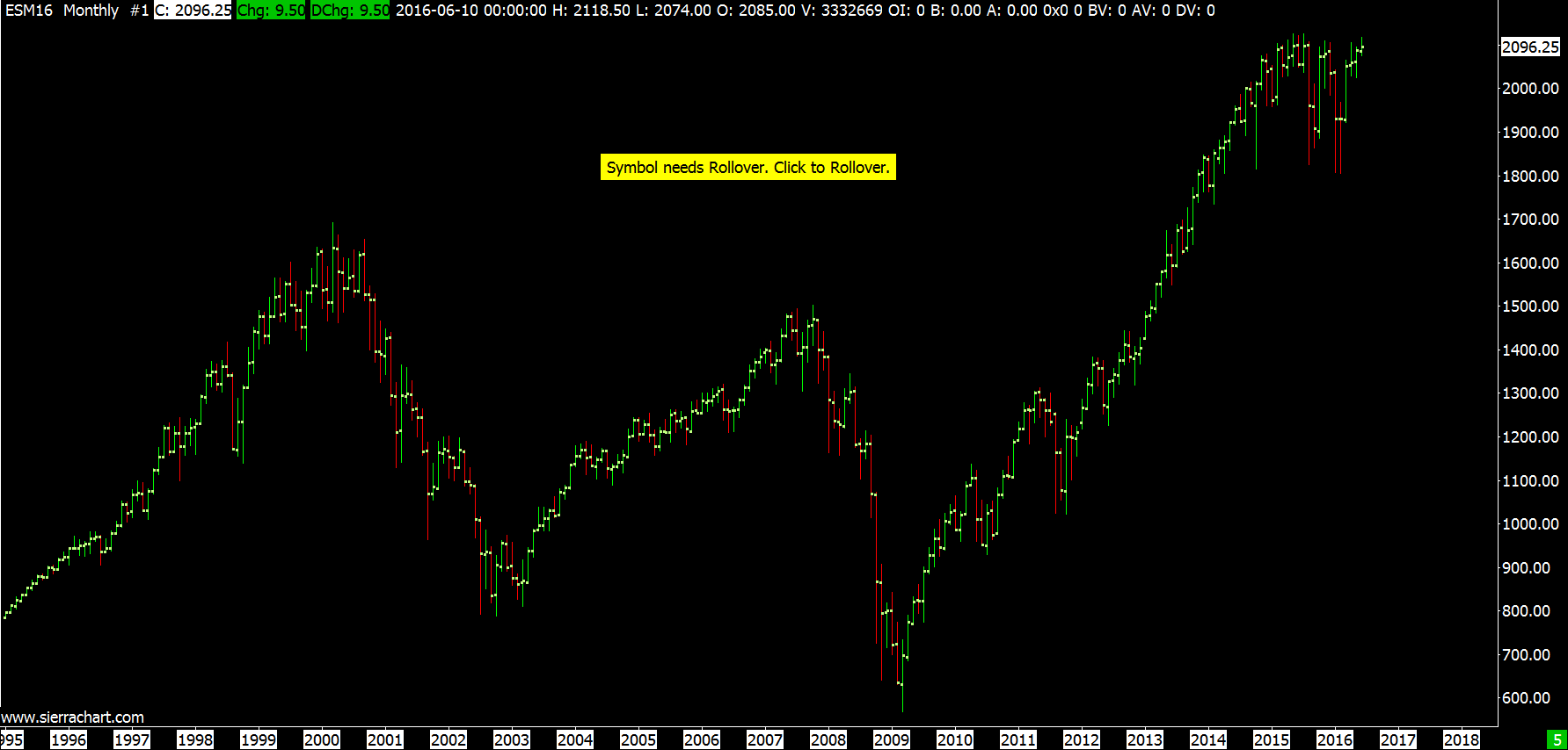

Both of these files immediately opened without any problem through File >> Open Historical Chart.
Here is a chart of one of them:
http://www.sierrachart.com/image.php?Image=1465697921648.png
This is with all of the data loaded into the chart.
The problem may have something to do with one of the studies on the chart. When you open these files individually do you see a problem?
