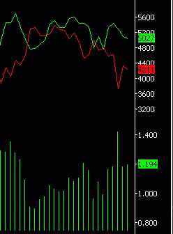

Is it possible to have this study update based on a different timeframe from what the default/live is?
I have a study that calculates a ratio between total bid and ask depth. Obviously this changes every second but I want to see what the depth was say at the end of a 1 minute bar. This would be helpful for historical study. I have a setup that depends on this and if I knew what the depth ration was at some time in the past, even if it's just few days, I could study this without having to sit in front of the PC.

[2018-06-11 17:57:38]
chart_warrior - Posts: 96
Thanks, this works kind of.
The problem is that it's not showing me a bar with wicks so I don't know what the high/low was.
If you look at the attached GIF image you will see that ratio is moving but not leaving a trace at the top like a normal candle stick so if I go back in time I don't know what the high/low was. Is there any way to change it?
