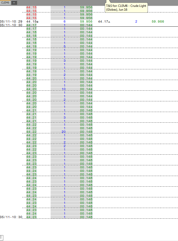

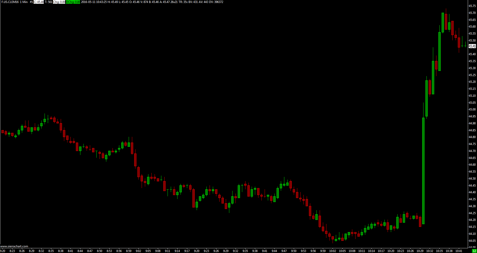

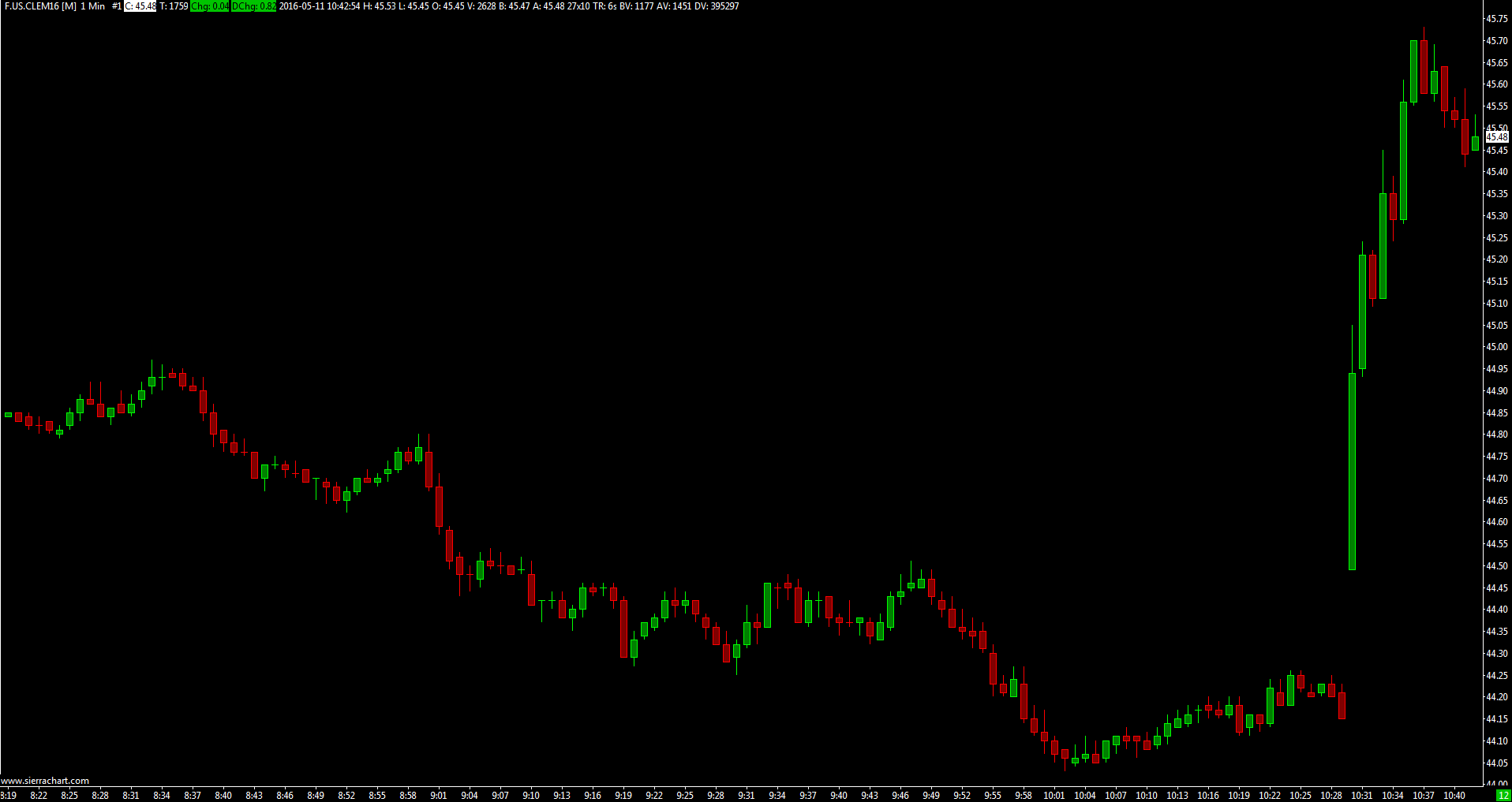

Hello SC team, please take a look at the charts. Looks like there was a problem with the data handling at the time of EIA release today (10:30 EST). I didn't check other symbols.
Thanks.
imageF.US.CLEM16 [M] 1 Min #1 2016-05-11 10_42_56.273.png / V - Attached On 2016-05-11 14:56:42 UTC - Size: 57.13 KB - 401 views
imageF.US.CLEM16 1 Min #1 2016-05-11 10_43_27.519.png / V - Attached On 2016-05-11 14:56:58 UTC - Size: 57.86 KB - 455 views
imageT&S_CLE_20160511.png / V - Attached On 2016-05-11 14:57:15 UTC - Size: 30.9 KB - 332 views
[2016-05-11 16:49:33]
Yes, we do see this and it is due to packet loss at that moment in time. We do not know if this occurred on the Barchart network or it related to an extremely high data rate. But we will see if we can figure this out.
It is unusual to see this. We would not expect it. But we have seen occasional packet loss issues on the Barchart side which is the cause of this.

[2016-05-11 17:21:05]
We have confirmed that this was on the Barchart network switch side.
Our own server actually recorded more data than the Barchart server. For the second that experienced packet loss (10:30:00), Barchart shows 416 trades, the SC data feed has 577. The actual trades is 1356. There is no data loss the following second.
Date Time Of Last Edit: 2016-05-11 17:21:23

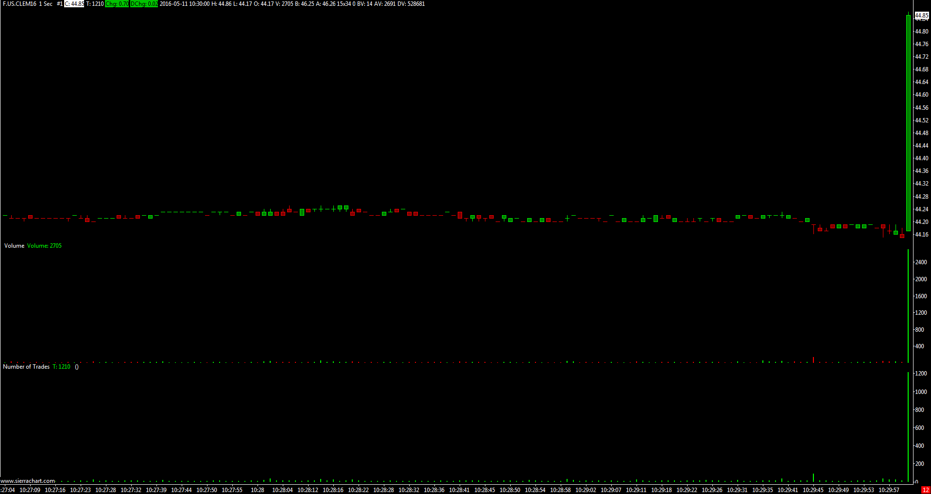

[2016-05-12 17:09:25]
User11942 - Posts: 298
We checked CQG and they transmitted half the volume. Although you do not see the gap, the volume from CQG was 995 for that second (10:30:00).
I did have some time today and checked CQG WebAPI data. Please take a look at the screenshot. It's showing exactly 2705 contracts traded. Please note, I didn't perform re-downloading. It is as it was recorded yesterday on my system. I guess there was a sort of confusion with volume/trades during yesterday discussion.
There are also gaps in data for N and Q, possibly for other NYMEX contracts. The EIA release readings were very surprising for majority of market participants what resulted in very abrupt and strong move in crude and products prices.
Date Time Of Last Edit: 2016-05-12 17:28:50
imageF.US.CLEM16 1 Sec #1 2016-05-12 13_07_15.500.png / V - Attached On 2016-05-12 17:08:21 UTC - Size: 31.46 KB - 442 views
[2016-05-12 18:18:53]
We see the reason for the confusion. We were looking at the volume.
When we look at the total volume for 10:30 we do see the complete volume but the time stamping at the beginning of the minute is off slightly.
