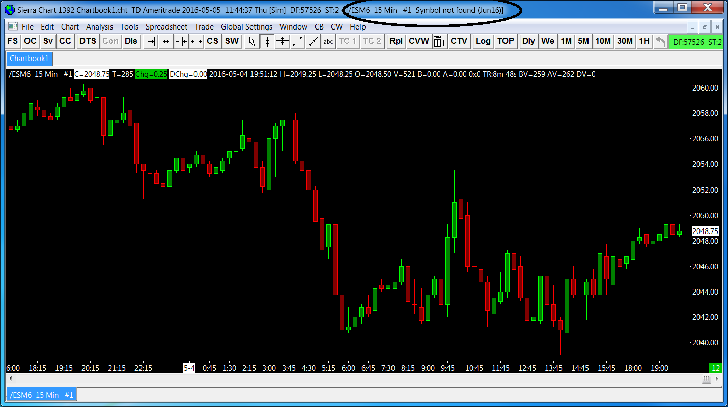

Hi, I am sending this log and a print screen because
1) I am not receiving real time data for my only chart, a 1min chart of /ESM6
2) I have no chart for GER30, I deleted that chart, but still getting messages in the log about it
3) I am receiving a message shown on the print screen [/ESM6 1 Min #1 Symbol not found (Jun 16)], that I do not understand

PRINT SCREEN:
http://www.sierrachart.com/image.php?Image=1462318327383.png

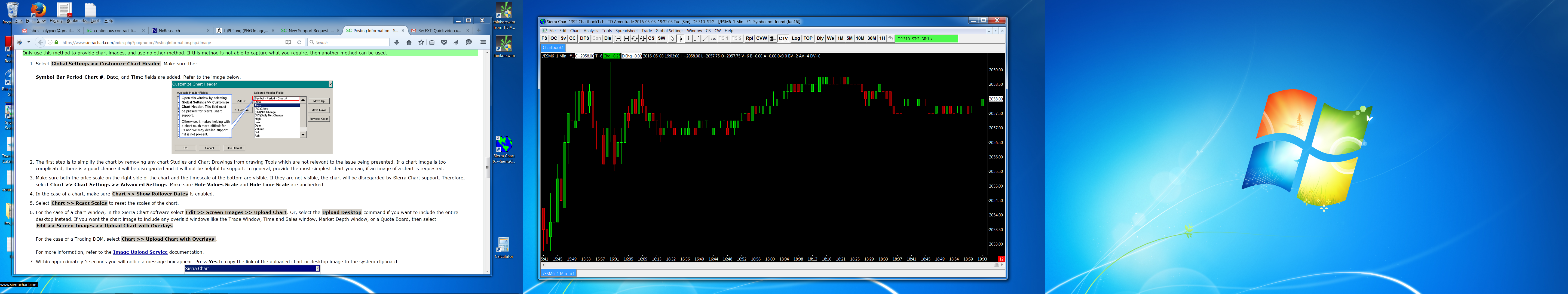

Regarding GER30, refer to:
Chart Data and Chart Data Files: Cleaning Up Old and Unused Symbols for Efficiency
[2016-05-04 17:41:11]
xRoads1 - Posts: 35
CleaningUpOldSymbols, didn't work, also what does this indicate (from the log below):

[2016-05-04 17:52:09]
This section is very comprehensive:
If you follow through all of the steps, you definitely will remove GER30 from wherever it is being used.
Gzip data is corrupt or incomplete. | 2016-05-04 13:27:16 *
This just means there is corrupt or incomplete data received from TD Ameritrade. Nothing you can do about that but it will go away when you start using the Sierra Chart Exchange Data Feed.
For real-time futures data you need to use the Sierra Chart Exchange Data Feed:
It was canceled at the end of last month due to insufficient Additional Services Balance on your Sierra Chart account.

[2016-05-04 18:47:05]
xRoads1 - Posts: 35
Here are the screens from the ChartDataFiles.html#CleaningUpOldSymbols and the log below showing that the problem still exists:

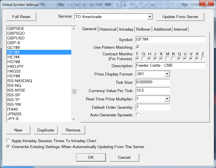

imageWindows and Chartbooks.png / V - Attached On 2016-05-04 18:43:44 UTC - Size: 37.17 KB - 411 views
imageGlobal Symbol Settings.png / V - Attached On 2016-05-04 18:43:58 UTC - Size: 93.43 KB - 423 views
imageQuote Board.png / V - Attached On 2016-05-04 18:44:53 UTC - Size: 32.92 KB - 382 views
imageSymbol List.png / V - Attached On 2016-05-04 18:45:05 UTC - Size: 31.2 KB - 434 views
imageAlert Manager.png / V - Attached On 2016-05-04 18:45:17 UTC - Size: 71.33 KB - 389 views

As we expected, you did not fully follow step 4:
See the attachment. This is from your configuration.
image2016-05-05_163053.png / V - Attached On 2016-05-05 04:32:54 UTC - Size: 12.17 KB - 429 views

There remains one issue from my original post, the "Symbol not found (June16" on the attached print screen.
imageMain.png / V - Attached On 2016-05-05 15:58:35 UTC - Size: 101.14 KB - 412 views
[2016-05-05 17:25:31]
This was already answered at post #4 above.
Here it is again:
It was canceled at the end of last month due to an insufficient Additional Services Balance on your Sierra Chart account.
Here are the setup instructions:
https://www.sierrachart.com/index.php?page=doc/SierraChartRealTimeFuturesStockDataFeed.php#SetupInstructions
