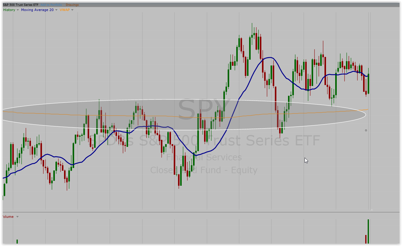

Is there an indicator in Sierra Charts that shows VWAP (Volume Weighted Average Price) just like Freestockcharts.com or other providers of VWAP study in there charts? All the vwap options I can find are different in Sierra...Just looking for a single line that is the same on all time frames.
Please view photo for reference
imageScreen Shot 01-17-16 at 11.06 PM.PNG / V - Attached On 2016-01-18 05:08:37 UTC - Size: 93.83 KB - 1162 views

We need more details. For how long of a time frame do you want the Volume Weighted Average Price calculated over?
And this study is only going to be accurate when used on Intraday charts.

I don't know what the calculation is that they use. I just know that the value remains the same on every timeframe intraday. They do not disclose the formula they use, but I know that its the standard on most charting platforms, including think or swim, freestockcharts, tradingview, etc.
As far as I know it's the main vwap calculation that almost every charting platform or website I have ever used has. I know you guys will have it, just have to find it...
[2016-01-18 07:48:48]
With the Volume Weighted Average Price study set the following inputs:
Time Period Type: Days
Time Period Length: 1
Base on Underlying Data: Yes
It is required that the chart be an Intraday chart only for accuracy and consistency.

That still doesn't give me the right calculation for vwap. there has to be a line based VWAP. Did you look at the freestockcharts example? It should look just like that...

Tell us how all of the Input Settings are set for the Volume Weighted Average Price study on the chart.
Use the Sierra Chart Historical Data Service for data :
Make sure there is a tick by tick data configuration:
Re-download the data in the chart with Edit >>Delete All Data and Download.
Also it does not matter with what you see with another service. That is irrelevant. We will only provide you instructions on how to get an accurate calculation based upon the settings that you require and once we are certain that you have done all of the proper steps, then we will confirm whether what you see is accurate or not.
Date Time Of Last Edit: 2016-01-20 19:09:01
[2016-01-20 19:37:44]
User455772 - Posts: 22
Ok I think that worked. So the IB data is the problem here basically on everything.
