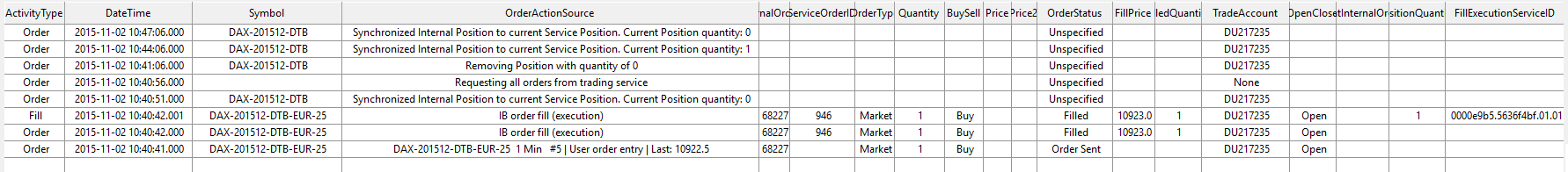

I am using new version of sierra chart 1316 and the 953.1 build of the TWS from interactive brokers. Since today morning as I send market order to buy, the position disappears from sierra chart shortly after it was filled.
I can still see the position as open in the TWS, and can be closed there manually.
Please see the screenshot of the trade activity log. I can see there "Synchronized Internal Position to current Service Position" exactly ten seconds after the position was open and that's the trigger to remove open position from sierra chart. I could also notice the difference in the symbol column - maybe that could be hint in the investigation.
3 minutes later position appeared back and after another 3 minutes again disappeared. Unfortunately during live trading this behavior is not acceptable as you can imagine.

[2015-11-03 06:44:01]
You can see the Trade Position data that Interactive Brokers is sending to Sierra Chart from the TWS API through Trade >> Trade Orders and Positions >> Positions >> Trade Service Position Quantity. Monitor that and see if the correct Trade Position data is being received.
The problem is clearly on the Interactive Brokers side. We have not changed anything which would cause this. The symbol difference you see in the log is not the reason for the problem. Sierra Chart has a method to handle that.

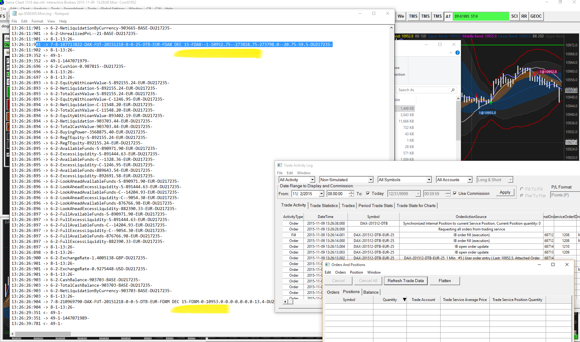

after some time (without problems) I could observe today again this behavior. This time I checked the communication logs on IB side and I could saw that they are reporting correct position size according to API:
https://www.interactivebrokers.com/en/software/api/apiguide/c/updateportfolio.htm
IB log:
13:26:11:901 -> 7-8-187713822-DAX-FUT-20151218-0-0-25-DTB-EUR-FDAX DEC 15-FDAX--1-10952.75--273818.75-273798.0--20.75-59.5-DU217235-
13:26:26:904 -> 7-8-210969790-DAX-FUT-20151218-0-0-5-DTB-EUR-FDXM DEC 15-FDXM-0-10953.0-0.0-0.0-0.0-13.4-DU217235-
13:29:27:017 -> 7-8-187713822-DAX-FUT-20151218-0-0-25-DTB-EUR-FDAX DEC 15-FDAX--1-10951.0--273775.0-273798.0-23.0-59.5-DU217235-
13:29:27:017 -> 8-1-13:29-
13:29:27:018 -> 7-8-210969790-DAX-FUT-20151218-0-0-5-DTB-EUR-FDXM DEC 15-FDXM-0-10952.5-0.0-0.0-0.0-13.4-DU217235-
Could be that SC does not differentiate between FDAX and FDXM ??
In the attachment you can find the screenshot with sierra chart's positions tab and IB api log.

[2015-11-09 18:34:53]
The problem is because the currency and the multiplier are not part of the Position symbol.
So FDAX and FDXM are both affecting the position reporting for the same symbol.
We are solving this now.
