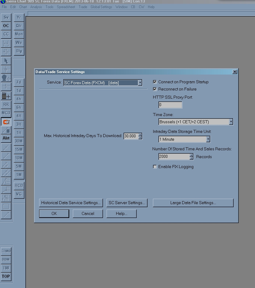

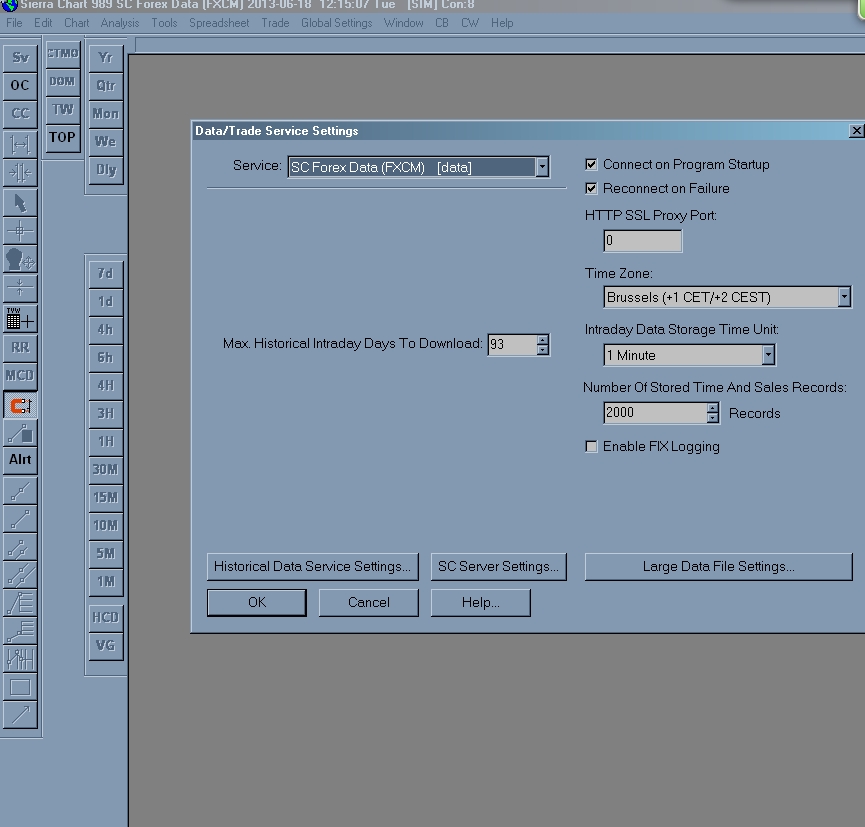

tool bar setting + Data setting not persistent after update & restart
see pics
It always reverts to "pic1"
image2013-06-18_1.jpg / V - Attached On 2013-06-18 10:22:21 UTC - Size: 201.62 KB - 843 views
image2013-06-18_2.jpg / V - Attached On 2013-06-18 10:22:55 UTC - Size: 199.69 KB - 836 views

the position of the tool bars AND the "Max.Historical Intradays To Download" number
[2013-06-18 15:54:04]
30000 is not a valid Maximum Historical Intraday Days to Download. It is much too high. This is why it is being reset.

30000 Maximum Historical Intraday Days to Download was valid till yesterday. Also it reset to the maximum possible before now it sets it to 96. I need the maximum intraday data for forex.

We tried setting the Historical Intraday Days to Download to 30000 and the number did not change back to the default. We had thought it was being reset back to the default, but this is not the case.
It seems as though the problem you are having with both of these is that the Sierra Chart configuration file (sierra3.CFG) might be set to read-only or your Windows account does not have write access to the folder Sierra Chart is installed to.

But the "reset" only occurs after you restart sierra - no reset during the running session.

All show the same reset issue for Historical Intraday Days to Download after restart.

2.Correction: The maximum setting is going to be 10000. If you go higher than this, it will default to 93.
