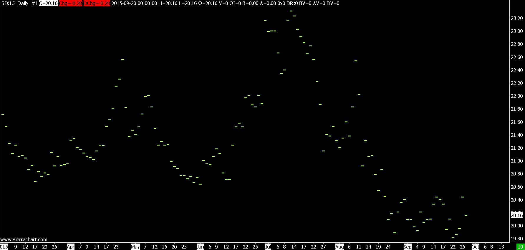

We did get a chart of BMF cash settled soybeans:
http://www.sierrachart.com/image.php?l=1443499442951.png
However there is no historical Intraday data available for this symbol. We are checking on this.

[2015-09-29 17:15:38]
Our data provider says there is no Intraday data for the SJ futures because there is no trading activity for it.
You can tell by looking at the Volume of each bar on a Daily chart. It will be zero.
