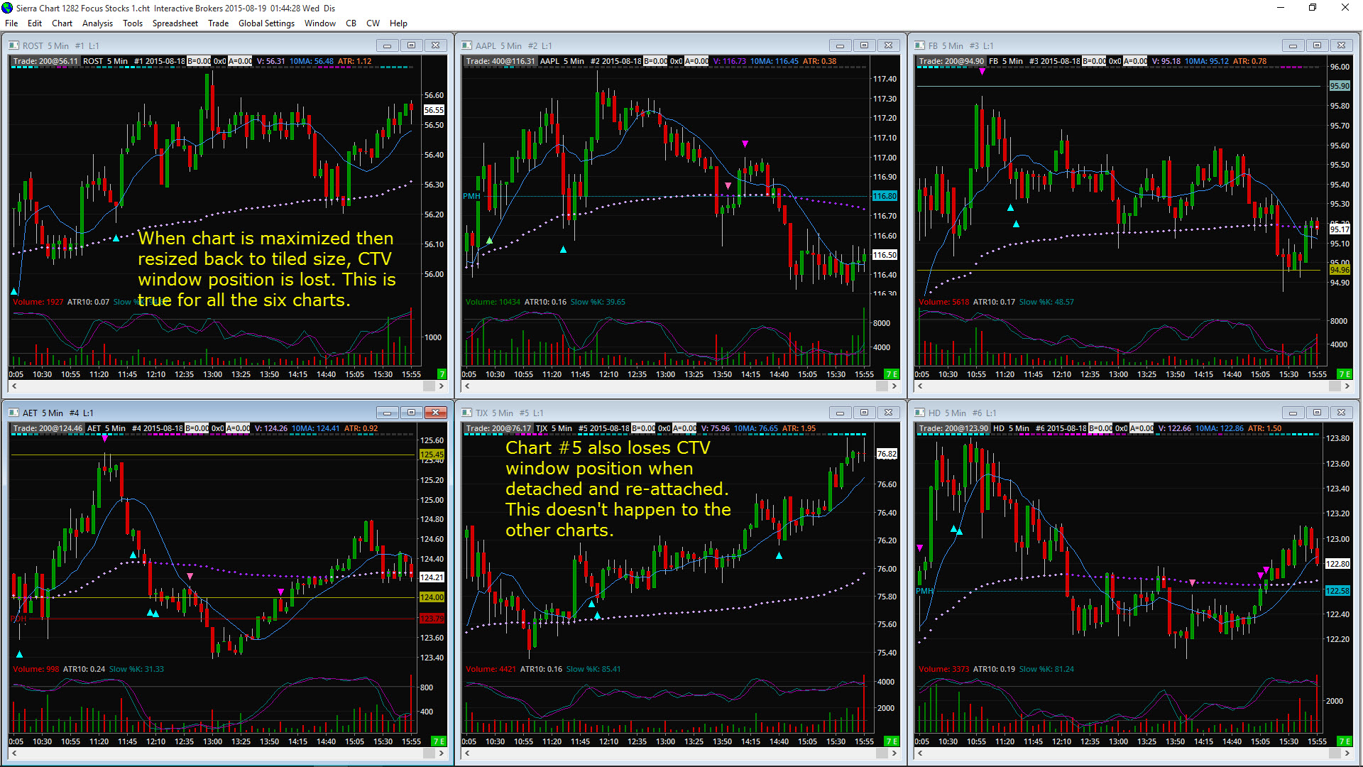

I upgraded to SC version 1282 from 1265. Under Tool Settings, I checked Save CTV Window for Each Chart. My chartbook has 6 stock charts tiled vertically so that charts 1, 2, and 3 are at top row, and charts 4, 5, and 6 are at bottom row. See attached image for my chartbook layout.
When I maximize a chart and resize it back to tiled size, SC loses the saved CTV window position for the chart. This occurs for all the six charts. At the end of the trading day, I maximize charts of stocks I traded to take a screenshot for my trade review.
Also, when I detach and re-attach chart #5, the saved CTV window position for the chart is also lost. This occurs only for chart #5 but not to the other five charts. I detach chart of stocks I trade to bring it to the forefront of the other stock charts and opened time and sales and trade windows opened.
I hope you can fix this issue. Thanks.

[2015-08-19 06:47:52]
This is by design:
It will move relative to the top left of the chart window to maintain its identical position.
We do see a problem with this and we will look into it.

[2015-08-19 07:13:08]
rc7rader - Posts: 145
This is by design:
I always put the CTV window to the upper left hand corner of the chart window. When I maximize and resize back, the CTV windows for the different charts are all over the place, some at the bottom, middle or right side of the chart, and chart #5 is always partially below screen view. I don't understand how they are relative to the top left of the chart. Maybe defaulting near the upper left hand corner of the chart window whether tiled or maximized is a better alternative, in my opinion.
[2015-08-19 07:26:01]
We cannot duplicate this problem.
We positioned the Compact Tool Values window at the top left of the chart and maximized it and restored it and the position was identical relative to the top left. This is on version 1282.
Keep in mind this window is saved relative to each chart.
So if what you are seeing is different, we have to think about why it would be happening in some cases.
[2015-08-19 07:57:27]
I am able to duplicate it all the time. I suggest you save the chartbook with 6 charts then close Sierra Chart. Run Sierra Chart again, open the chartbook. Try checking the positioning of the CTV on the tiled window first, then maximize and check CTV position, then resize back check the position. Do this for all the charts and you'll see the window positioning is inconsistent. I tried this by creating a chartbook and put 6 clean charts with only price and no studies just to eliminate the possibility that the studies I have may be contributing to this issue.

[2015-08-19 10:38:26]
TechTrader - Posts: 116
When retiling chart windows from vertical to horizontal or vice versa the CTW does not retain its position relative to the chart.
[2015-08-19 16:36:51]
What we are observing with post #7 is that chart windows which are tiled and not active, will not have the Compact Tool Values Window repositioned with a tile operation. This we cannot solve and we will not try to solve this. You will have to do a manual reposition.
Or use a common location by unchecking Global Settings >> Tool Settings >>Save CTV Window Position for Each Chart.
