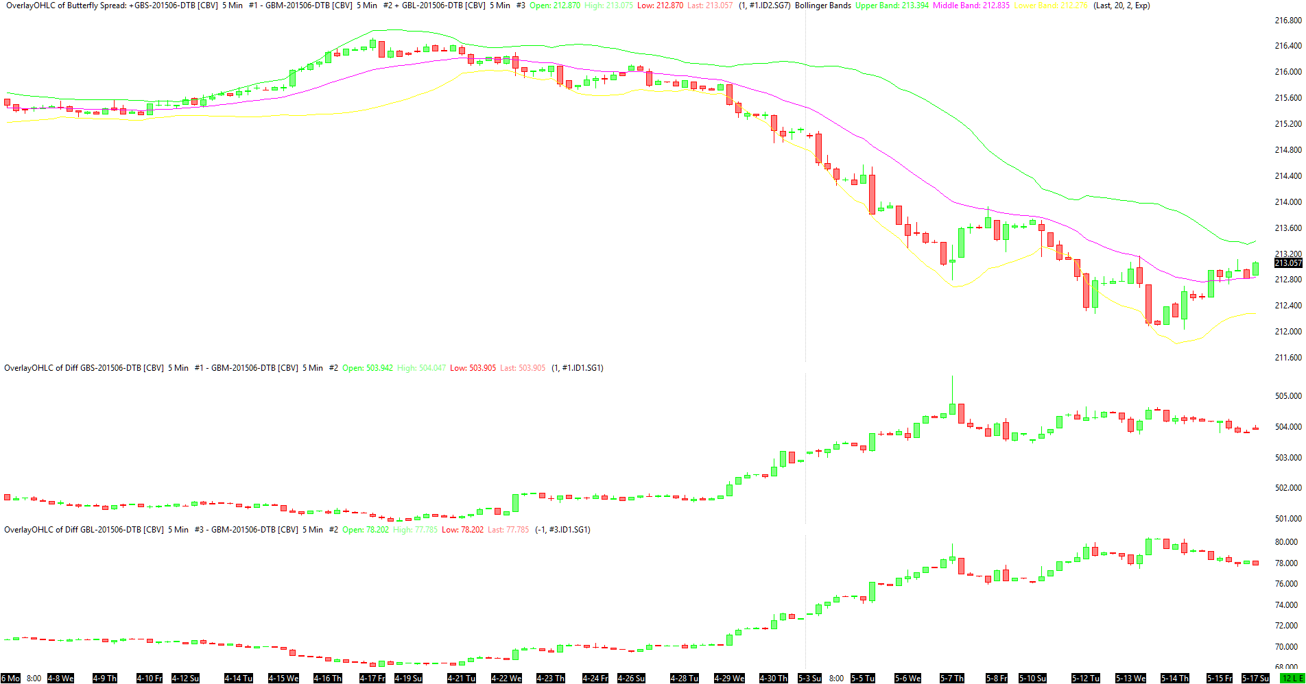

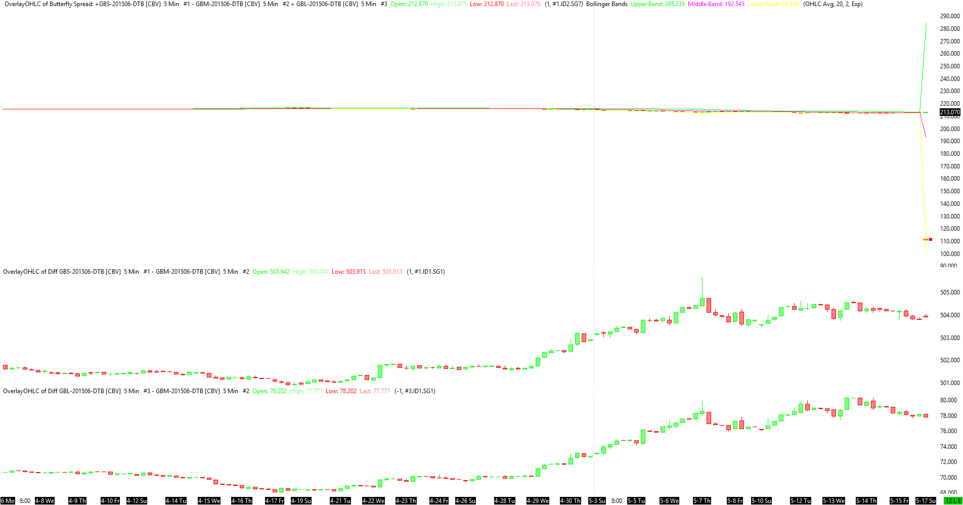

[2015-05-18 06:57:14]
i960 - Posts: 360
Only open, high, low, or last settings work. Use of anything involving the remaining 4 common settings (of which the default is HLC average) causes the bands to explode.
imagesc_ohlc_overlay_bb_0.png / V - Attached On 2015-05-18 06:56:40 UTC - Size: 94.71 KB - 756 views
imagesc_ohlc_overlay_bb_1.png / V - Attached On 2015-05-18 06:56:50 UTC - Size: 78.9 KB - 674 views

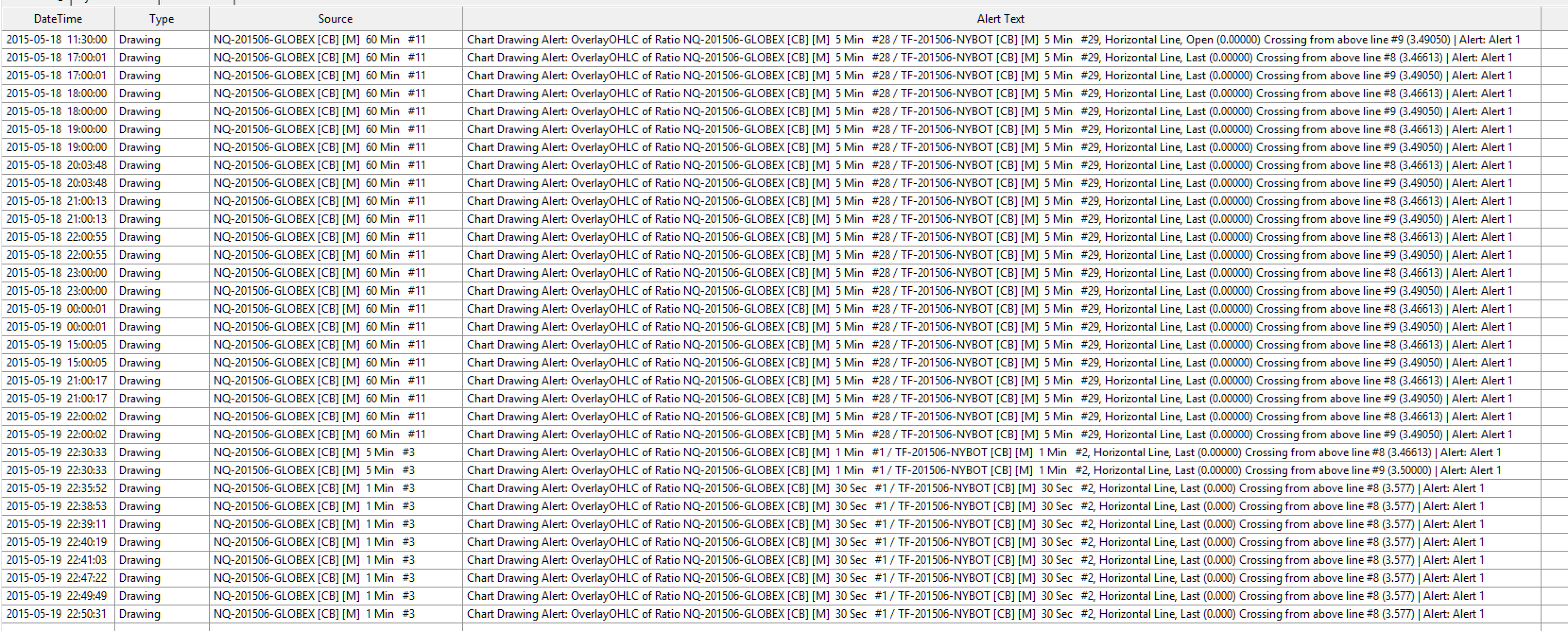

All I'm basically doing is adding a bollinger band to a "high accuracy" spread as per the instructions offered on the Sierra Chart website. In my particular case the input to the OverlayOHLC study is a Spread - Butterfly study but it'll act exactly the same using Diff (single line).
It's basically the OverlayOHLC study with bollinger bands. I'm also having another issue seemingly related to this where I have an alarm on a horizontal line within the region that has an OverlayOHLC study and it keeps getting triggered every single new bar with values of 0.00000 crossing the line (which is obviously not the case). It triggers the alarm like clockwork, every new bar. I feel these two issues are connected.
This most definitely resembles a bug. I'll upload both chartbooks in a bit.

I don't normally use these in 30s/1m timeframes, but reduced the time window to demonstrate the alarms firing off all the time. I have a feeling that this general issue is related to the OverlayOHLC study using a spurious value of 0.0 somewhere internally (which is why it fires phantom alarms and possibly why the BB study freaks out). I also considered that the BB study with the default HLV average as input might have issues in general with any kind of line chart - but then I tested it with a simple price chart using a line for the graph draw type and it had no problems. It's specifically with the OverlayOHLC study that it has problems.
I also uploaded a capture of the alert window. Note: the alerts with reference to 60m are from the chartbook I actually use but the ones below which are 5m and 1m are from this chartbook I made just to demonstrate the issue.
Date Time Of Last Edit: 2015-05-20 06:10:48
imageopen_ohlc_bb_issue_0.png / V - Attached On 2015-05-20 06:03:27 UTC - Size: 72.49 KB - 666 views
imageopen_ohlc_bb_issue_1.png / V - Attached On 2015-05-20 06:03:36 UTC - Size: 400.21 KB - 658 views
attachmentopen_ohlc_bb_issue.cht - Attached On 2015-05-20 06:09:07 UTC - Size: 110.23 KB - 686 views

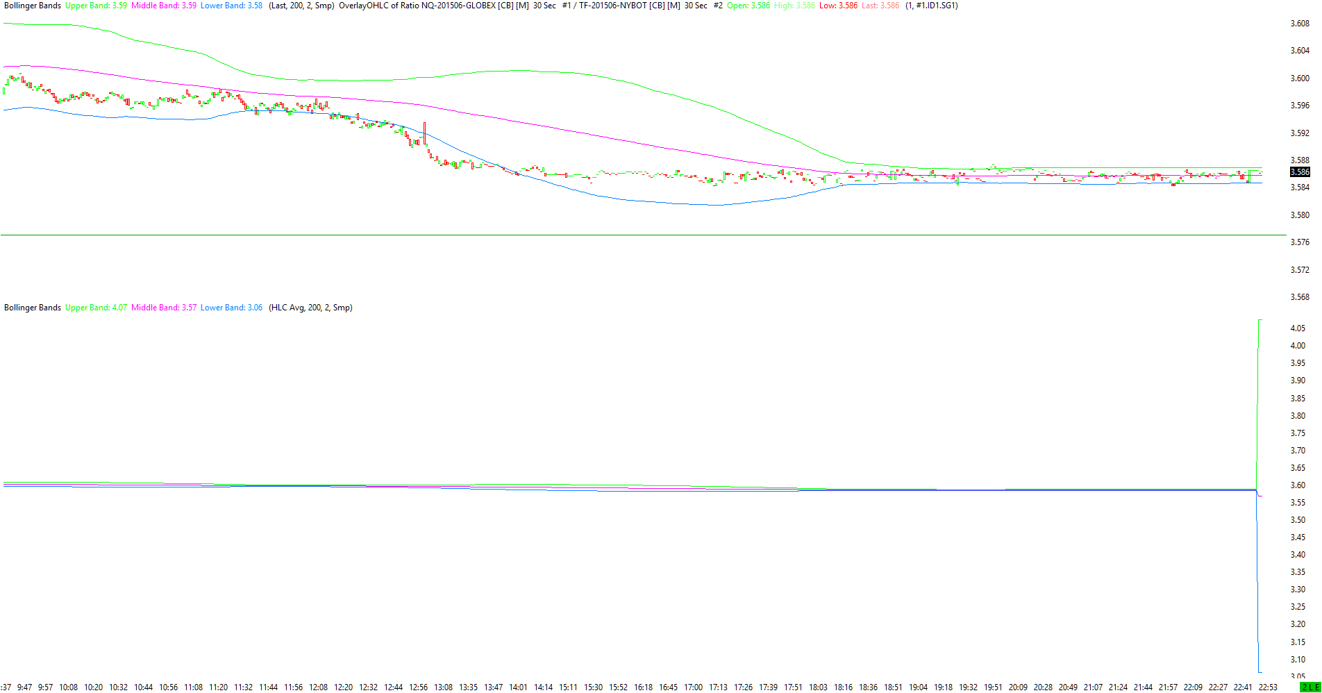

[2015-06-27 04:26:47]
i960 - Posts: 360
So I've validated that the original overlay study issue has been fixed. However, there's another issue where overlay + ratio study and a day with missing data results in bollinger band problems. It's not a data file issue as those have been redownloaded. For whatever reason there's simply no data for that day (2013/10/10). The chart capture demonstrates the different behavior of an overlay of a diff vs an overlay of a ratio. The latter has severe problems whereas the diff doesn't. It might have something to do with 0-0==0 whereas 0/0==undefined. Also, it would be good to make the ratio study mirror the diff study in having the same option to use data from the latest bar for consistency sake.
Date Time Of Last Edit: 2015-06-27 04:27:29
imageoverlay_ratio_problem.png / V - Attached On 2015-06-27 04:26:42 UTC - Size: 157.08 KB - 443 views
