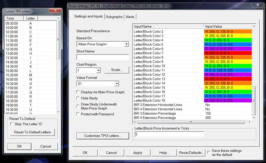

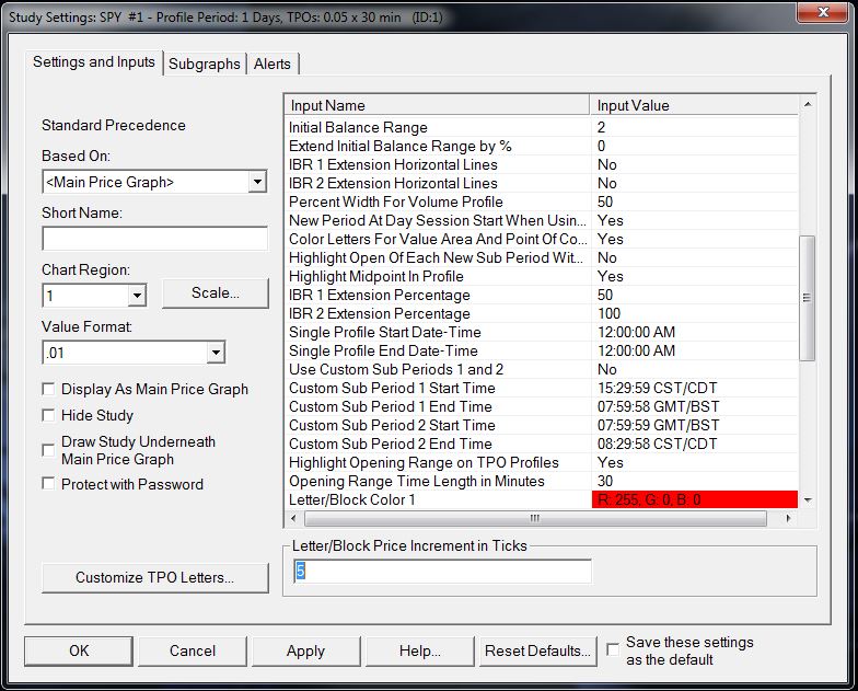

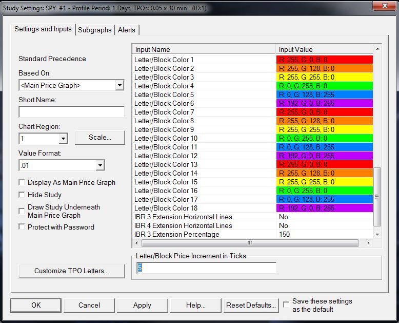

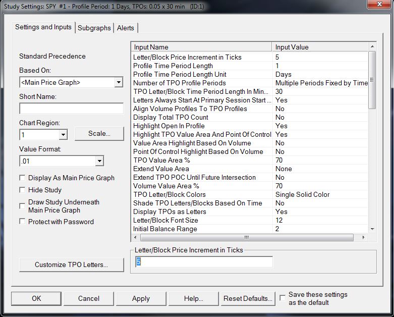

I have been using this study for the last couple weeks without any issues. However, this morning the letters associated with TPO are not behaving as expected despite unchanged settings.
1) Chart Settings for SPY are 09:30 - 16:00 without Evening Session
2) Study Settings are many so I attach screen shots of what I'm using. I have NOT customized TPO letters as per TPO Setting #4 attachment.
As can be seen from chart screen shot, the TPO profiles always start with the letter A but this morning it is starting with the letter N.
http://www.sierrachart.com/image.php?l=1369838215468.png
Furthermore, the TPO profile is stuck on the letter N and should have proceeded to the third letter because the time is 10:35am and we are into the third 30min period of the session.

imageTPO Settings # 1.JPG / V - Attached On 2013-05-29 14:38:41 UTC - Size: 116.66 KB - 960 views
imageTPO Settings # 2.JPG / V - Attached On 2013-05-29 14:38:53 UTC - Size: 118.94 KB - 1184 views
imageTPO Settings # 3.JPG / V - Attached On 2013-05-29 14:39:02 UTC - Size: 118.37 KB - 1014 views
imageTPO Settings # 4.JPG / V - Attached On 2013-05-29 14:39:10 UTC - Size: 154.61 KB - 1069 views
