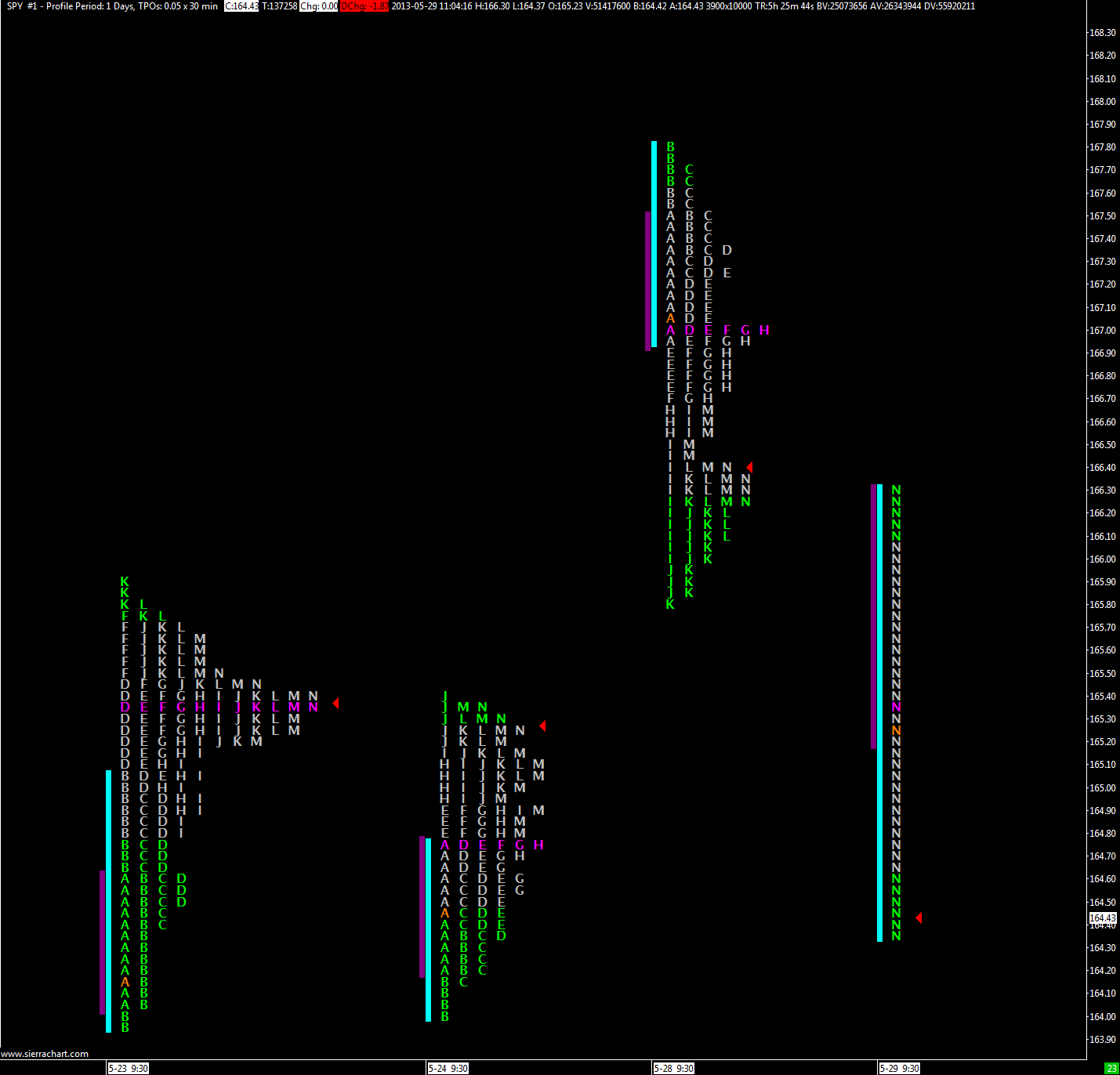

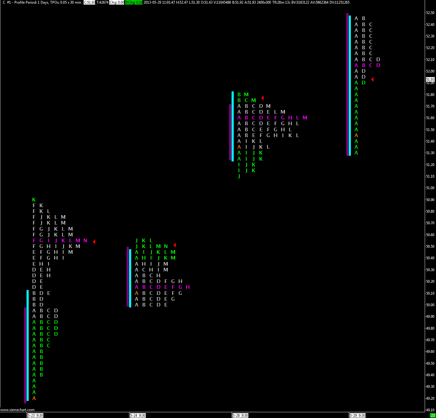

I just tried a different symbol (C) on the same chart and it seems to be working fine.
http://www.sierrachart.com/image.php?l=1369839709424.png
However, the chart for SPY is still problematic.
http://www.sierrachart.com/image.php?l=1369839857294.png
I think it must be related to the data file, and I just spotted this in the message log. I have underlined the relevant section. Think I'm getting closer to source of the problem if you could advise on best solution. I would prefer not to delete the file as I have a full 120 day history of tick data for SPY. Thank you.

Out of order timestamps detected. Chart tool drawings and some chart studies may not function properly. Prior Date Time: 2013-05-29 16:00:00. Current Date Time: 2013-05-29 09:30:00. Filename: C:\SierraChart\Data\SPY.scid | 2013-05-29 11:09:03
