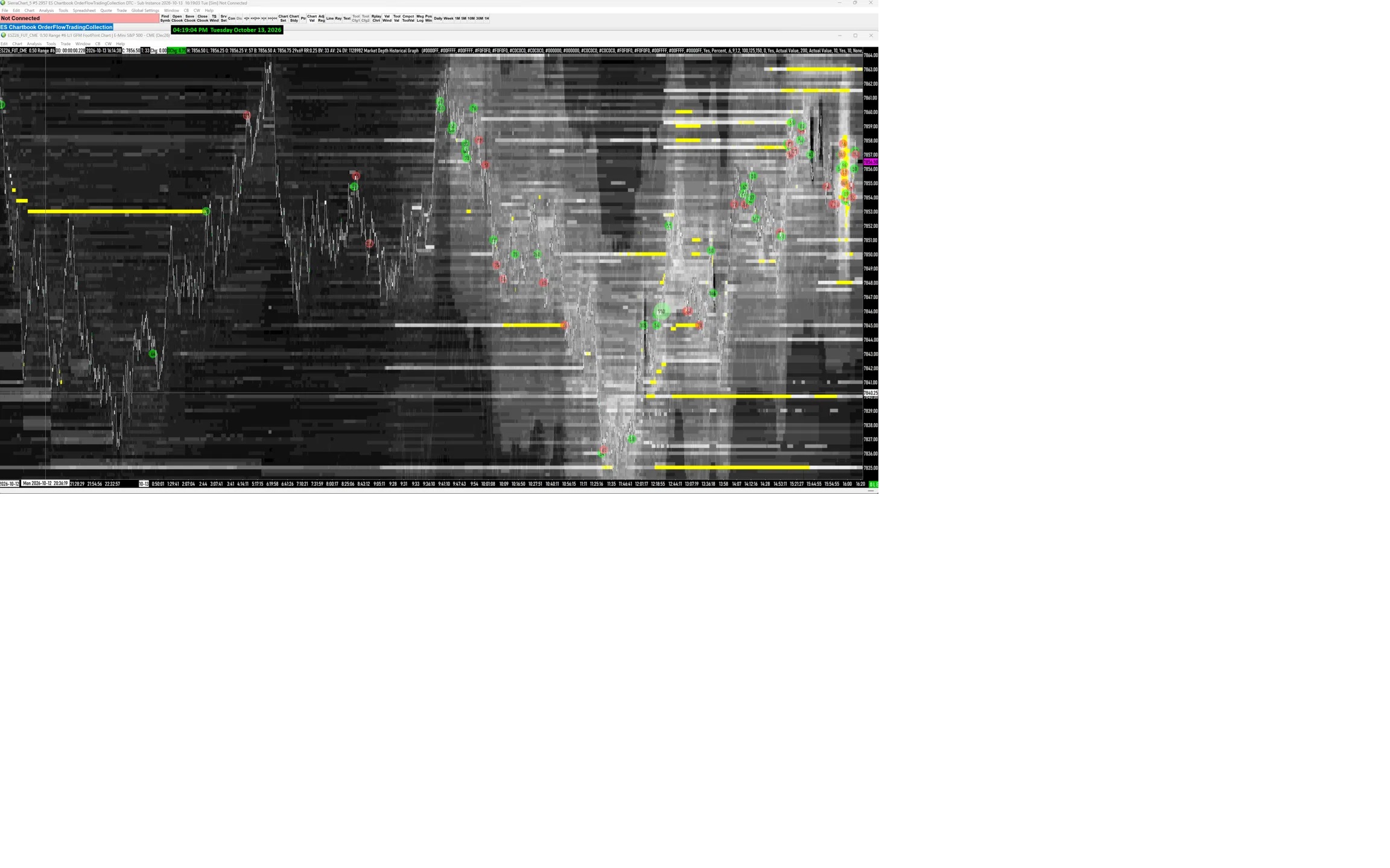

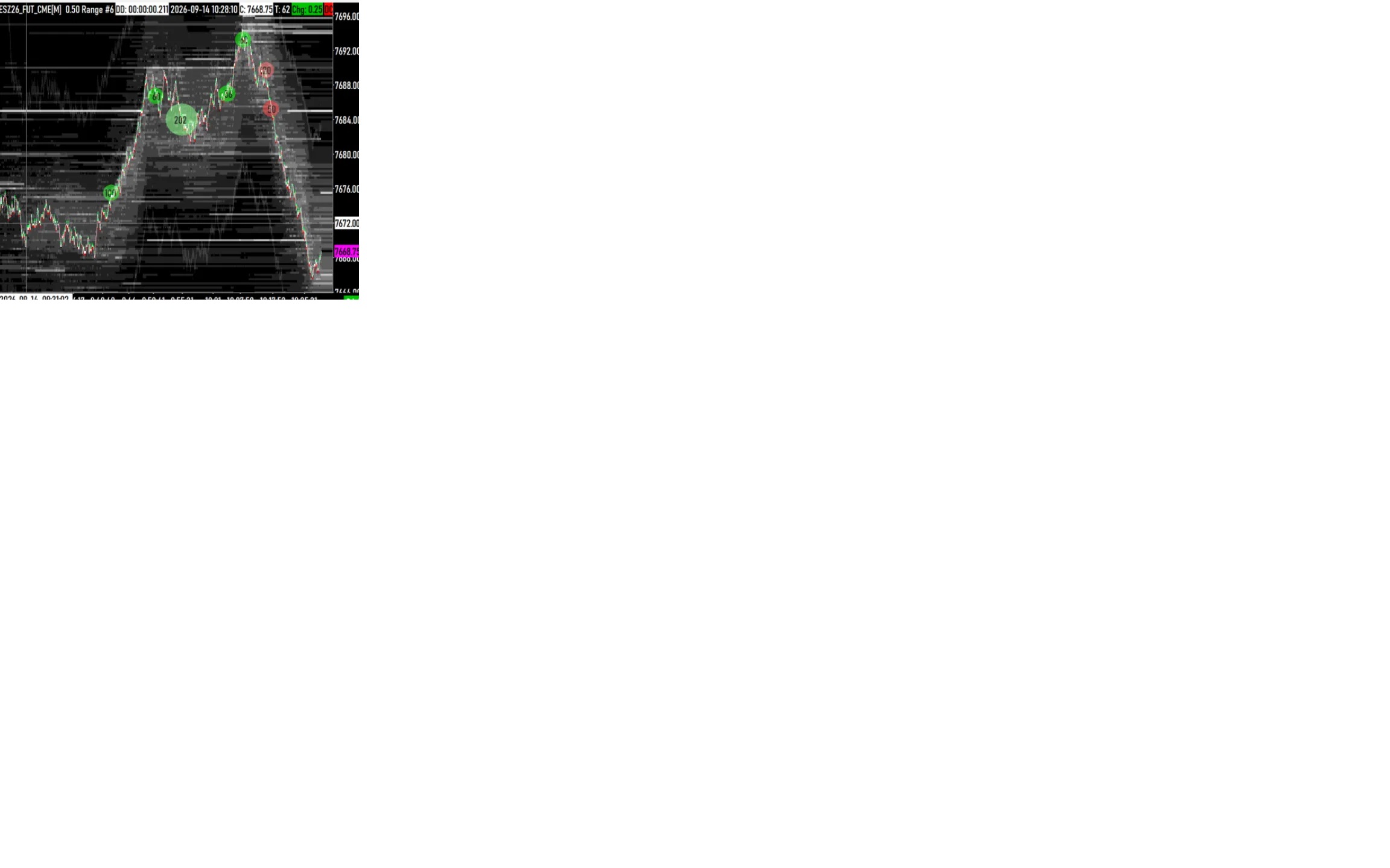

Two Issues:
1) Version 2971 64-bit (also seen on 2957) 64-bit. Chart: ESZ26_FUT_CME, Range Per Bar – Standard, 2 ticks (0.50 Range). Intraday Data Storage Time Unit = 1 Tick. Only study on the chart: Bid & Ask Prices.
On every historical bar the study’s Bid and Ask sub graphs are equal to each other and to the bar’s last trade price. Example: bar ending 2026-10-13 10:45:44.198 ET shows Bid 7851.25 / Ask 7851.25, but the last record in ESZ26_FUT_CME.scid at that time is Bid 7851.25 / Ask 7851.50 (Open = 0 single-trade record). Every record we checked (Sep 14, Oct 8–13, downloaded and real-time recorded) has correct distinct Bid/Ask.
The same happens on a newly created chart with default settings plus Bid & Ask Prices, and on bars built during a chart replay. Settings checked: Always Simulate Bid and Ask Prices During Replay = No, Load Bid/Ask Update Only Intraday Records = Yes, Split Data Records = Yes, Trades Combining Method = None.
This worked correctly on the same chart a few weeks ago (separate red/green bid/ask lines). Is there a setting I'm missing, or is this a change in recent versions?
2) 'Ask/Bid Volume Difference Bars' OOTB study as of late, last 2 or 3 weeks or so continually surfaces Array unallocated error on MSG log:
2026-10-14 09:04:19.192 | : Array is unallocated. | Number times message added: 24
2026-10-14 09:04:20.133 | Array message repeat count limit reached.
Date Time Of Last Edit: 2026-10-14 13:15:29
imageBook Map - Current with Issue.jpg / V - Attached On 2026-10-13 21:08:12 UTC - Size: 405.66 KB - 87 views
imageBook Map - Previously from about a week or 2 ago - has no is.jpg / V - Attached On 2026-10-13 21:08:21 UTC - Size: 152.33 KB - 92 views
