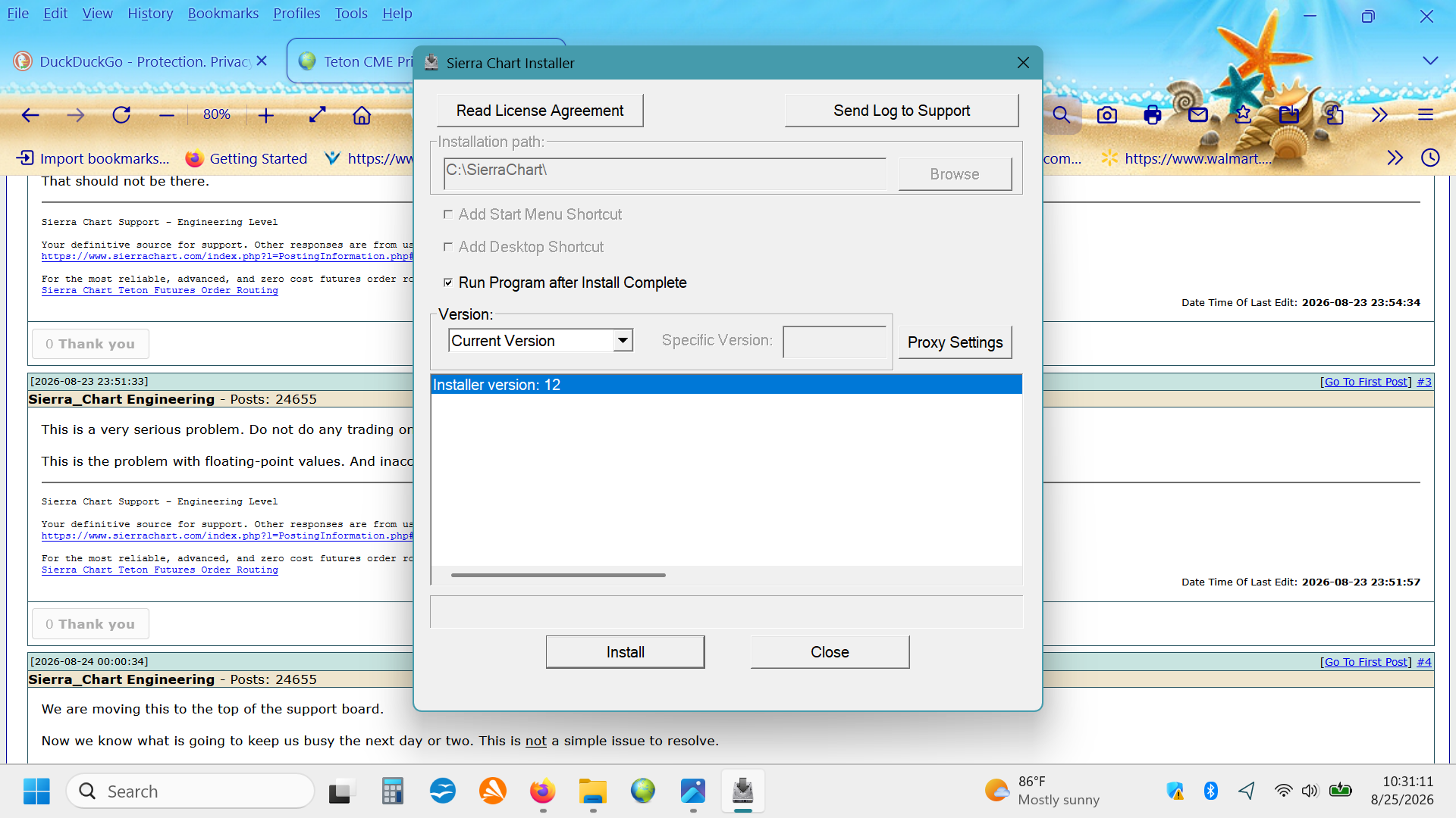

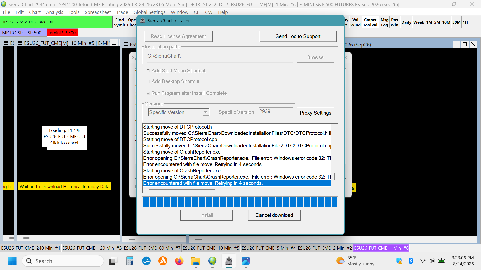

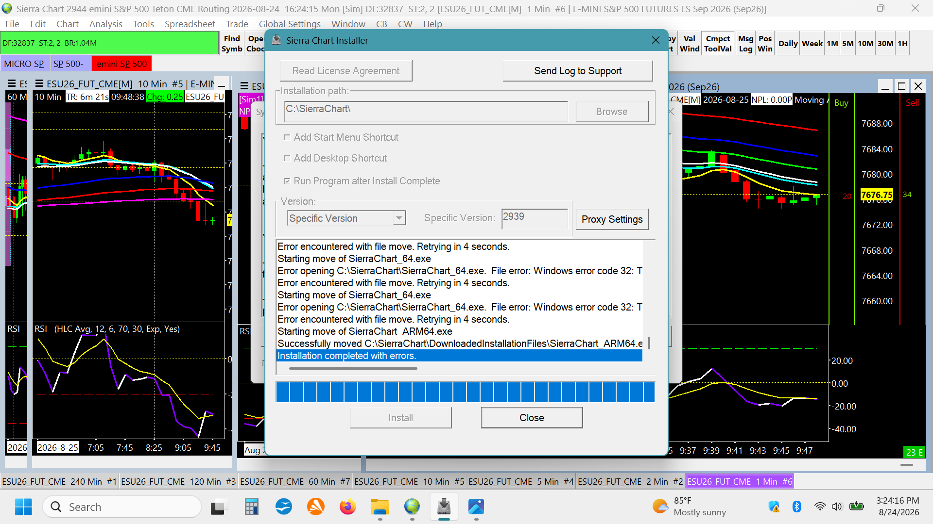

this problem affected both live and simulated trading. No there was never a message attached when I tried to place a trade. What I did was instaall a previous version and it still didn't work so I then reinstalled the current version and then I closed my Sierra Charts and reopened it and it seems to be back in working order. I will try to send you the screen shots I took of my previous version installation and then two other screen shots with my final version being version 12. I , but it seems ok now. Thank you I appreciate your promptness in responding to my problem. I really don't know what the problem was.
imageScreenshot (13742).png / V - Attached On 2026-08-25 17:04:06 UTC - Size: 185.08 KB - 63 views
imageScreenshot (13743).png / V - Attached On 2026-08-25 17:04:56 UTC - Size: 226.98 KB - 63 views
imageScreenshot (13744).png / V - Attached On 2026-08-25 17:05:12 UTC - Size: 594 KB - 71 views
[2026-08-25 19:11:41]
The error message you are getting is "Windows error 32" which means "The process cannot access the file because it is being used by another process". In those images, you have a Sierra Chart running behind the installation window. You need to ensure that the Sierra Chart instance and any sub-instances from that main instance you are updating, are all not running.
It is best to just ensure that all Sierra Chart installations are not running, and then start just the main instance for the one you want to update (close any sub-instances that you may have set to automatically start) and then select "Help >> Download Current Version" to start the update.
