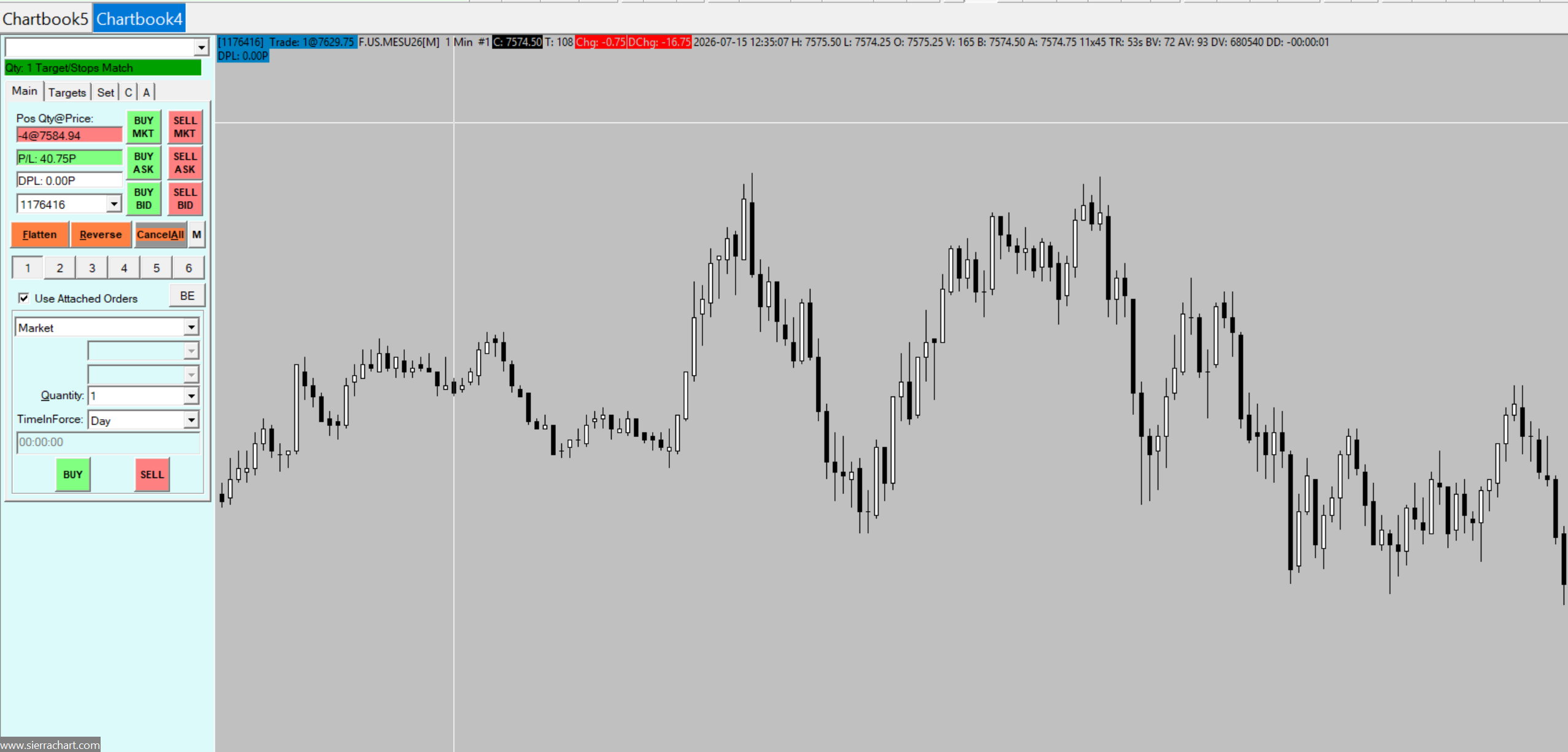

| [2026-07-15 16:35:54] |
| 6Jack6Jones6 - Posts: 30 |
https://www.sierrachart.com/image.php?Image=1784133309409.png

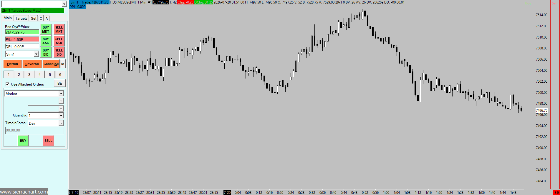

| [2026-07-15 17:21:08] |
| John - SC Support - Posts: 48303 |
Please set the Account selection on the Trade Window to be "Sim1" and adjust the scale so that the price of 7584.94 is in view and then get us another image. Make sure we can see the Price Scale in the next image.
| [2026-07-15 17:26:04] |
https://www.sierrachart.com/image.php?Image=1784136348339.png
| [2026-07-15 17:45:54] |
So the trade that the system thinks is open is associated with your live trade account and not with your Simulation account. If you do not have any actual open positions with that trading account, then please go through the instructions at the following link to deal with this: Help With Daily Profit/Loss Value: Simplified Steps to Solve Incorrect Daily Profit/Loss For the most reliable, advanced, and zero cost futures order routing, use the Teton service: Sierra Chart Teton Futures Order Routing |

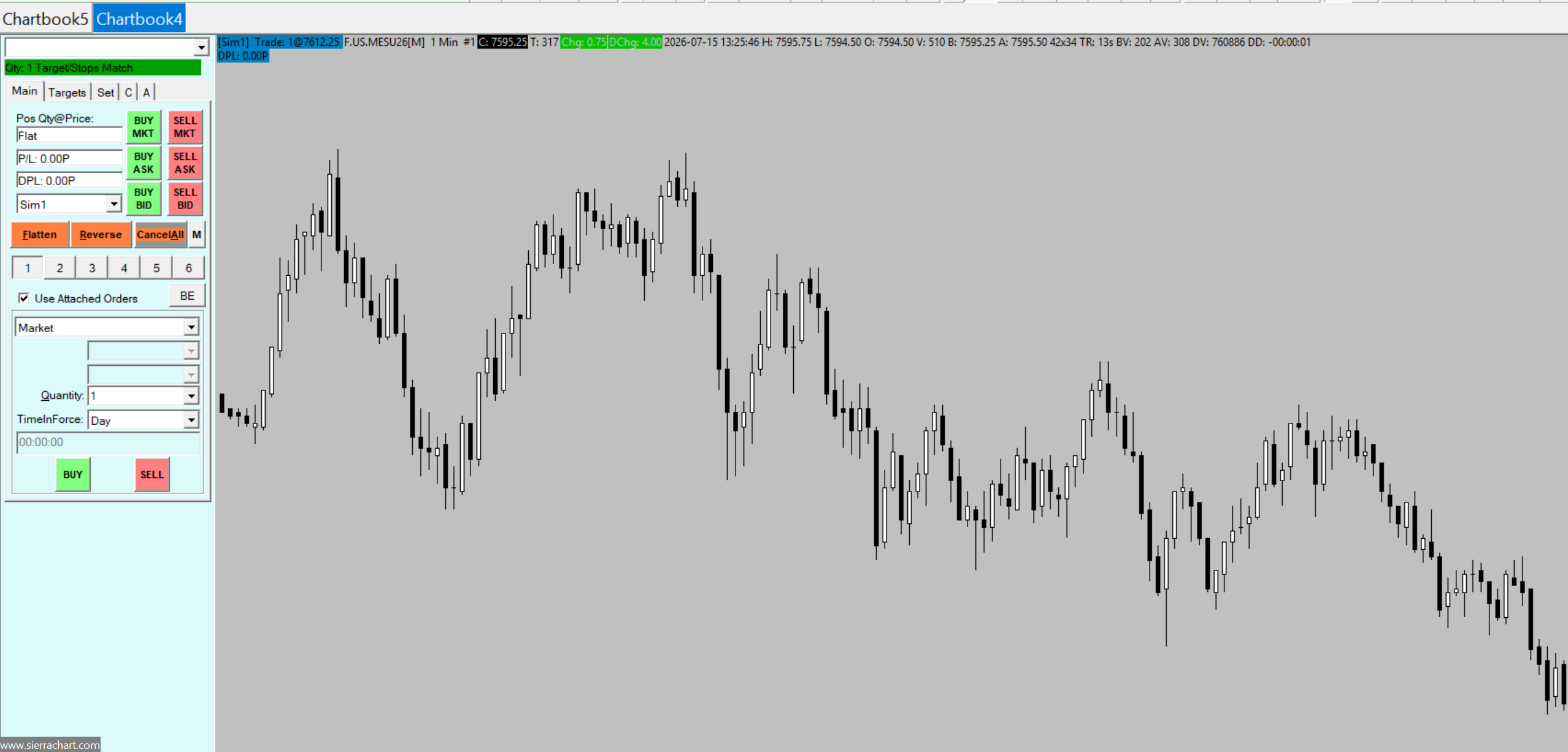

| [2026-07-20 13:12:05] |
https://www.sierrachart.com/image.php?Image=1784552984599.png When I go to make a screen image, the box disappears, I hope it shows I put it behind the screen. |
