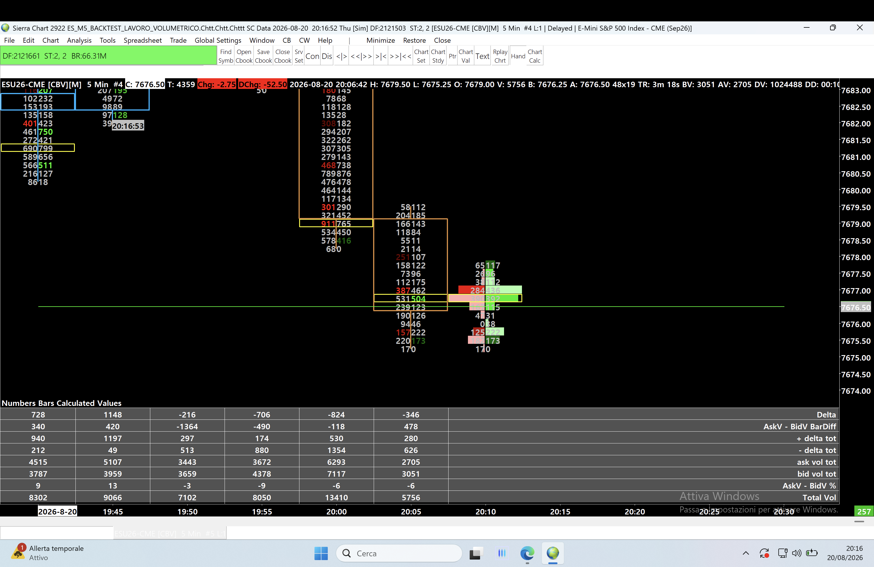

I am using Sierra Chart with a 5-minute Numbers Bars chart on ES.
I am seeing a behavior that I would like to understand because I am not sure whether it is normal.
Example:
While the current 5-minute Numbers Bar is the 19:10 bar and is still forming, I can already see Bid x Ask values displayed in the position of the next bar, 19:15.
However, on this apparent 19:15 bar I only see the Bid/Ask Numbers Bars values; the actual candlestick/body has not formed yet.
Then, when the 19:10 bar closes, those Bid/Ask values that were displayed at 19:15 disappear. The actual 19:15 Numbers Bar then starts again from zero and begins building normally.
The same behavior repeats on every new 5-minute bar.
My chart settings are:
* Bar Period Type: Days-Mins-Secs-Milliseconds Per Bar
* Bar Period Value: 0-5-0
* Split Data Records: Yes
* Trades Combining Method: None
* Session Start Time: 08:00:00
* Session End Time: 22:14:59
* Use Evening Session: No
* New Bar At Session Start: Yes
* Intraday Data Storage Time Unit: 1 Tick
* Numbers Bars: Bid Vol x Ask Vol
I have attached a screenshot showing the issue.
Could you please confirm whether this behavior is expected, and explain why Bid/Ask values are temporarily displayed in the next 5-minute bar before the current bar has closed?
If this is not expected, which setting should I change to make the Numbers Bars stay synchronized with the actual 5-minute bar?
Thank you.

Most likely that is the Pullback column that you have displayed there. In the Numbers Bars settings look at the column information for the "Pullback Column".
