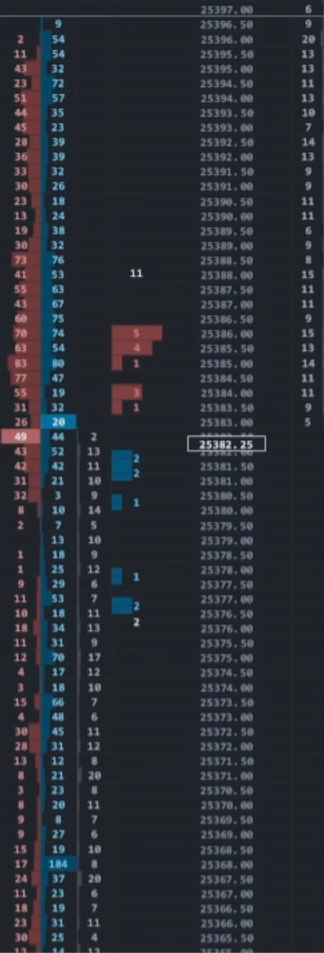

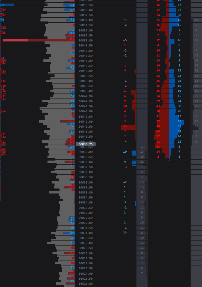

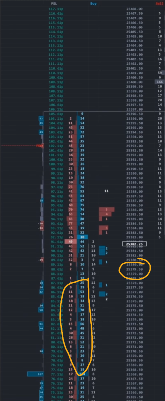

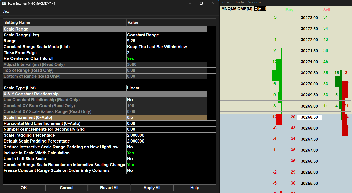

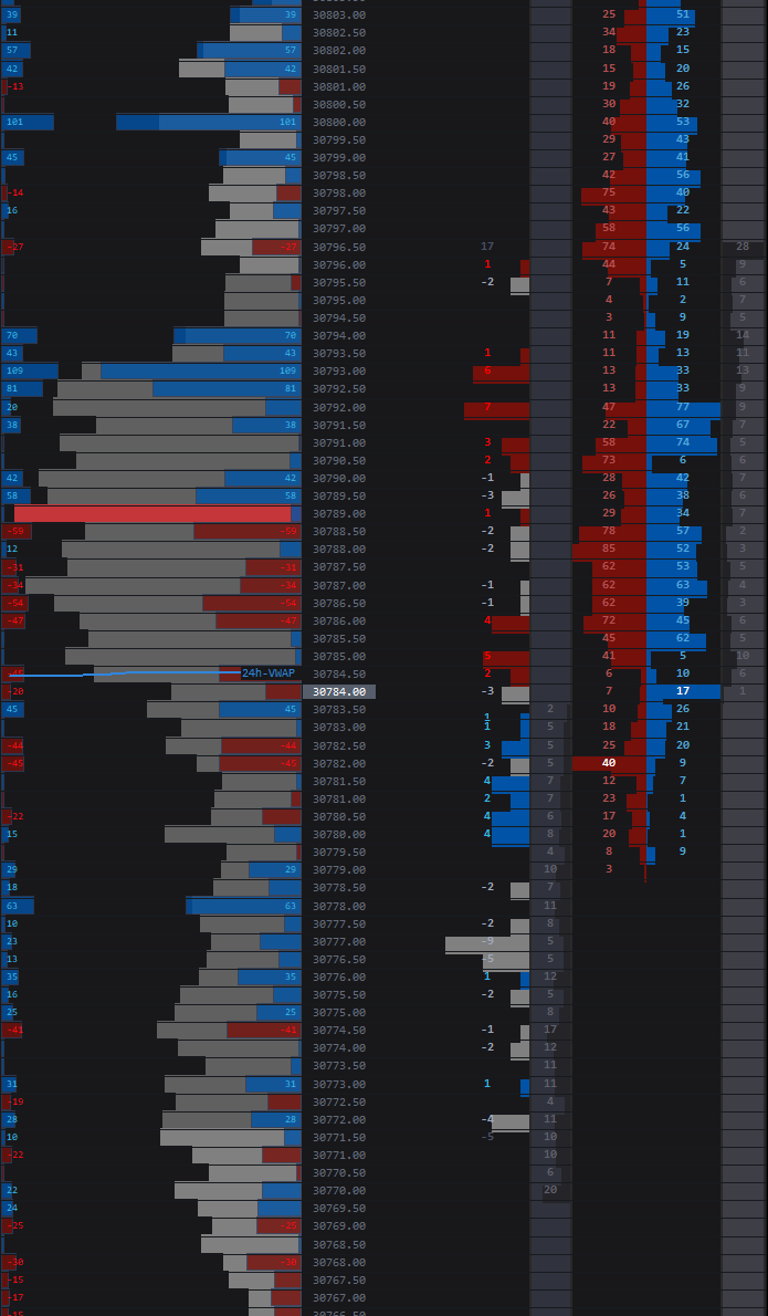

I need help fixing the Current traded volume columns, for my DOM window in sierra chart. I added 2 tick compression, and the only thing that is not quite right is that. It looks as if it was still being cut in the middle of each histogram. Looks like 2 bricks in 1, sometimes due to small volume sizes, you can see a cutout.
Tell me how to fix this please, I went insane trying to find out how. I know for a fact that it can be done, since the ref image im looking at is what I want.
https://www.sierrachart.com/image.php?Image=1779826313621.png

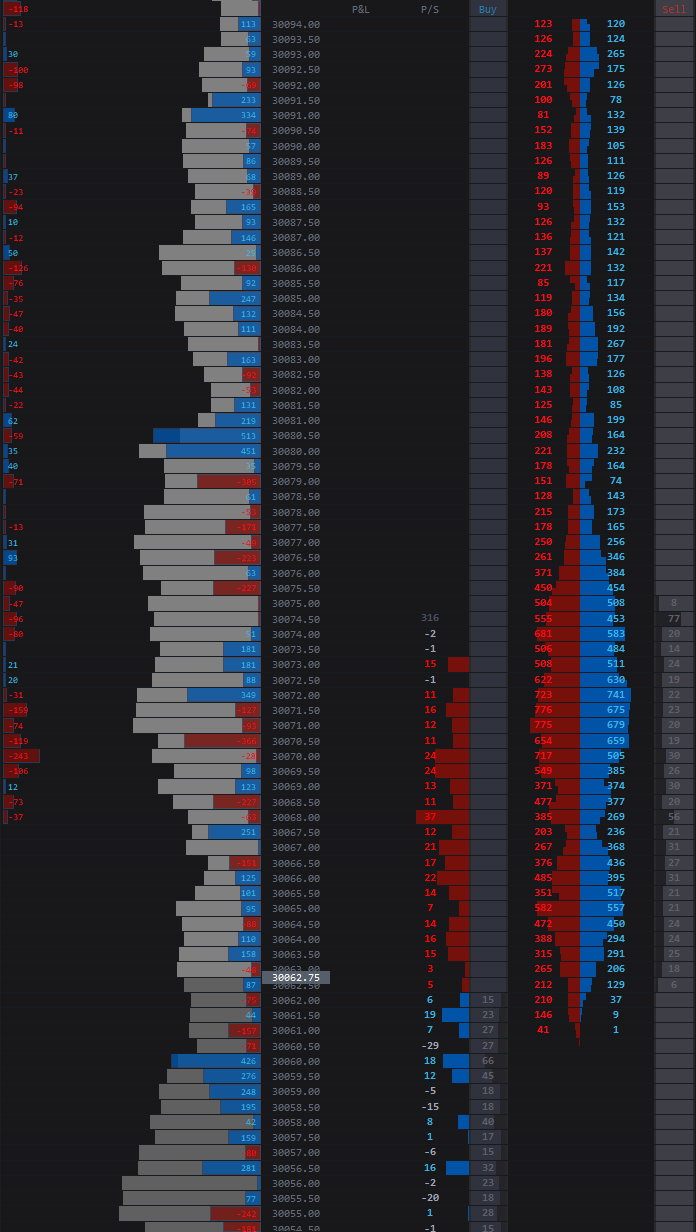

I have attached two images. One, the darker red and blue colors, is mine.
As you can see, (The histogram), is not a single "brick", but it cuts in the middle, as if it were 2 histograms in the same price row.

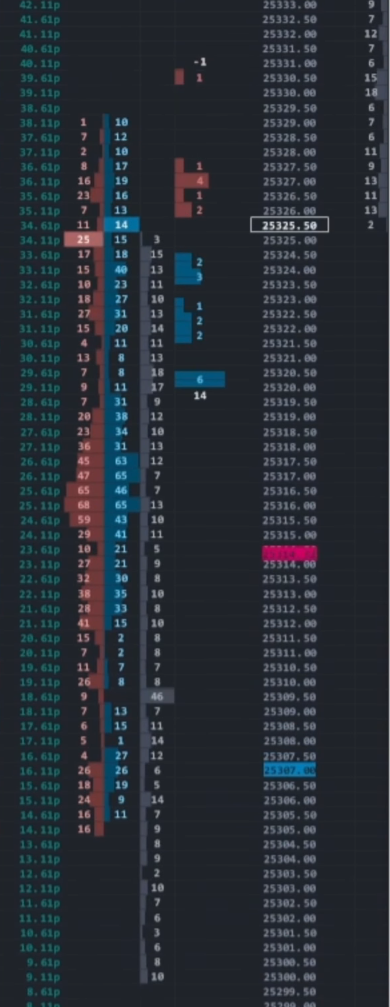

Second image, is the reference. As you can see, the CTV columns have full histograms, and it also has a 2 tick compression.
I hope that cleared it up and that you can help me. Thank you!

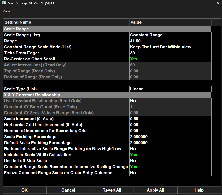

I have attached the chartbook with the DOM only as well as images of my settings just in case it doesn't ship with them.

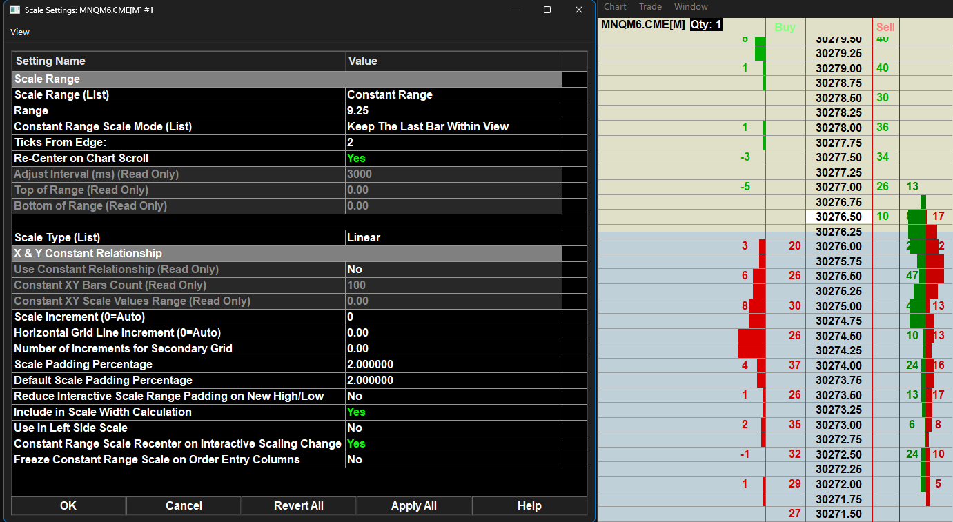

In scale settings for the DOM, I also have "Scale Increment" set to 0.50.

User653730 - Posts: 12
Scale settings img just in case.
Looking forward to your reply :)

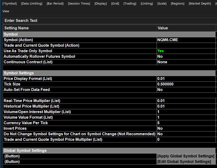

John - SC Support - Posts: 48464
You are setting the "Tick Size" to be 0.5. You should not be doing this. You need to set "Chart >> Chart Settings >> Market Depth >> Market Depth Combine Increment in Ticks" to be "2" and then set "Chart >> Chart Settings >> Market Depth >> Apply Combine Increment in Ticks to Other Market Data Columns" to "Yes".

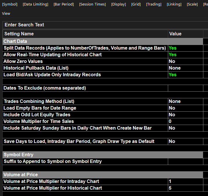

As to the Volume by Price on the Trading DOM, you can change the "Volume at Price Multiplier" for the Trading DOM, which will then be reflected in the Volume at Price study. Refer to the following:
Chart Settings: Volume at Price Multiplier for Historical/Intraday Chart (Chart >> Chart Settings >> Chart Data >> Volume at Price menu)
There have been changes to how the data in the DOM is dealt with, so adjusting the Tick Size will create issues, which is what you were seeing originally. What we have given you above is the correct way to aggregate the data in the DOM and Volume Profile.

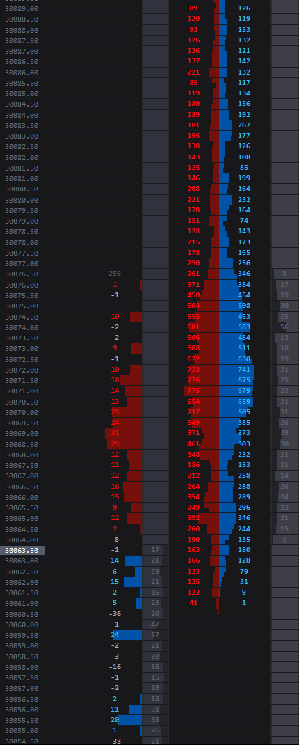

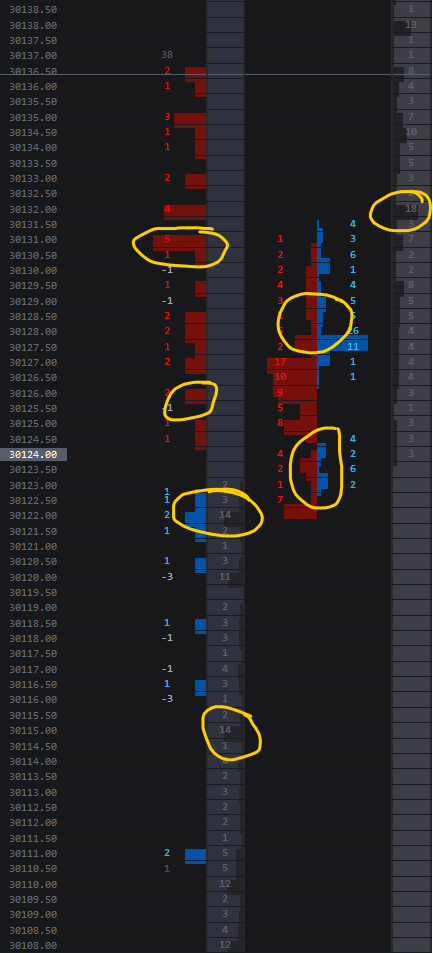

This is how it currently looks with your suggested settings. The horizontal gridlines and the "histogram" or "volume bars" of P/S, bid/ask depth & CTV columns are still not aligned properly.
And the original issue with the "double histogram within one price row" issue is still at hand.
Attached image so it's easier to see.

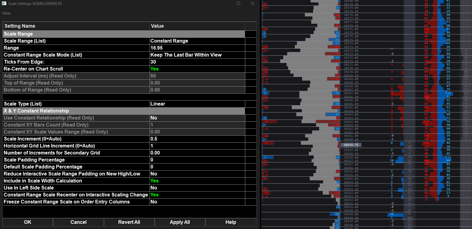

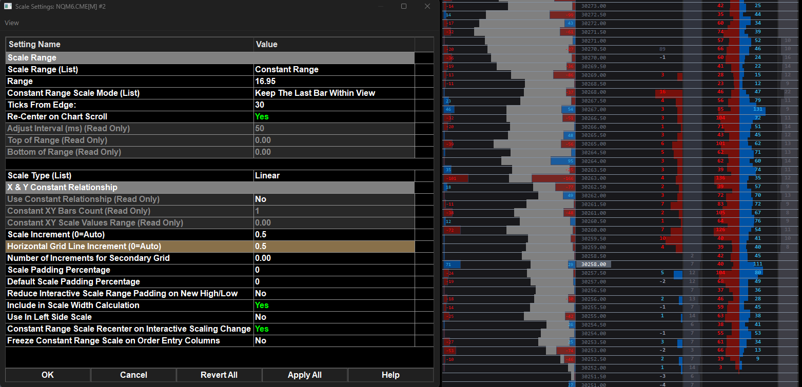

Hello john, changing the setting you mention makes it even worse unfortunately. I have made the horizontal gridlines brighter so you can see the problem.
setting both scale increment and horizontal grid line increment to 0.5, is the closest I've gotten, but they are still not aligned, and the CTV columns are horrible to look at (multiple histograms within the same price row).
imageCaptura de pantalla 2026-05-28 180104.png / V - Attached On 2026-05-28 16:01:14 UTC - Size: 160.62 KB - 139 views

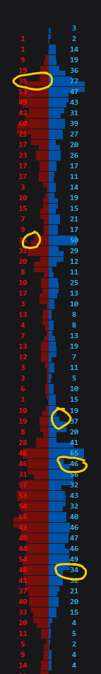

I've done some testing in a brand new DOM, and what I found out is that the issue might come from the scale settings menu. Applying the tick compression like you said (set "Chart >> Chart Settings >> Market Depth >> Market Depth Combine Increment in Ticks" to be "2" and then set "Chart >> Chart Settings >> Market Depth >> Apply Combine Increment in Ticks to Other Market Data Columns" to "Yes"), makes it so that the Data (Numbers for P/S, BID/ask depth/ and CTV) Appears only on the 0.50 and .00 price rows, on the .75 and .25 rows nothing appears. However, the Histograms, still show on every single row.
My question now is, how do I remove VISUALLY, the rows that I don't want to see, without compromising the rest? Because setting the scale increment to 0.5 in scale settings, removes the .25 and .75 levels, but completely messes up everything else.

Note that within scale settings, Scale increment is set to 0.5. If this is not set to 0.5, the dom will still show the .25 and .75 rows.

In the meantime, I just wonder how this user has accomplished what im looking for (attached img). Unfortunately he is quite "famous" and won't reply to a dm asking for .cht or settings.
I can see in his chart, that the histograms and everything are offset by a couple of pixels if you really zoom in, but still, CTV bar is one solid one.

I don't know if you did anything yet, but I managed to have single bar/row volume bars. The only thing that is missing now is the horizontal gridlines to align with everything else at all times (specially the volume bars) and it would be perfect. Thank you for your help!
