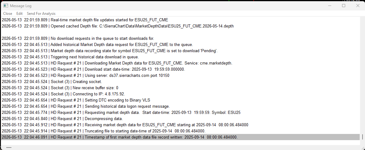

1) I am trying to download Market Depth data for 9/02/2025, but when the download starts, the message log (and .depth files in ...\Data\MarketDepthData) indicate the download is starting from 9/13/2025. This date is not within the range of my chart, which is set to 9/01-9/05/2025. I have a simple chart set up for ESU25_FUT_CME (continuous contract set to None), and I am right-clicking on the bar where I would like to begin the download and selecting "Download Depth Data from Date-Time". I have attached images of the confirmation dialog box and Message Log. I also attempted to download data from an earlier date in Aug 2025, but that download also started from 9/13/2025. Any ideas what might be going on?

1) The first thing to check is the setting for "Global Settings >> Sierra Chart Server Settings >> General >> Maximum Historical Market Depth Days to Download". Make sure this is set high enough to go back to the date you are wanting. Refer to the following:
Sierra Chart Server Settings: Maximum Historical Market Depth Days to Download (Global Settings >> Sierra Chart Server Settings >> General >> General)
Officially, we only have 6 months of market depth data, but we do have some more for some symbols, perhaps up to 1 year. If you are only able to get data back to September 13, 2026, then that is all the data we have.
The data is going to be downloaded from the starting point you define and go forward to the current time. So if either of the above is the case, then it doesn't matter that that specific date is not in your chart, that is just where the data will start to get downloaded from.

drinkcodejava - Posts: 47
Thanks John! Per your suggestion, I got it working by increasing Maximum Historical Market Depth Data Days to Download. It was set to 5, which I believe is the default value. Strange, though, that this worked given that the date that was downloaded (9/13/2025) prior to changing the value was far more than 5 days ago.
