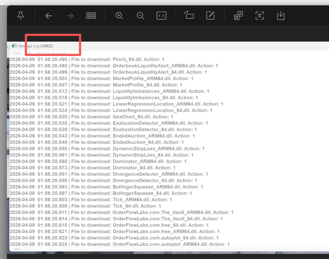

[2026-04-09 02:03:30]
User402726 - Posts: 9
Remaining in this state, I am unable to obtain any useful information
image微信圖片_20250504130432.png / V - Attached On 2026-04-09 02:03:24 UTC - Size: 452.61 KB - 182 views
[2026-04-09 14:23:52]
From Google Translate, the item you highlighted at the top of your Message Log (末响应) means "No Response". We assume this means that your Sierra Chart is in a non-responsive state. We do not know why this would have occurred.
Is this a consistent issue you are having? Is this the problem you are referring to?
What were you doing when this occurred?
