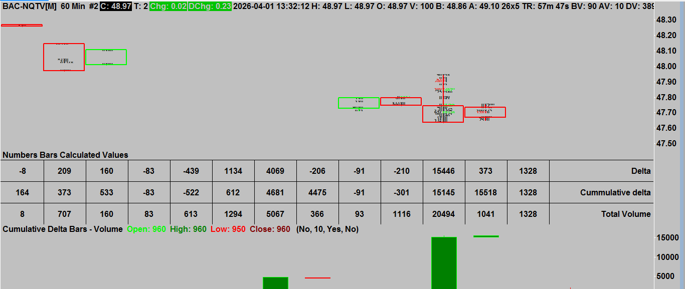

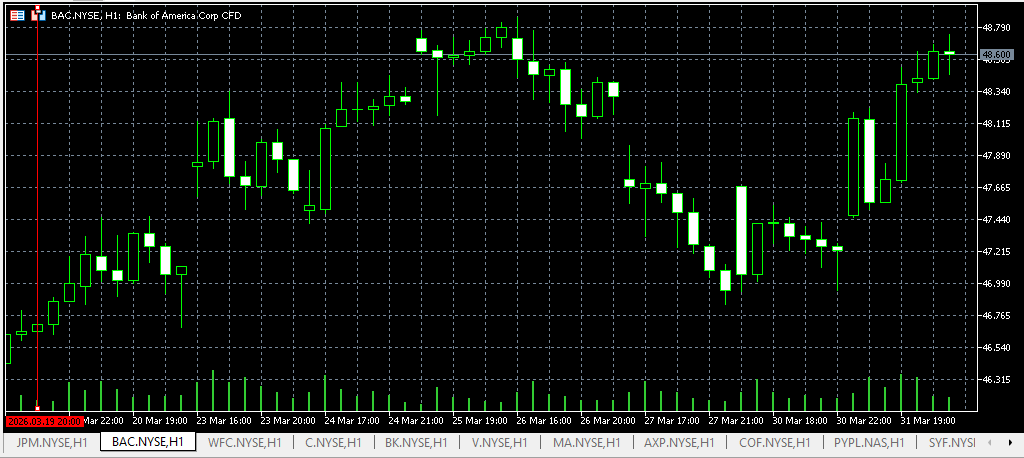

Hello, I am facing an issue with my Sierra Chart software.
I noticed a discrepancy between Sierra Chart (BAC.NQTV) and MT5
I don't think it as to do with my settings because I successfully loaded JPM chart.
imageBAC Sierra Chart.PNG / V - Attached On 2026-04-01 10:30:37 UTC - Size: 36.77 KB - 179 views
imageBAC MT5.PNG / V - Attached On 2026-04-01 10:30:55 UTC - Size: 30.29 KB - 183 views

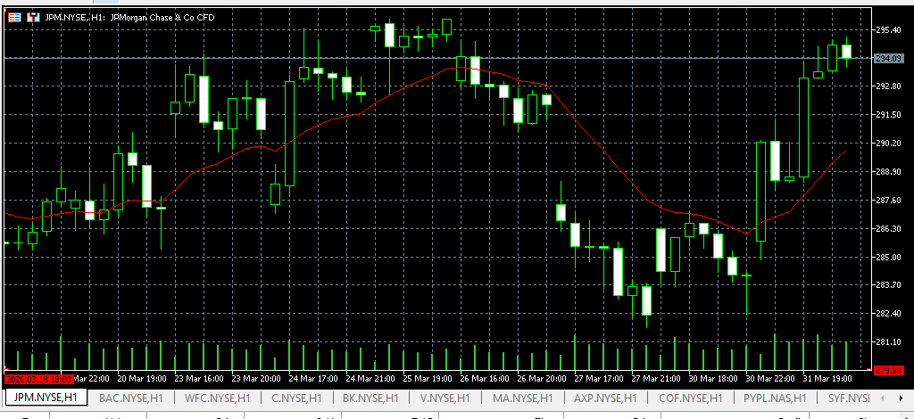

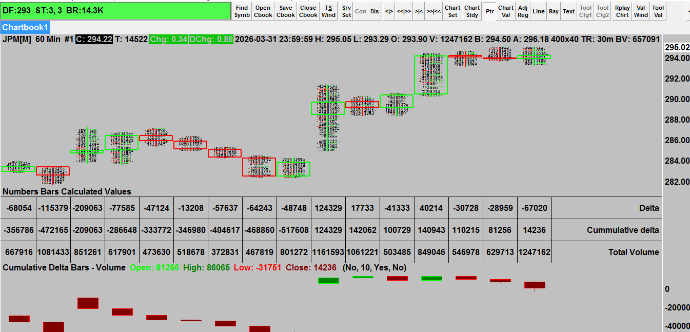

compare the above to the attached JPM charts
imageJPM MT5.PNG / V - Attached On 2026-04-01 10:32:17 UTC - Size: 33.84 KB - 173 views
imageJPM Sierra Chart.PNG / V - Attached On 2026-04-01 10:32:24 UTC - Size: 64.29 KB - 164 views
[2026-04-01 10:49:02]
User301125 - Posts: 4
Upon further analysis, I noticed Sierra Chart BAC is stuck at around 47.60 (the fourth bar) yet the real price according to MT5 is 48.60 (at the end of the 8 bars)

John - SC Support - Posts: 48189
You are looking at the NASDAQ TotalView data (you are using a suffix of -NQTV), which is the trading for just the NASDAQ exchange. Refer to the following:
Denali Exchange Data Feed: Nasdaq TotalView Data Feed Notes
If you want the consolidated tape, then you should enter the symbol as just the main ticker (i.e. BAC) and not use the -NQTV suffix. This will most likely match up with other systems/reported data. Refer to the following:
US Stock/Equities Consolidated Tape Data Feed
Also, we want to point out that you are not setup to get the real-time data for either of these exchanges, so you are getting the Delayed Streaming Data. If this is what you want, then there is nothing you need to do.
Although, we do also want to point out that if you are only wanting the Delayed Streaming Data, then you could be on the "Base Advanced" package instead of the "Integrated Advanced" package and save $10.00 per month. Refer to the information for the packages at the following link:
Description of Service Packages and Pricing: Packages
If you want to change your package, follow these instructions:
Sierra Chart Purchase and License Information: Changing Package
