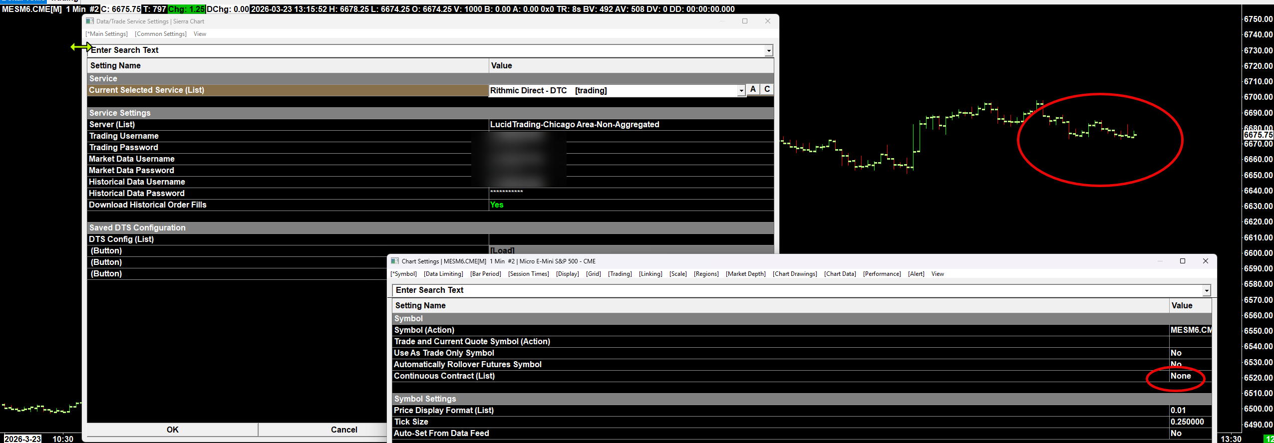

pennydoll9 - Posts: 24
I am only trading CME Futures Contract. MES, MNQ, MGC etc.
This is the error I am seeing in the logs, I don't see any price movements in the chart even though the status bar is green but no price movement
2026-03-23 17:30:02.263 | HD Request # 53 | Error downloading historical Intraday data for ESM6.CME. The network socket has been closed. Retrying download.
2026-03-23 17:30:02.263 | Added historical Intraday data request for ESM6.CME to the queue.
2026-03-23 17:30:02.263 | Triggering next historical data download in queue.
2026-03-23 17:30:02.263 | Historical data download thread signaled to stop.
2026-03-23 17:30:02.263 | HD Request # 53 | Received 0 Intraday data records from 00:00:00.000000 to 00:00:00.000000 (0.0 seconds and wrote 0 records for ESM6.CME
2026-03-23 17:30:02.263 | HD Request # 53 | Completion time: 22s.
2026-03-23 17:35:57.419 | Error getting address info for ds7-2.sierracharts.com. Windows error code 11001: No such host is known. *
2026-03-23 17:35:57.419 | DTC Client socket (2) | CloseSocket call.
2026-03-23 17:35:57.420 | Denali Data Feed | Failed connections: 109
2026-03-23 17:35:57.420 | DTC Client socket (0) | CloseSocket call.
2026-03-23 17:35:57.420 | Denali Data Feed | Disconnected from the server.
2026-03-23 17:35:57.420 | Denali Data Feed | Data feed disconnected. Will reconnect in 3 seconds.
2026-03-23 17:36:00.424 | Denali Data Feed | Connecting to the server ds28.sierracharts.com. Port 443
imagenopricemove.png / V - Attached On 2026-03-23 17:34:37 UTC - Size: 137.44 KB - 143 views
