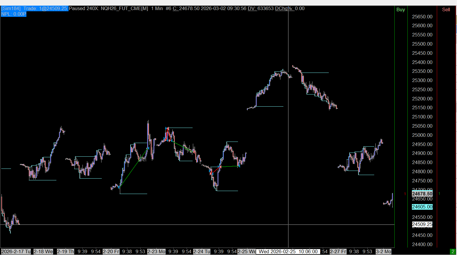

For some weird reason, My algo has not been able to open trades via market replays or via live forward testing since 2/25/26. Algo opens trades fine via Replays on NQH26 from 1/1/2025 until 2/24/26 and then does not open any trades from 2/25/26. Chart is able to load the data from 2/25 until today so data feed seems to be working fine. Market replay also works fine but algo just won't open any trades. I switch to NQM26 symbol and same issue with this symbol also.
I am using a simple M1 chart during US session with Automatic rollover futures symbol = Yes and Continuous Contract = Volume Based Rollover.

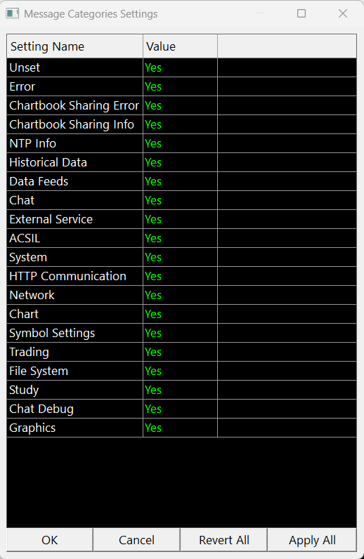

If your Trade Service Log is blank, then the first thing is to update to the current release. There were a few releases in which that window and the Message Log would be empty. Refer to the following for how to update:
Then go to "Global Settings >> Message Categories" and set the items you want to see in your logs to "Yes". We recommend setting them all to "Yes" to start with, then you can remove items you do not want later.

Thanks John. This cannot be related to algo or custom studies. Just created a brand new collection with delivered studies... very simple.. buy on session high, sell on session low. runs fine in replay until 2/24/26 and stops working from 2/25/26 onwards. I also tried with continuous contract and automatic rollover disabled...same issue.
I really want to avoid fast update as I have backtests in numerous sim accounts to compare with forward testing results.
I am currently on 2870 version. Same result on ESH26 also. It looks like something changed on 2/25.

We do not see any issues with the studies on the current day (March 9, 2026). There is no reason for there to be any issue with the data.
The one thing we want to point out, although we think this is on purpose, is that these studies will only work during the 30 minutes between 09:30 and 10:00.
If you continue to have an issue, then we recommend breaking down the situation into parts, and using multiple copies of the "Spreadsheet Formula" to evaluate each piece as you step through the replay and see why you are not getting what you expect.

Go to "Global Settings >> Message Categories" and set the items you want to see in your logs to "Yes". We recommend setting them all to "Yes" to start with, then you can remove items you do not want later.
[2026-03-11 03:31:47]
User61168 - Posts: 491
Thanks John. Everything was already set to "Yes" in Message Categories window and Trade Service log continues to remain blank.

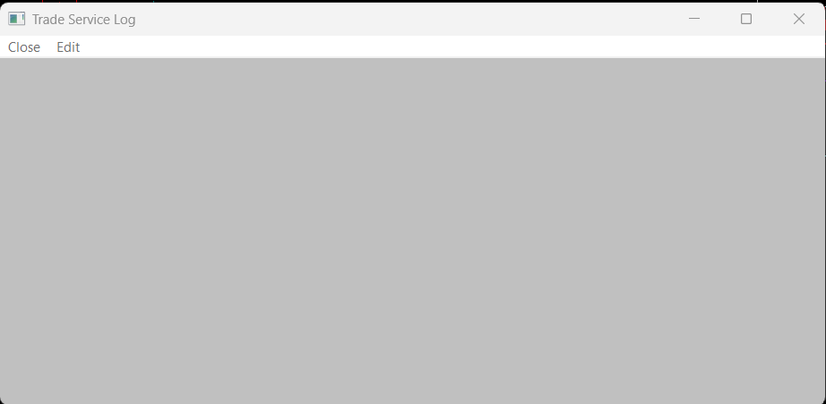

Please get us an image of your Trade Service Log. Even a blank one. There are some items we want to see on that window.
[2026-03-13 03:56:52]
Please see attached.

Make sure this command is unchecked on the Window menu:
Window, CB and CW Menus: Disable Visible Message Logging (Window)
Also check these color settings:
Graphics Settings: Setting the Background Color, Text Color, and Font for Text Only Windows
Date Time Of Last Edit: 2026-03-14 08:56:46
[2026-03-22 06:38:41]
Regarding trade service log, Unchecked the "Disable visible message log" and I am now able to see messages in trade service log.
