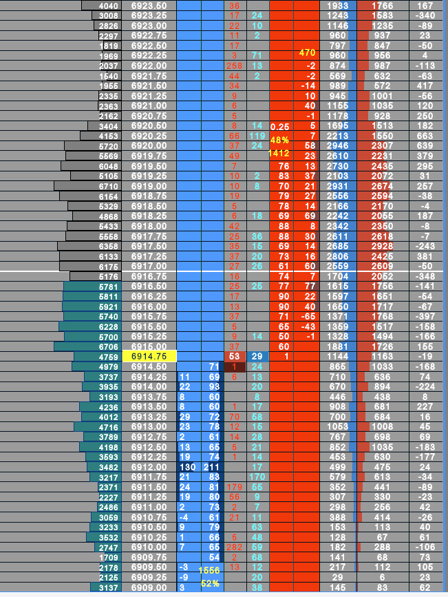

Good morning, I need to apply the last column you see on the right of the photo (I think it's the delta) to my DOM. It's the bid minus ask orders. If I go to the settings to add columns to the DOM, I can't find it. I only have "current trade ask volume" and "current trade bid volume," which I used to create the split volume profile. The photo shows the second-to-last column from the right. Thanks.

Hi, is that screenshot from Sierra Chart or from another platform?
As far as I know, the Sierra Chart DOM doesn't have a built-in column that shows the Delta (Ask Volume minus Bid Volume) per price level. The columns available are things like Current Traded Bid Volume and Current Traded Ask Volume separately, but not a calculated difference column.
If you're looking for Delta per price level, the Numbers Bars study (Footprint chart) can do that, it's a chart-based study, not a DOM feature. In the study settings, set the text type to "Ask Vol Bid Vol Difference". Documentation: Numbers Bars (see "Numbers Bars Text Types")
Hope that helps point you in the right direction!

User931951 - Posts: 79
Hi, thanks for the reply! The chart in the photo is a jigsaw, but I know it can also be done with Sierra Chart on the DOM, but I don't know how. I knew about the delta on the footprint, but I need it on DOM. Thanks a lot anyway.

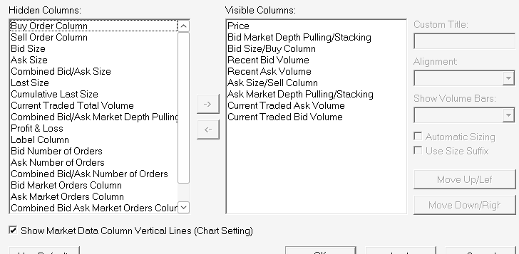

Hi John, I don't see "Ask currently traded less bid volume"
- Diagonal ask currently traded less bid volume in the window you mentioned. Maybe because I need to update Sierra?

[2026-02-25 18:46:01]
We are not seeing either of the entries, therefore you are definitely on a release that does not have these in them. Follow these instructions to update to the latest release:

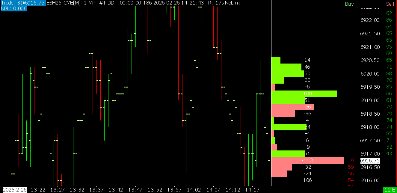

[2026-02-26 20:25:11]
We do not know what you are referring to in terms of the "delta box".
In the attached image, we show the "Current Traded Ask Minus Bid Volume" column on the left side of the DOM. In it we set the colors for the Volume Bars such that positive values are green and negative colors are red (well, maybe reddish-orangish). If this is what you are referring to, then the Volume Bars colors are controlled by these settings in Graphics Settings:
- Chart DOM Current Traded Ask Volume Bid Volume Difference Positive Volume Bar
- Chart DOM Current Traded Ask Volume Bid Volume Difference Negative Volume Bar
Refer to the following and the item below it:
https://www.sierrachart.com/index.php?page=doc/ChartTradingCustomizingGraphics.php#ChartDOMCurrentTradedAskVolumeBidVolumeDifferencePositiveVolumeBar
Keep in mind that there are separate coloring options for a Trade DOM. Refer to the following and the one below it:
https://www.sierrachart.com/index.php?page=doc/ChartTradingCustomizingGraphics.php#TradeDOMCurrentTradedAskVolumeBidVolumeDifferencePositiveVolumeBar
Date Time Of Last Edit: 2026-02-26 20:25:28
imageESH26-CME[M] 1 Min #1 2026-02-26 14~21~43.281.png / V - Attached On 2026-02-26 20:25:22 UTC - Size: 40.99 KB - 227 views

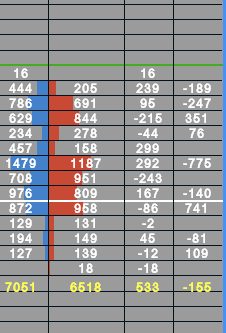

[2026-02-26 20:33:57]
Maybe I'm explaining myself poorly, I apologize. Look at the attached image, the last column on the right, which is "current traded ask minus bid volume." I'd like the background of the negative numbers to be red, while the background of the positive numbers is blue. Right now, it's all gray.
imageScreenshot 2026-02-26 alle 21.30.38.png / V - Attached On 2026-02-26 20:33:48 UTC - Size: 186.7 KB - 246 views
[2026-02-26 21:43:14]
mayerde - Posts: 4
I checked Graphics Settings, there's only one Background entry for the entire delta column, not split into Positive/Negative like the text colors are.
[2026-02-27 15:25:28]
This is correct, there is no control for different backgrounds based on the value of the numbers. There is just the one background coloring option.
