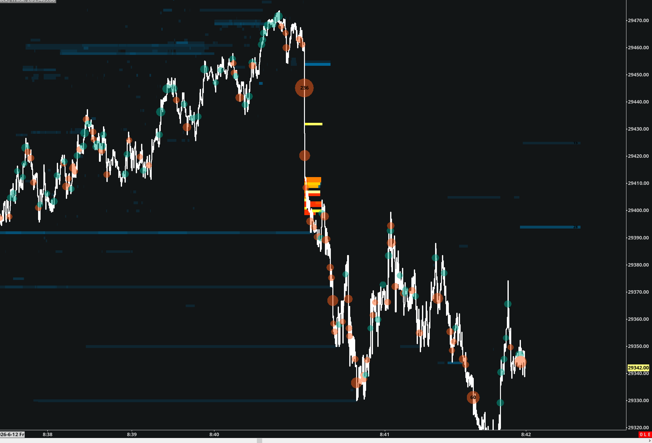

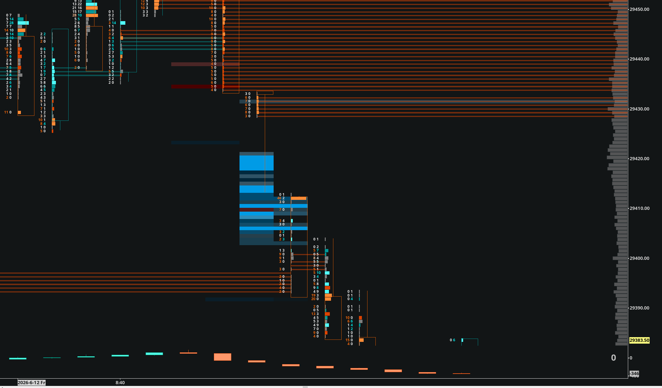

Denali Date freeze for around 15 seconds on the current headline release at 08:41 Central. AFter that complete disconnect and reconnect at 08:44 central.

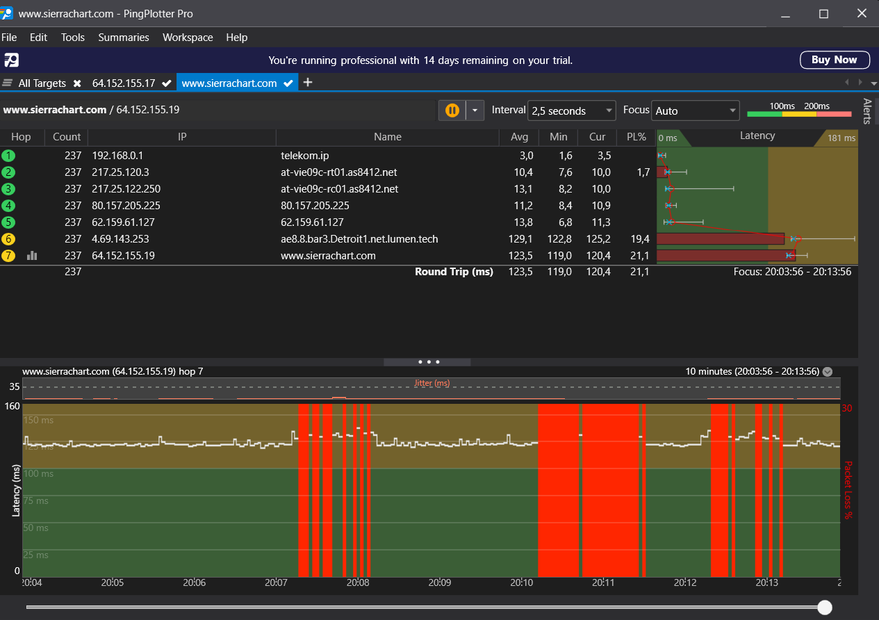

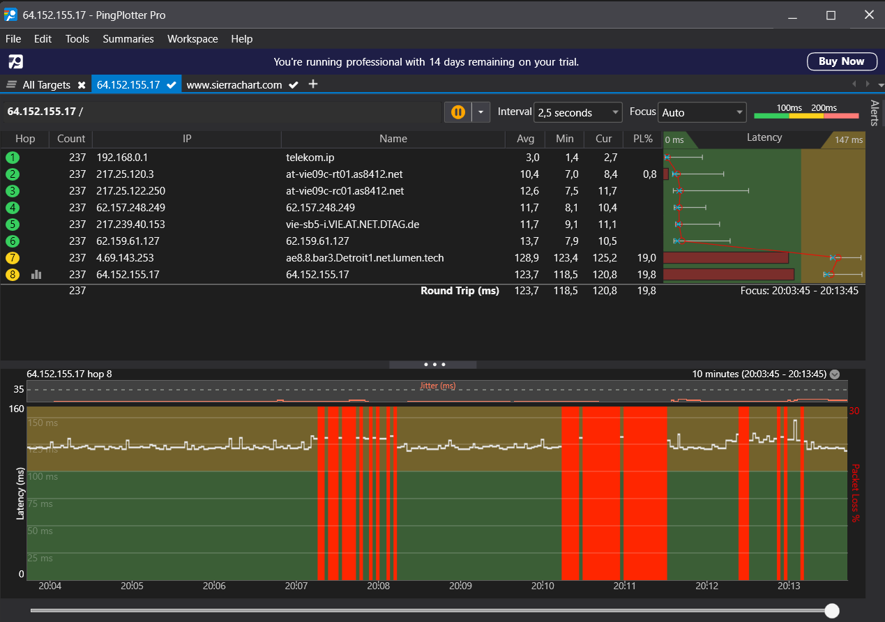

[2026-06-12 14:41:07]
Sierra_Chart Engineering - Posts: 25362
We did see a disconnect as well.
We do not know the cause at this time.
We have 100% dedicated network switches/routers, and dedicated network connections, into our servers and networks where we also saw a disconnect. And there is no one who uses these connections other than us. There is next to no bandwidth even being utilized by us.
So this tells us, being we saw a disconnect there that the issue was with the ISP. But we have seen disconnects across the ISPs. Both from the data center connections and from Cogent. Cogent is not used by our users though.
It is very hard when there are transient problems like this for us to know where the problem is, but it looks apparent this was an issue with more than one ISP.
If we ourselves losing a connection on a completely dedicated and isolated network straight into the back of dedicated connect points into servers which are not even serving any market data to users, not sure what we can do about this.
Our systems are located in the same building as the Detroit Internet exchange:
https://www.detroitix.com/ (Actually as we look at this page, we are not sure it is actually very relevant within this context because we do not see, ISPs like Lumen, Zayo, AT&T, Cogent, and numerous others listed there but we know that there is peering between them in the building)
We utilize connections which are peering with numerous ISPs in the building.
Date Time Of Last Edit: 2026-06-12 21:15:01

nosast - Posts: 324
Not sure if the disconnect was related to the freeze a few mins prior. I very rarely have feed disconnects with Denali but the data freeze is a lot more often during this headline tape bombs where the market is flooded with transactions. Feels like there are too many message and too short of a timespan to be delivered. This bottleneck usually resolves after a few seconds (10-15).
I attached some screenshots from the time of the disconnect. It's also strange how MDH was shown.
Maybe it helps...

Today there is no doubt, 100% certainty, the issue was with Internet service providers. We are not going to be spending any time on this, other than to let one of these providers know.
But they probably will deny there was anything wrong. As is usually the case.
There is nothing we can do about that. It simply just will happen from time to time.
All of our systems were running fine and our own networks were all running fine. No problems at all. We did not lose any CME packets at all. Exactly 0%.

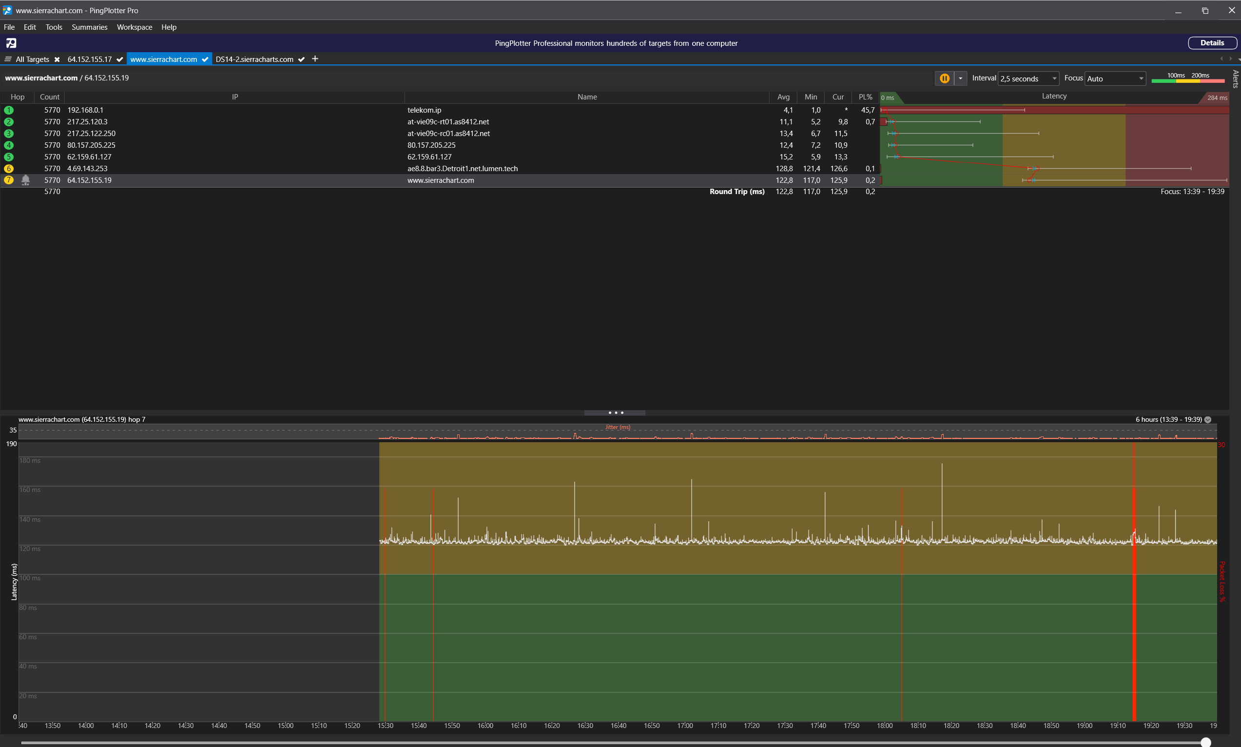

One of our main ISP providers, 123 Net in Michigan, is having serious problems at this time.
The problem looks to be resolved now. We have also started a ticket with them anyway about the issues today.
