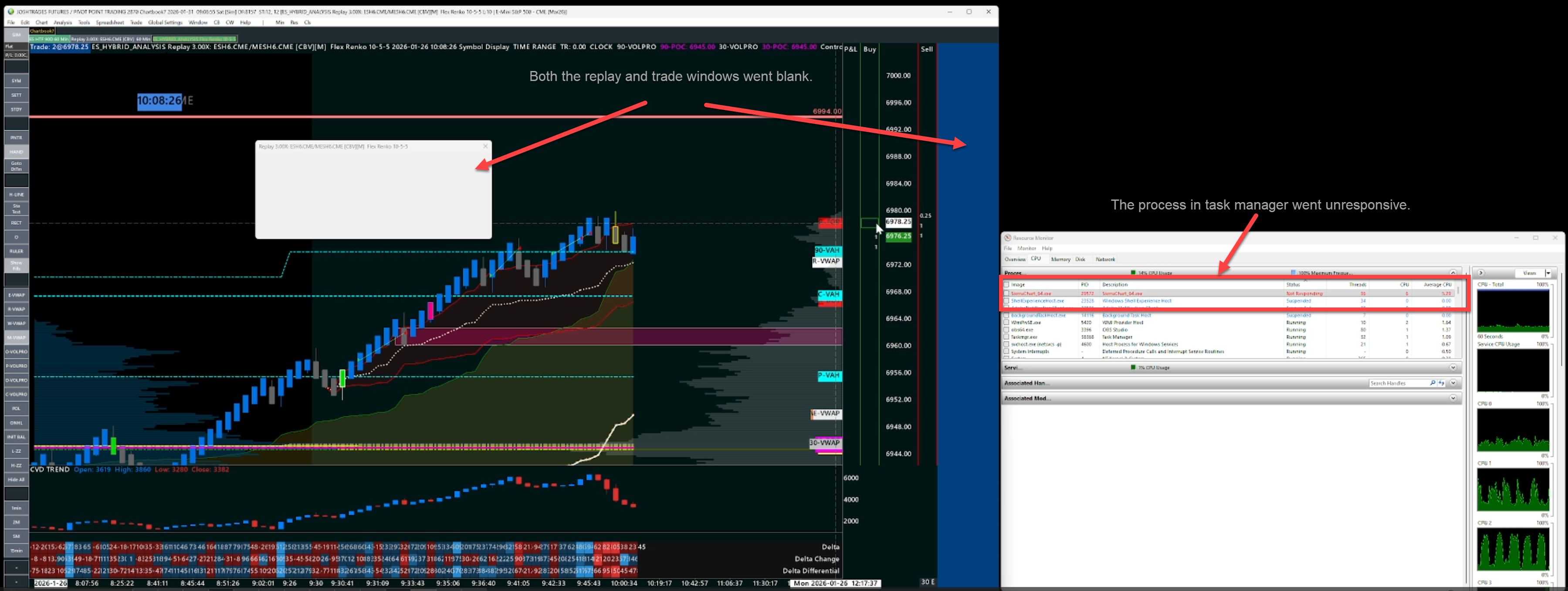

| [2026-01-31 14:24:28] |
| LongShortz - Posts: 53 |
So in doing further testing, I am still seeing some freeze ups. I'm attaching a screenshot of my chart and my task manager. You'll see that when the issue occurs, the SC process goes unresponsive in task manager, and the replay and order windows go blank or disappear altogether. This lasts for a couple/few seconds and then recover on their own. I have what I consider to be a lot of studies on my chart. There are 28 items in total including 5 that reference a spreadsheet study, multiple VWAPs, multiple volume profiles, and a few other benign items like watermarks and a clock. I've change the timers to Sierra Chart and set the execution chart to 10ms while other charts are at 250ms. Do you believe these settings could be causing the freeze ups? If so, what adjustments might you recommend? |

| Sierra_Chart Engineering - Posts: 25458 |
We apologize for the delay on this. Really something like this you have to go through a process of elimination. For example, removing studies from a chart one by one to see which one might be causing the problem. And closing, charts to see if a particular chart is the problem. All the known items that can cause high CPU usage are described here: High CPU Usage | Inactive User Interface | Poor Performance | Long Time to Load Chart Data | Charts Reloading Often Generally we would believe the issue would be with the Spreadsheet study. So maybe reducing the amount of data in the Spreadsheet Sheets. Sierra Chart Support - Engineering Level Your definitive source for support. Other responses are from users. Try to keep your questions brief and to the point. Be aware of support policy: https://www.sierrachart.com/index.php?l=PostingInformation.php#GeneralInformation For the most reliable, advanced, and zero cost futures order routing, use the Teton service: Sierra Chart Teton Futures Order Routing Date Time Of Last Edit: 2026-02-04 19:19:57
