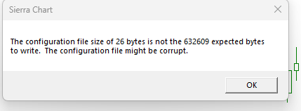

I've been getting config file errors for some reasons so maybe its related.
imageSierra Chart Config Fille Error.png / V - Attached On 2026-02-07 11:08:53 UTC - Size: 6.95 KB - 141 views

Sierra_Chart Engineering - Posts: 25485
Yes that error may be related. This might be related to a memory corruption. That should never be happening.
Run Sierra Chart in safe mode:
Sierra Chart - Software Login Instructions: Using Safe Mode
Restore a global configuration file:
Resetting Sierra Chart to a Default State / Restoring Backup Global Configuration File: Restoring Backup Global Configuration File
