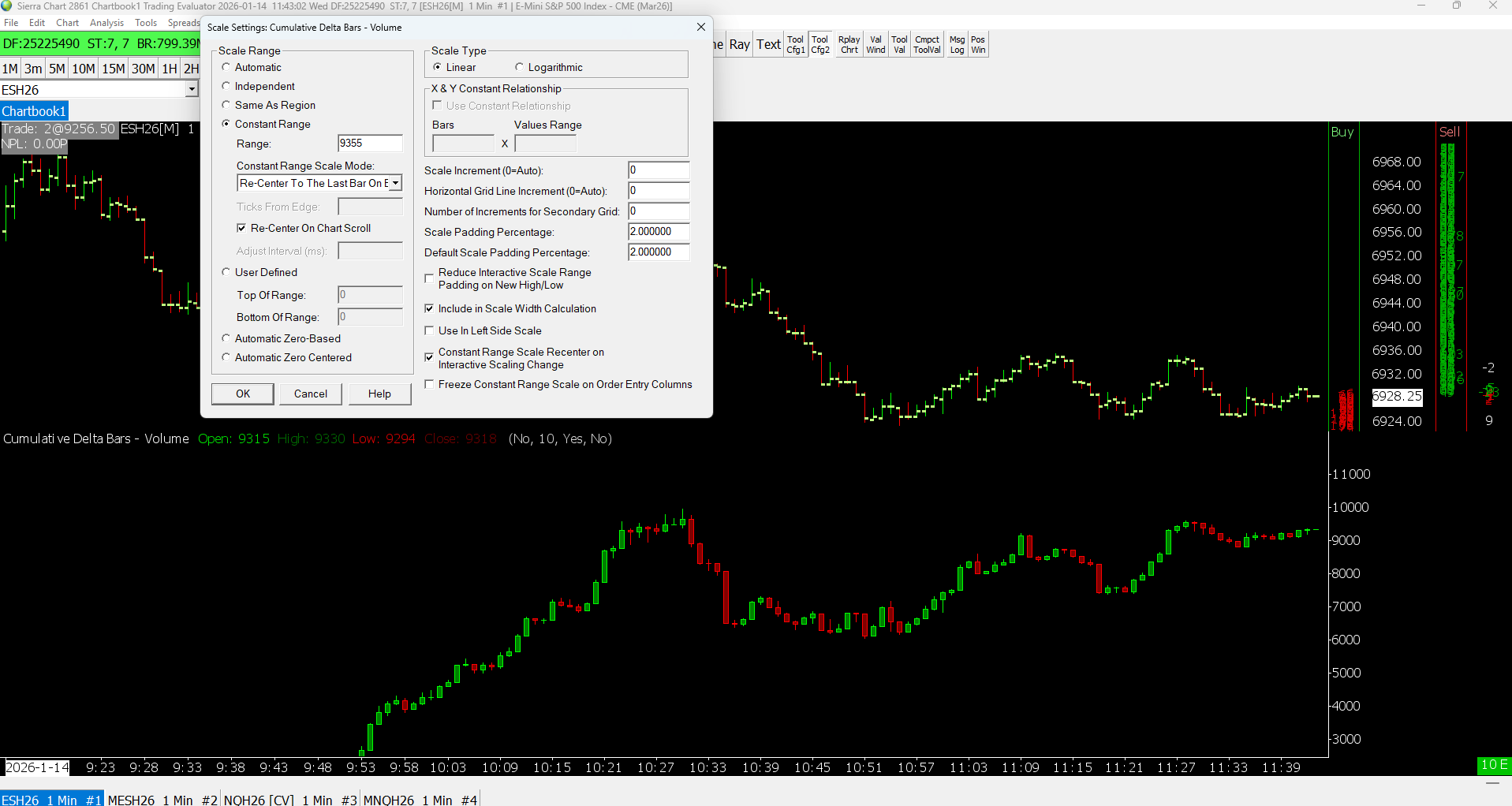

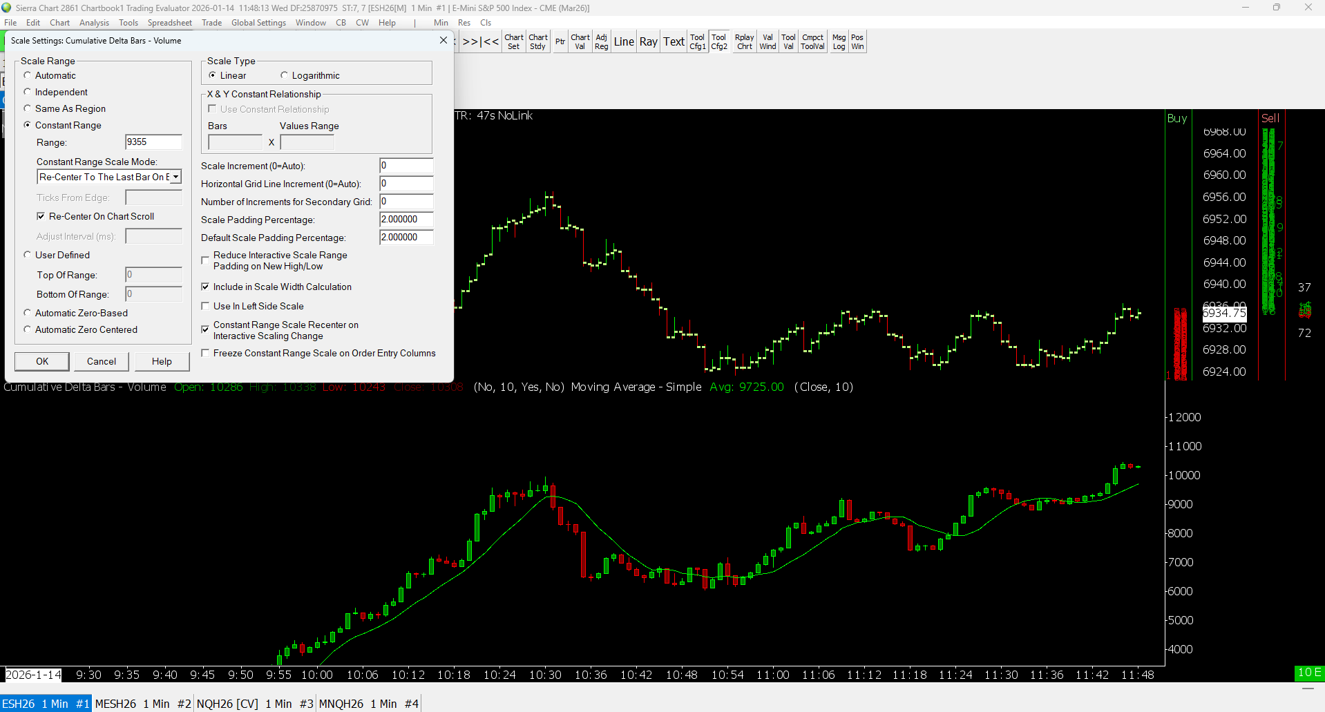

We went through a test of this when you first posted to ensure that something had not changed that we were not aware of, and it definitely worked as we stated. When you added the Moving Average, it did not take over the "ownership" of the scale. Both the Moving Average and the CVD should have contributed towards the actual scaling that was being used, but within the confines of the "Constant Range" that you had setup.
Attached are two images in which we follow the process you went through. The one named "CVD.png" is the Cumulative Delta - Volume, setup with a Constant Range scale. The one named "CVDWithMA.png" is the CVD with the Moving Average - Simple added to it without changing the scaling for this study, so the scale for the Moving Average is "Automatic".
As you can see, the scaling hasn't change at all and is set to "Constant Range".
This should be what you are seeing. If not, then there must be something about the way you are adding these, or adjusting the scale to be creating something different. Are you using a Left Side Scale by any chance?
