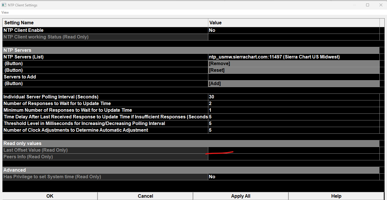

ss1776 - Posts: 29
I have done everthing as per instructions why does my Last offest not say anything. MY computer clock and real time is off by 3 mins. see image
imageScreenshot 2025-12-16 092833.png / V - Attached On 2025-12-16 14:27:00 UTC - Size: 55.17 KB - 127 views
[2025-12-16 15:27:29]
John - SC Support - Posts: 48555
You do not have the NTP enabled. You need to set the option at the very top to "Yes".

Sierra_Chart Engineering - Posts: 25432
In your case NTP is not going to work because Sierra Chart does not have the privilege to change the clock. To solve this, refer to:
Network Time Protocol Client: Operating System Privileges for Setting Time
