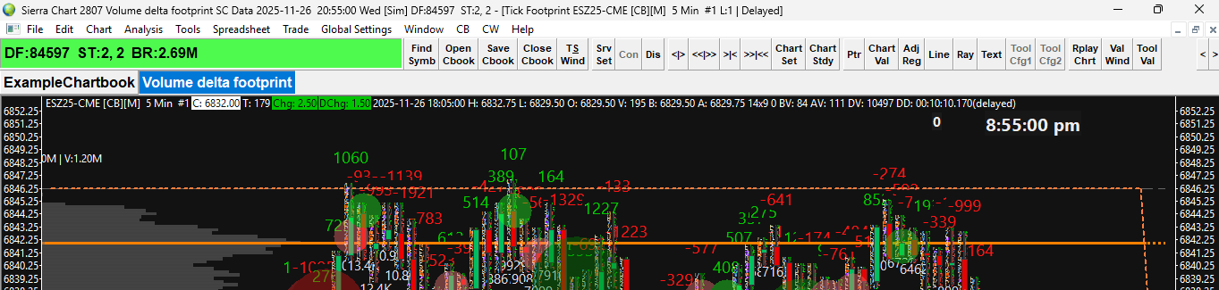

Good evening my sierra chart is delayed by 10min. When I look at my trading view and ninja trader charts they are identical. But my sierra chart says delayed at the top. I followed the instructions to best of my ability, but I am unsure if I need to pay more money or if I just need to play around with the settings and get it done. I would appreciate some help, I need it.
imageScreenshot 2025-11-26 205543.png / V - Attached On 2025-11-27 02:02:09 UTC - Size: 100.23 KB - 139 views

Do you have a live account? You need to connect to that once a month.

All of the settings are correct. The problem relates to what is explained here:
The reason you are not getting real-time data from the Denali Data Feed, and historical data from the Denali Data Feed in the case of when using an external Trading service (Rithmic, CQG, Interactive Brokers), from the CME Group of exchanges is that you activated the *Non-Professional* exchange fees. However, you have not verified in the last month that you have a live, funded, futures trading account, which the CME needs in order to allow you data at the lower priced fees.
Refer to the "Understanding and Accessing Data From the CME, CBOT, NYMEX, COMEX Exchanges" section here:
Real-Time Exchange Data Feeds Available From Sierra Chart: Understanding and Accessing Data From the CME, CBOT, NYMEX, COMEX Exchanges
Rithmic paper trading or trading evaluator accounts are not considered a live funded futures trading account.
Refer to the following for instructions on how to connect once a month to your *live funded* trading account to qualify for the lower-priced exchange fees:
If you do not have a funded trading account or one with a supported Trading service, then refer to this solution:
Easy Solution to CME Funded Trading Account Requirement
Consider the above solution to avoid this problem in the future.
