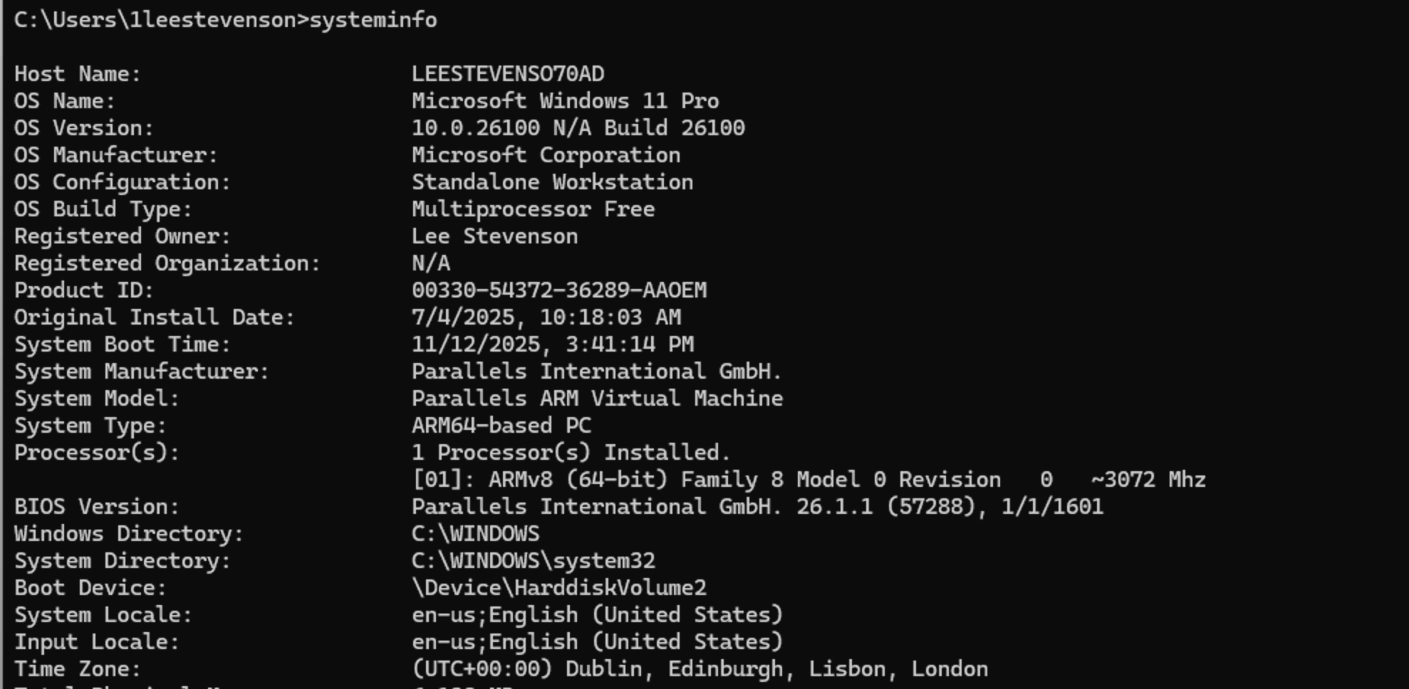

Sierra Chart (64-bit) won’t open — process runs in Task Manager but no window appears (Windows 11 on Parallels)
Hello Sierra Chart Support,
I’m experiencing a startup issue where **SierraChart_64.exe appears in Task Manager but the application window never opens**. No errors are displayed — the process just runs silently in the background.
### Environment
* **Hardware:** Apple iMac (M4, 10-core GPU)
* **Virtualization:** Parallels Desktop 19
* **Guest OS:** Windows 11 ARM (fully updated)

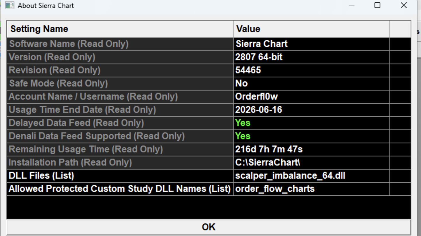

* **Sierra Chart Version:** [2807 64 bit]
* **Installation Path:** `C:\Sierra\`
* **Data Feed:** sierra

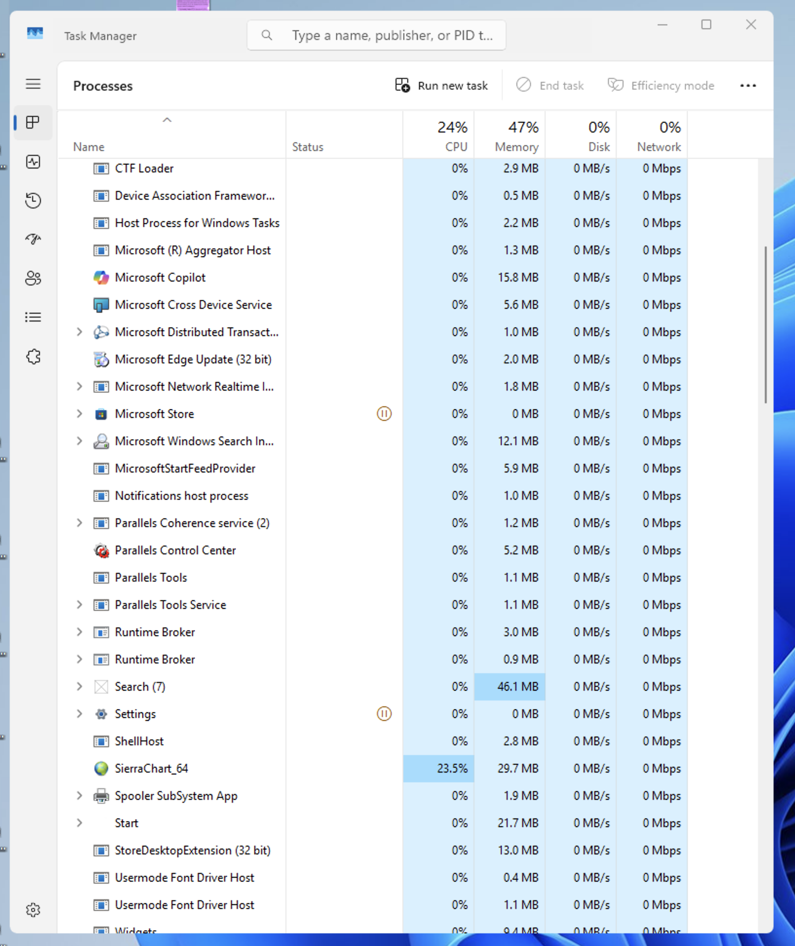

When I start Sierra:
* The process (`SierraChart_64.exe`) appears in Task Manager.
* CPU usage idles between 22%.
* No visible window or UI ever appears.
* The process must be ended manually intask manager.
* The ARM version will open but that version doesn't show the volume from the chartbooks and studies we use on standard 64 bit version
