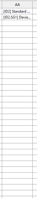

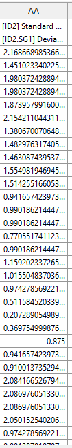

[2025-11-08 20:30:30]
User411320 - Posts: 379
John,
attached are before and after photos. The picture with values is before any changes. The picture without values is after changing the length of standard deviation. During market hours, whenever a new bar is formed it does the same and I have to recalculate all values.
imageScreenshot 2025-11-08 152715.png / V - Attached On 2025-11-08 20:30:15 UTC - Size: 3.25 KB - 139 views
imageScreenshot 2025-11-08 152646.png / V - Attached On 2025-11-08 20:30:22 UTC - Size: 12.15 KB - 179 views
[2025-11-10 15:05:44]
John - SC Support - Posts: 48143
Please get us that chart and spreadsheet file. Follow these instructions to get us the chart itself:
And then follow these instructions to get us the spreadsheet file. The file extension for the spreadsheet is .scss:

[2025-11-10 20:29:45]
You have a circular reference occurring. You are taking the data from Cell K, then having a study doing a Standard Deviation on it, and then looking for that data back in the spreadsheet and then manipulating it.
Do not use the "Standard Deviation" study, rather use one of the "STDEV()" functions in the spreadsheet itself. Refer to the following:
https://www.sierrachart.com/index.php?page=doc/SpreadsheetFunctions.html#STDEV_Function
