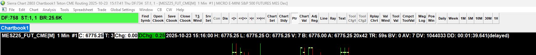

Message log is empty. here is a screenshot of where I'm seeing delayed, and the time on the feed is a couple of minutes behind real time. I've uploaded a screenshot

To fix the Message Log select "Global Settings >> Message Categories" and change everything in there to "Yes". There was an issue with a previous release that caused this to occur.
The delay is showing as 1 minute 39.641 seconds. This is not a real delay in the data - it is caused by a difference between the clock on your computer and the clock of the exchange. Refer to the following for a way to synchronize your computer clock to the standard so you would remove this issue:
Network Time Protocol Client
If you were actually getting delayed streaming data, then it would show a delay of 10 minutes and 10 seconds (00:10:10.000) or greater (including the time offset of your computer).
But, it should not be stating "Delayed" in that field with a 00:01:39.641 delay. We will check on why this is occurring.

Make sure your computer clock is set accurately:
Incorrect Date and/or Time Display, Missing Historical Intraday Data, Chart Not Updating
