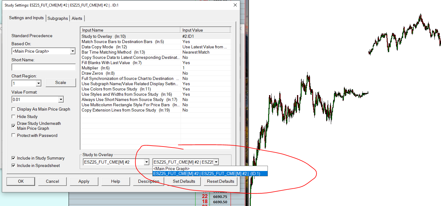

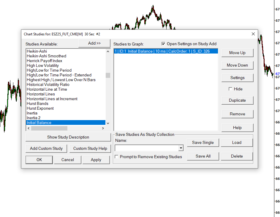

I am trying to do a simple study overlay, as you will see in the pictures, the study of initial balance is not showing within the DOM study setting to overlay this.
any suggestions?

The chartbook you sent us only has 2 Trading DOMs in it. There is no chart that contains the Initial Balance study.
Also, the Trading DOM that has the Study/Price Overlay is setup to overlay the Study/Price Overlay itself, which, of course, is not possible.
