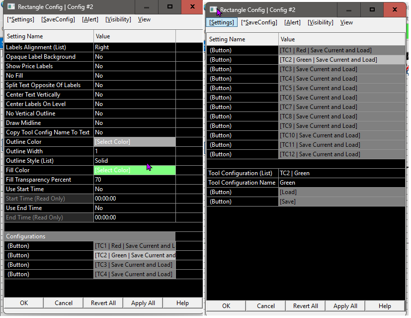

Hello SC support team,
I use 2 charts, same symbol, different timeframe.
On both charts I use different control bars.
Each control bar has option to draw rectangle.
Aim is that when I select rectangle from one chart I get the drawing with red filling and when I use rectangle for another chart I get the drawing with green filling.
I saved two configurations for rectangle but I am unable to assign tool config TC1 to control bar 1 and TC2 to control bar 2.
I dont see any custom names of tool configuration under Tools->Current tool config.
Can I kinldy ask to assist? This is not intuitive to me...
Thanks.

[2025-10-07 14:28:28]
If you have the configurations setup as you want and those are working properly (i.e. TC1 gives you a Red Rectangle, and TC2 gives you a Green Rectangle) then it is just a matter of assigning those particular tool configurations to a control bar button for the different control bars. This is done by following these instructions:
Chart Drawing Tools: Creating Control Bar Buttons which Select Drawing Tool and Drawing Tool Configuration in One Step

User308424 - Posts: 78
Hi John, thanks for the answer.
Seem copying control bars was the issue.
Now all is fine. Thanks very much for the help!
