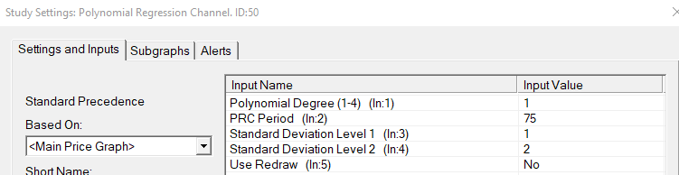

User411320 - Posts: 379
by selecting "No" for Use Redraw (In:5), will this stop the indicator from repainting ?
imageScreenshot 2025-10-03 112436.png / V - Attached On 2025-10-03 15:24:57 UTC - Size: 15.86 KB - 230 views
[2025-10-03 16:25:42]
Since that is not one of our studies, we do not know. We supply the User Contributed Studies without any support for them.
We also do not appear to have the source code for this, so you can not look to see what it does.

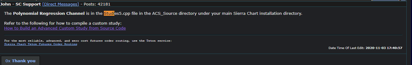

[2025-10-03 16:53:03]
Possibly - probably. Where did you find it? I did not see the "Polynomial Regression Analysis" listed in the list of contributed studies code at the following link (but I did not look into every file):
User Contributed Advanced Custom Study System Source Code

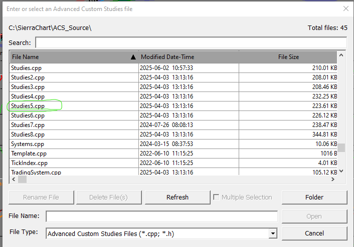

[2025-10-03 16:59:42]
Attached are images where I found it
imageScreenshot 2025-10-03 125541.png / V - Attached On 2025-10-03 16:59:14 UTC - Size: 35.89 KB - 180 views
imageScreenshot 2025-10-03 125825.png / V - Attached On 2025-10-03 16:59:20 UTC - Size: 20.53 KB - 174 views
[2025-10-03 17:49:11]
Then that would be the study source code. Thank you.
[2025-10-03 18:14:06]
I'm not a coder, so as I understand as long as I have the redraw option as "No", it won't repaint.
[2025-10-03 18:47:30]
If you add the study and toggle "Use Redraw" to "Yes" and "No" you will see that you get different results. So it is not just a matter of not re-painting the study.
We will not go into any further analysis of this.
